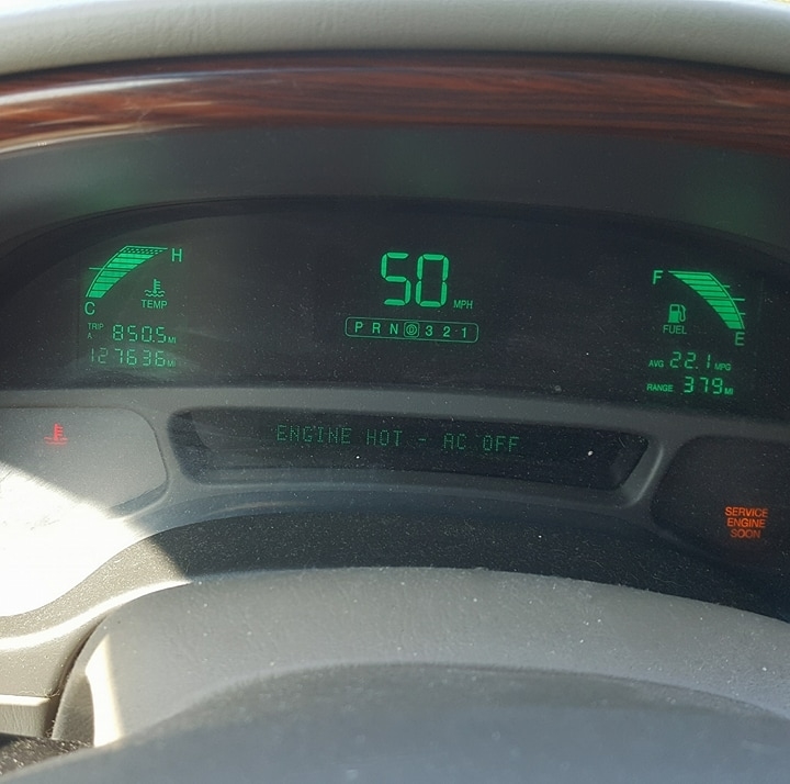

I am attaching an image from when it overheated to demonstrate the bar level. Currently it has been indicating 1 to bars above the middle line (into the more faded bar area) on the gauge during hot weather and expressway acceleration. Until the overheating issues it never went above that line.
Tuesday, September 26th, 2017 AT 2:37 PM
JMCMIC01
  • 13 POSTS
Sorry, I only meant to upload it once
Tuesday, September 26th, 2017 AT 2:38 PM
KEN L
  • MASTER CERTIFIED MECHANIC
  • 55,469 POSTS
Thanks for the upload, a couple things come to mind, first if they installed the thermostat backwards it will cause the engine to over heat which looks like what is happening.

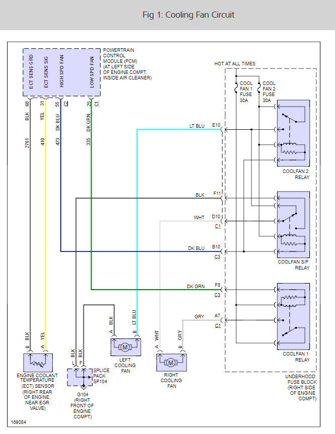

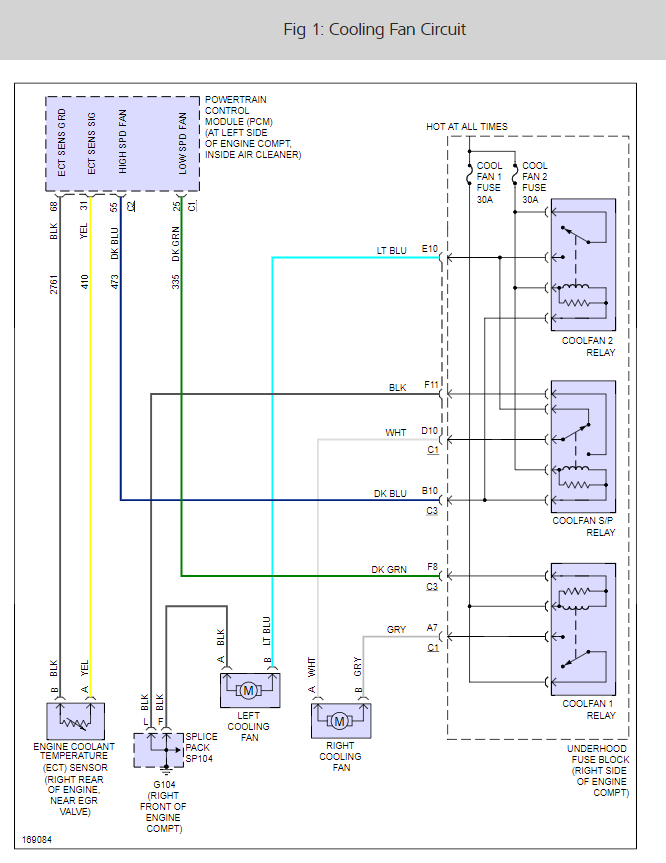

I haven't done the fan check yet and I know that they have been diagnosed as kicking on when needed. My uncle is wondering if perhaps they are not kicking on consistently and questions whether or not the connections are solid but says they are difficult to get to. Any suggestions on checking those connections?
Saturday, October 21st, 2017 AT 4:07 PM
KEN L
  • 55,469 POSTS
A bad connection or relay can cause the cooling fans to work only sometimes.
Here is a guide and some wiring diagrams to help us test the system.
