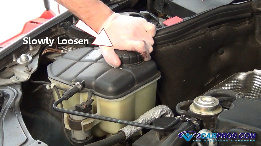

1. Release the Cooling System Pressure
Locate and slowly remove the cooling system pressure cap to relieve the system of any residual pressure. You will then need to drain the cooling system because the sensor is submerged in coolant and when it is removed coolant will leak from the coolant port.
slowly loosen radiator cap
