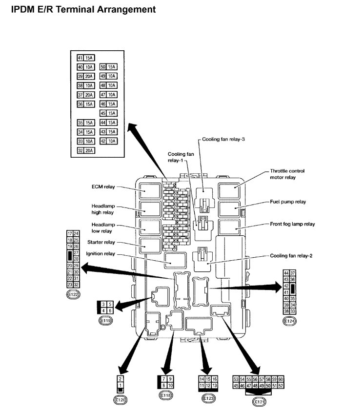

Where is the fuel pump relay located?
Saturday, September 28th, 2019 AT 9:47 AM
KEN L
  • MASTER CERTIFIED MECHANIC
  • 55,522 POSTS
The fuel pump relay is under the hood in the IPDM. here is a guide to help test it with the location of the relay int he diagrams below:
Check out the diagrams (below). Please let us know what you find.
Sunday, September 29th, 2019 AT 10:18 AM
