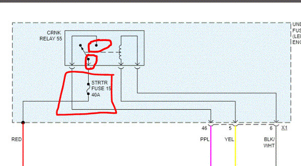

I pulled the motor to replace a torque seal and now after putting it back together it won't start. All windows, door locks, headlights, radio and etc, works. Checked all fuses and replaced one that was blown.

I have fuel pressure, but I have no power on the purple wire to the starter. I have checked even switched the relay still no power to the wire. I have added extra ground wire to the motor just to make sure I had one.

Okay, that is the s terminal wire on the starter. Can you tell me if this has a 3.4L or 3.6L engine? I am presently looking at info for a 3.4L because it was most common. However, I need to know if it is the larger engine.

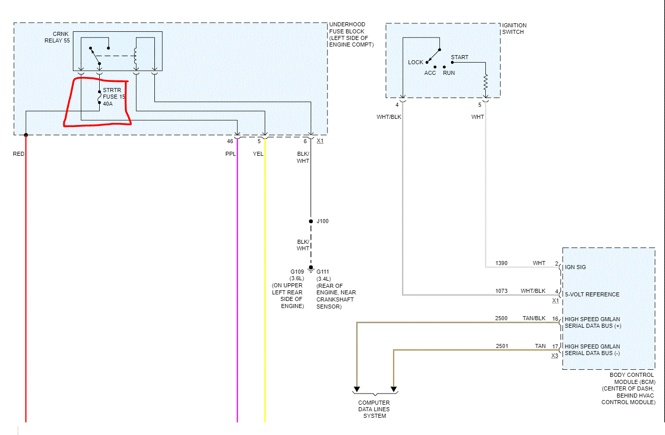

Now, power to the starter relay is provided via fuse 15 (40 amp) in the under hood fuse/relay box. (see pic 1) I need you to check not only the fuse condition, but also confirm there is power available to the fuse.

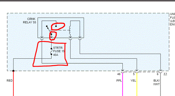

Okay, what if you jump power between the two pins indicated in the attached pic? Does the starter engage?

I did once and it pop the starter fuse it cranked before it popped the fuse figured it popped the fuse when I pulled the wire jumper out.

Then there is a short between the relay and the starter or the starter is bad. Have you removed the starter and had it checked? Most parts stores will bench test it for you free of charge. Also, follow the purple wire and make sure it isn't damaged at some point and making contact with ground. Since the starter did engage, I have a feeling it is the problem.
When you pulled the jumper wire, the only way it would have caused the fuse to blow is if you shorted one end to ground while it was still connected in the box.

If you are referring to the stability control, no. That won't prevent it from running. I want you to try something. Disconnect and insulate the purple wire from the starter and then try to jump it at the relay. See it if still blows the fuse. If it doesn't, then we know it's in the starter. If it still does, that purple wire is shorted at some point. It is really easy to pinch a wire between components when you pull the engine. You've done a lot of work. I have a feeling that is what happened.
