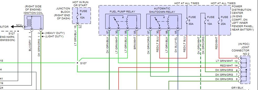

Check fuse no.9 10 amp in junction block right end of dash and fuse no. 6 30 amp in the PDC if both okay and the ASD tested good-there's a problem with the computer ASD relay ground control circuit
Dec 13, 2020 at 10:00 AM (Merged)
98_DODGE_RAM_SPORT
I jumped 87 to 30 and got 12 volts to the coil however still no spark. The fuel pump also did not prime. I bypassed the fuel pump relay for constant fuel however still nothing. There is plenty of pressure at the rail.

One volt isn't enough, have to backtrack circuit. Check voltage to and from asd relay. Check fuse and voltage to fuse circuit, fuse 6--30 amp, fuse 9--10 amp. One fuse circuit is hot all the time, the other goes hot with the key on.

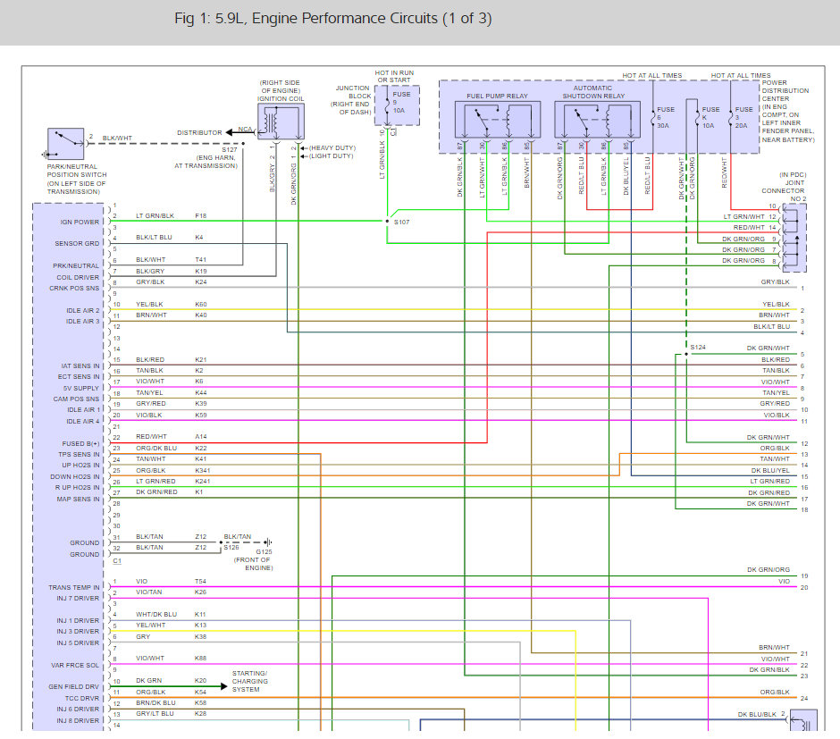

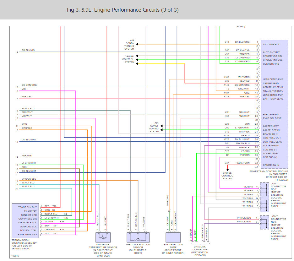

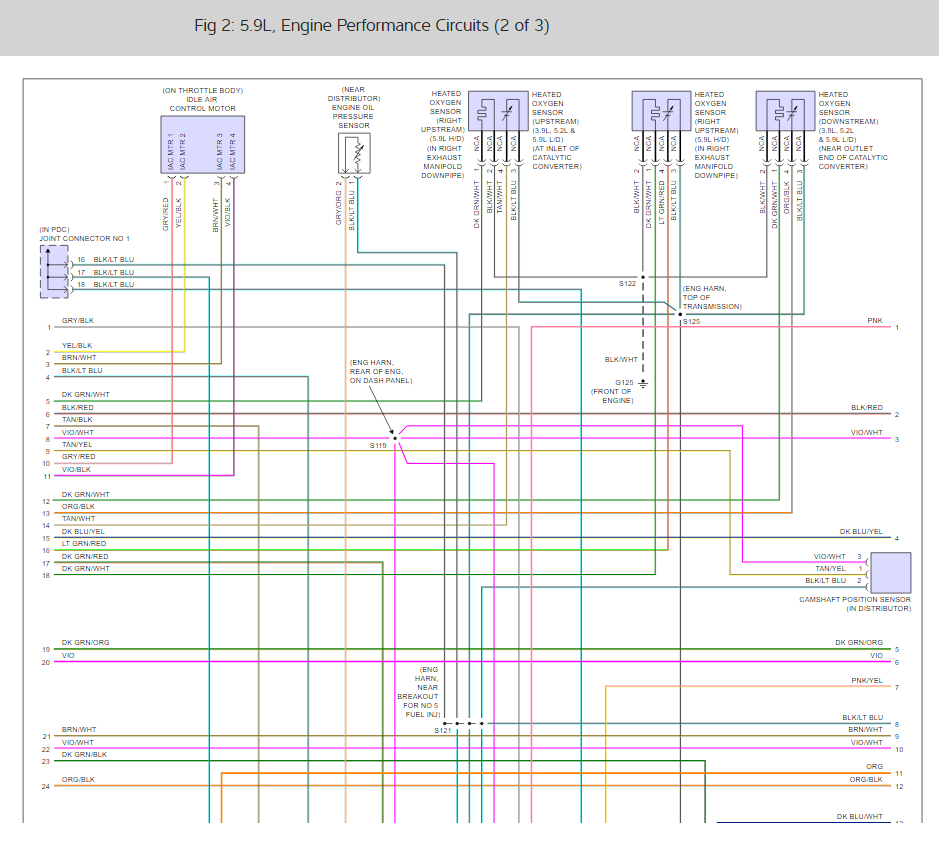

So I checked all the pins at the powertrain control module connectors. A2 has power but no ground.a31 no power but has ground. A4 no power but has ground.a32 no power but has ground.a22 has power but no ground.c11 no power but has ground.
Dec 13, 2020 at 10:01 AM (Merged)
JDL
  • CAR REPAIR CONTRIBUTOR
  • 16,098 POSTS

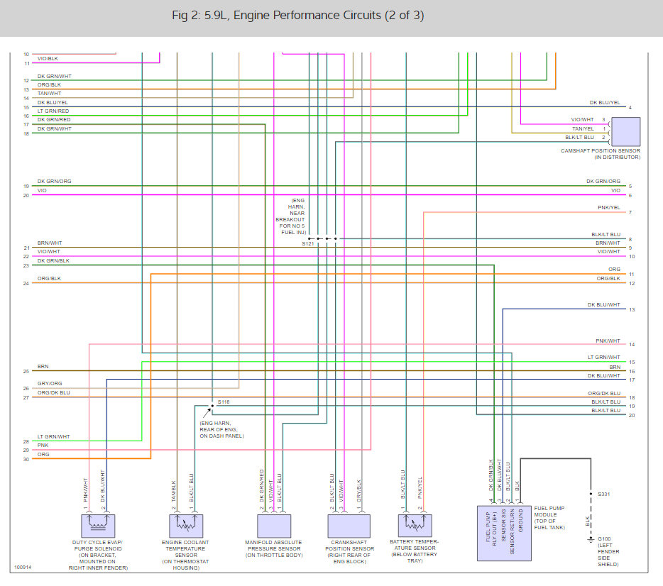

Our wiring diagrams show c1 and c2 connectors, but, using c instead of a, everything you posted about those terminals appear to be correct.
When you first turn the key on, no crank, the computer will ground the asd relay for a couple seconds, then no ground without cam and crank sensor signal.

To get you started, it sounds like you're seeing proper operation but you aren't aware of it. When you turn the ignition switch to "run", the Engine Computer turns the automatic shutdown, (ASD) relay on for one second, then it goes back off. That is done to insure fuel pressure is up for starting, in case it bled down over days or weeks. That relay gets turned on again during engine rotation, (cranking or running), and the computer knows that by the signal pulses it receives from the crankshaft position sensor and the camshaft position sensor.
On models that use a separate fuel pump relay, that relay is turned on either by the ASD relay directly, or the coils for the two relays are in parallel so both are turned on by the computer, at the same time.
The air gap for the crankshaft position sensor is critical, and since the transmission was separated from the engine, if that sensor wasn't removed first, there's a good chance it got damaged or pushed up a little. That sensor on older engines was adjusted by a thick paper spacer glued to the end to set the air gap. Your design is set automatically by the mounting bracket so it can't be misadjusted, but it can be damaged.
You've already observed you're missing spark and fuel pump. Most people get hung up on the first one of those they find missing, then waste all their time in the wrong circuit. You can try reading the diagnostic fault codes first, but be aware fault codes for these two sensors often don't set just from cranking the engine. They usually need more time to be detected, as in when a stalled engine is coasting to a stop. For that reason, be sure to not disconnect the battery or let it run dead until the codes have been read, because doing so will erase them, then that valuable information will be lost.
To read the codes yourself, cycle the ignition switch from "off" to "run" three times within five seconds, without cranking the engine, leave it in "run", then watch the code numbers appear in the odometer display. You can go here:
https://www.2carpros.com/trouble_codes/obd2
to see the definitions, or I can interpret them for you.
If there are no fault codes related to these sensors, start by checking if the ASD relay is turning on. The easiest way to do that is to use a test light and back-probe the dark green / orange wire at any injector, the ignition coil or coil pack, or either smaller terminal on the back of the alternator. In the rare event I told you the wrong wire color, it is the wire that is the same color at all of those places. A test light works best because it is easy to see from inside the truck, and digital voltmeters usually don't respond fast enough.
You should see the test light turn on for one second when you turn on the ignition switch. If you do, that proves the relay and its circuit are okay, and the computer has control of it. It's very rare to find this part doesn't work. What's important is if the 12 volts comes back when you start cranking the engine. If it does not, it is because the signal is missing from one of the two sensors.

JDL
  • 16,098 POSTS
With engine cranking, the ground for the asd relay should be constant. The ground is controlled by the computer.
When you said the coil had decent voltage for a couple seconds and then went very low, makes me think, the computer stopped grounding the asd relay for some reason.
