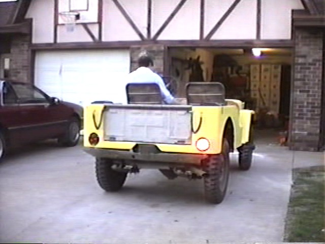

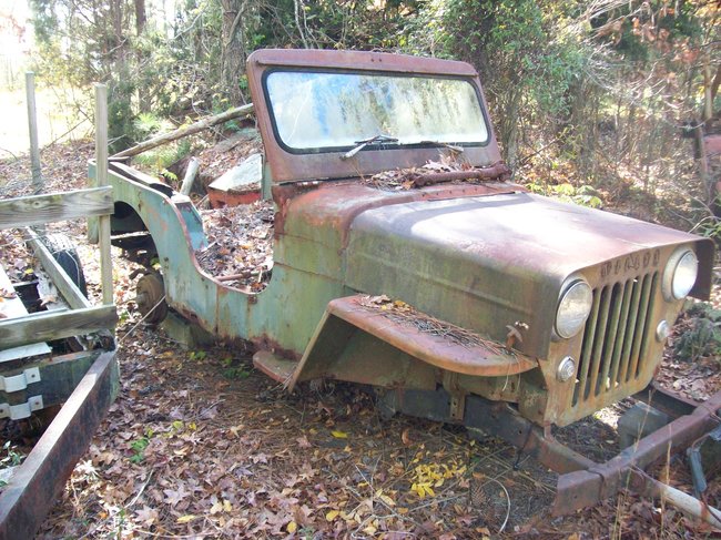

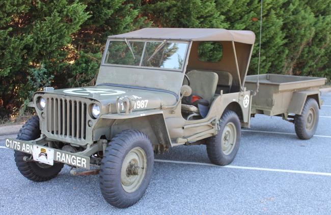

Actually he ("willy") is a 1946 cj-2a, willys jeep made just after the war. In the 1st pic (if you can see it), he's like the one 3rd row down, forth to the right.
I really wanted a "mb" (2nd row, forth to the right, but back in 1991 there was no internet. All the mbs I came across were incomplete or crap, none even close to running, however, the owners considered them gold, the lowest priced one was $750, junk! I had limited fundage and no time to travel to find what I wanted.

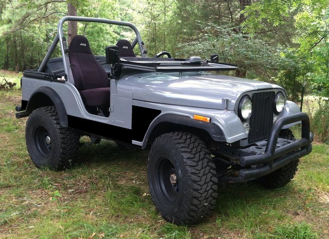

I got my '77 cj-5 in 1991 also. He ("mr. Jeep") was in excellent shape, he cost me $2200, he's my 6th cj-5, never had anything else! Now that i'm older and more responsible (and still broke) "mr. Jeep" has lasted the longest
(i started out with nuthin' and I still have most of it left)

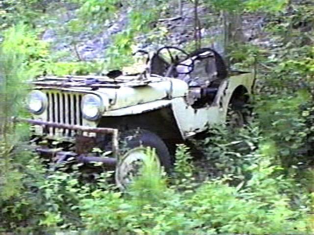

Along my quest I came across "willy", willy was complete (less one brake drum), the body was shot (a 55 gallon drum of bondo held what was left together, the body was not a keeper)
1946-1948 cj-2as were a really close enough relative to the '41-'45 mb for me, so I jumped on this one. I gave the man a whopping $100, he signed over the original title, and I loaded him on my buddy's trailer.
Here's the kicker!
They all laughed as I unloaded him (family, and neighbors) and my buddy shoved him into the one car garage of the duplex I rented with his push bar.

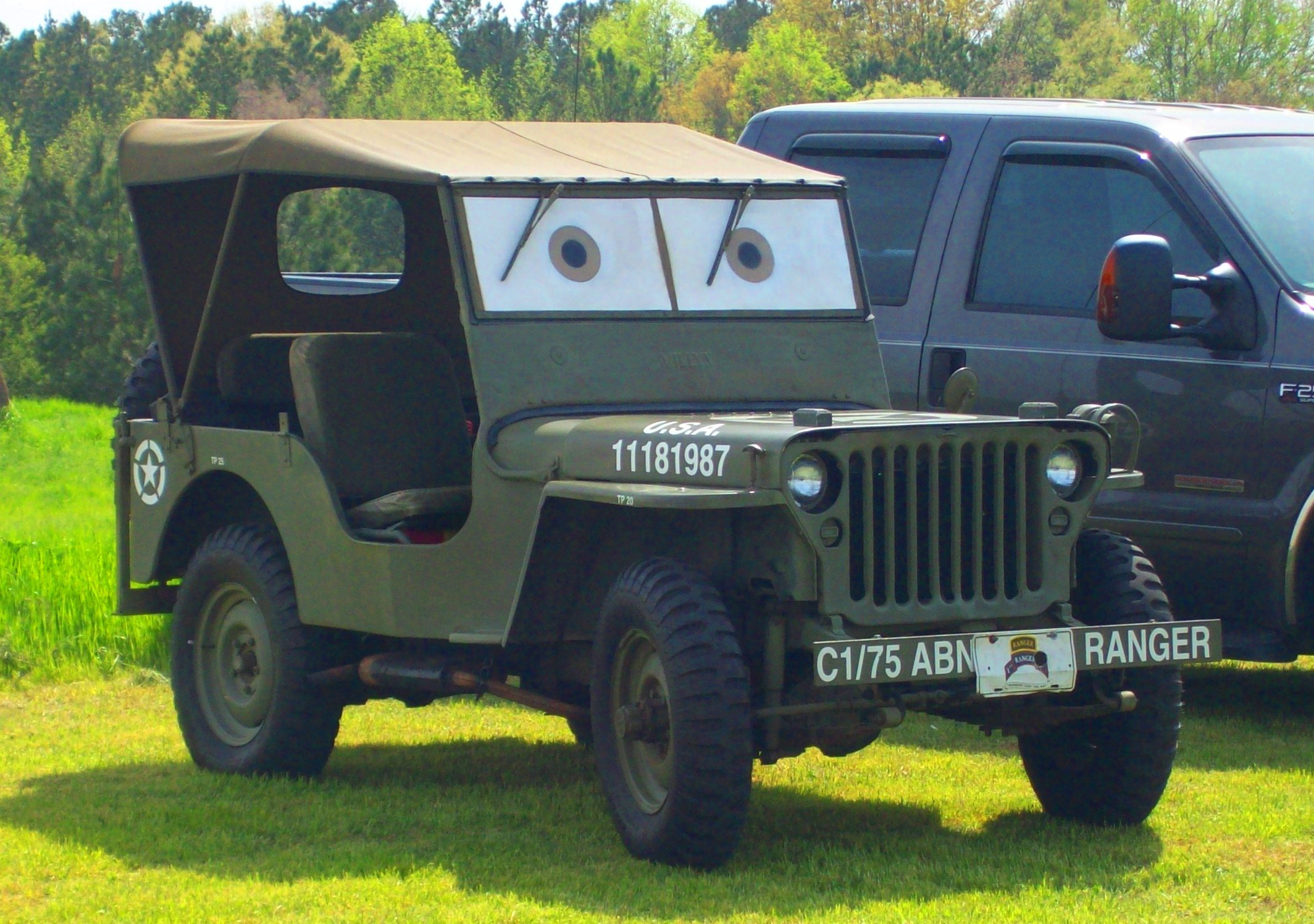

Two years later, he rolled out looking real close to a "mb", I am still making improvements to make him get closer. The numbers on the hood is my daughter's birth date. She learned how to drive him well by age 10, took her driver's test in him too! (Yep, with no seat belts, and she hand cranked him, instead of using the starter)
He's not perfect, he'll get called out as an imposter by those who know their jeeps, but for the most part, he'll fool the majority.
Although there are many subtle differences, a quick way to tell a wwii mb from a korean war m-38 is the shovel and ax is on the drivers side of a mb, and on the passenger side of a m-38. Notice where I did the body work to make my shovel and ax fit!

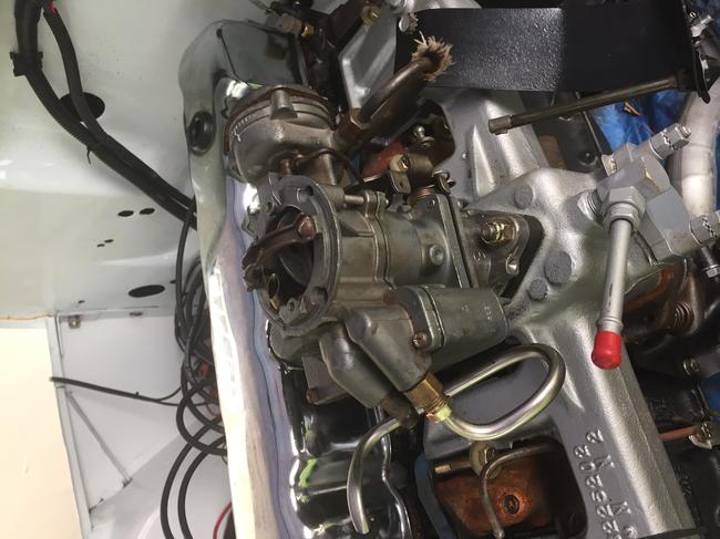

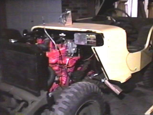

Whats the carb history on yours, so we can diagnose or make suggestions?

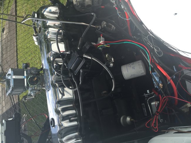

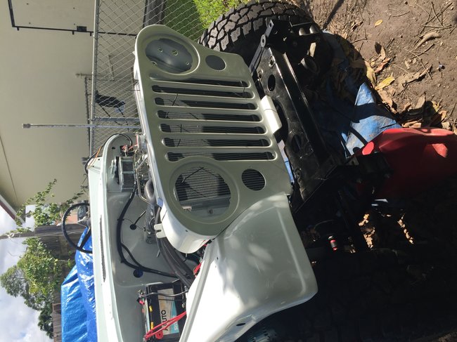

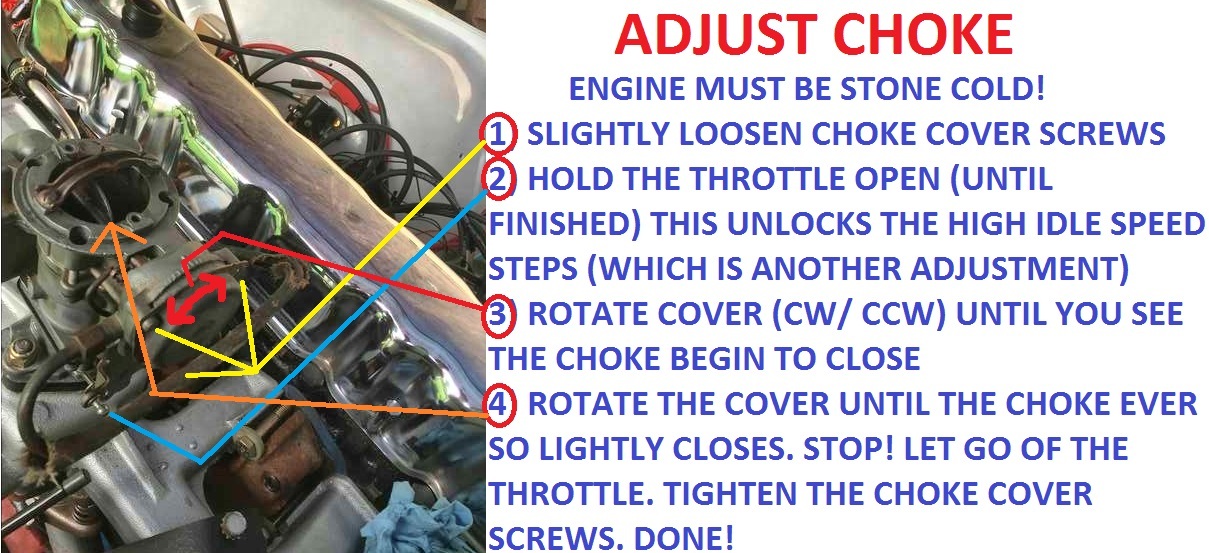

Update: today I took one of our Acura Tech to the house so could take a look at the CJ. I work for an Acura deal in south Florida. He went over everything I have Timing, Spark, Fuel Delivery, TDC. All of it the only thing he came up with was the battery I have is not enough cranking to get the jeep started. So I'm getting a Extra battery to see what happens. He did want me to ask you a Q. When we take the Carb off the intake Man looking down the port there's a small amount of fuel there, is that common? Let me know what you think thanks.

Hello there. Will haven't had much time to work on the CJ, I did have to put in a new starter. One Q. I do have I took the carter 1bb yf off the manifold and look down in the port and found a puddle of fuel. Soaked it Up with a a shop towel, I guess the Q is that normal? Let me know thank you.
Saturday, July 13th, 2019 AT 11:46 AM (Merged)
CJ MEDEVAC
  • 11,004 POSTS
Usually the intake sucks/ vaporizes any fuel in the intake while the engine is running, so it's dry when you shut the engine off
If it has not run, you have been actuating the pedal/ throttle. Each time the accelerator pump has moved up and down and squirted a stream of fuel down the carbs throat.
So, however many times you throttled it you have puddled fuel in the intake.
Holding the pedal to the floor and cranking the engine will "un"-flood the engine, as fuel is sucked on thru
Usually, when I wanna try to start a stubborn engine/ or diagnose one quickly (like, does it have spark without testing, a splash of fuel is fast and ez) i'd guess that i'm putting in no more than about 2 teaspoons of fuel
Still no start?

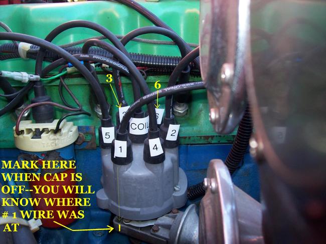

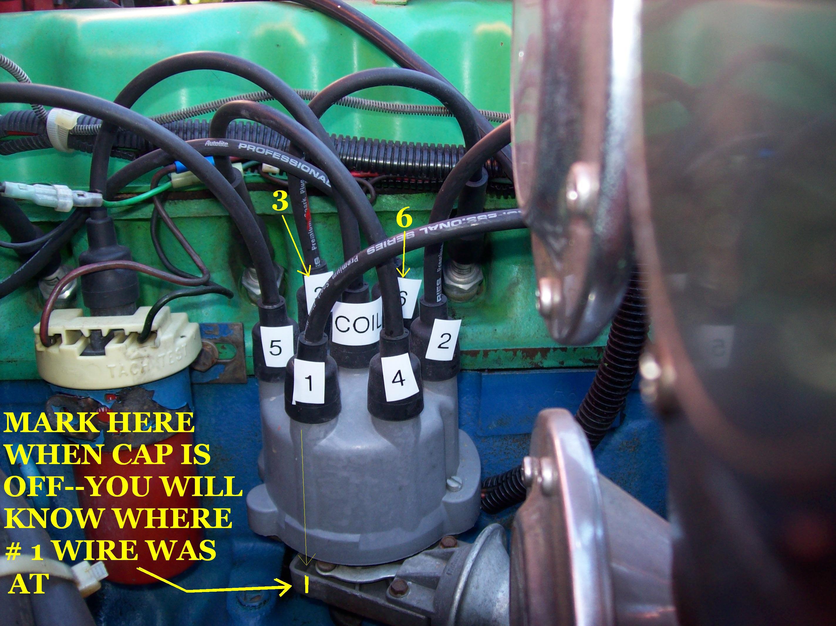

Loosen the distributor a little and slowly move it both ways while it is being cranked. Does it start or at least sound more like it wants to in the different position?
Is your firing order clockwise?
(my motorcraft below, clockwise rotation like a prestolite)

Yea we're going to take another run at it tomorrow, now that I have a good starter battery fully charged and a have an assistant to help me crank it tomorrow. I think tomorrow is the day. Yea it does seem to want to start I'm going to make small moves with the distributor as my friend cranks i, will see and I'll let you know thanks.

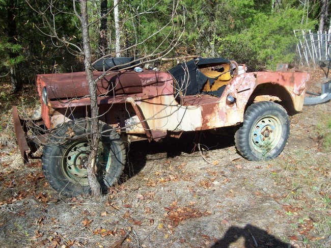

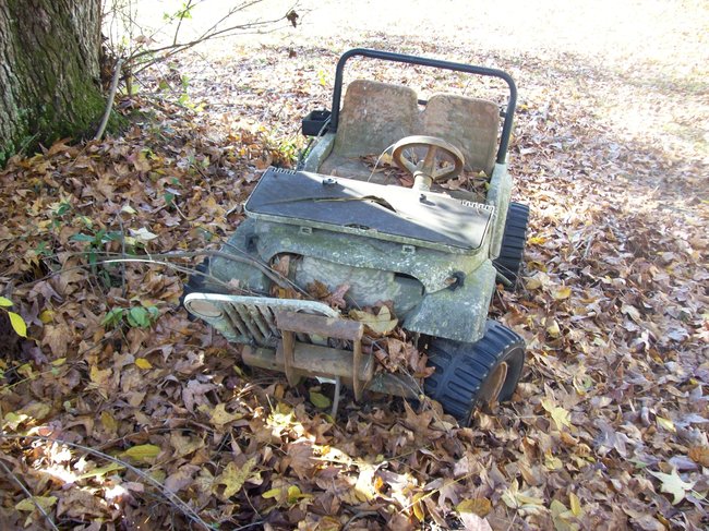

That cj has been off of the road too long!
Don't let it wind up like these "we" keep at my buddy's place

Hello there I'm so sorry for the long delay. But I have great news "it's alive"! I bought a 2BB Webber still would not start, I got the carb in late Dec. Is I read more about the prestolite sys the more bad reviews, as a last hail Mary I ordered a HEI then one early Tuesday morning I installed it and Walla on the first turn it ran awesomely! I'm sending you a vid hopefully you'll see it. But I do want say thank you for all your advice I did learn a thing or to thank you.
