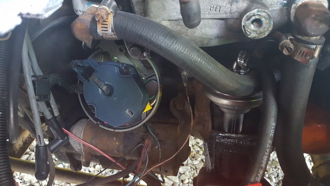

Have you checked to see if the distributor shaft is rotating? Taken any voltage readings?
what is the voltage to the positive side of the coil??

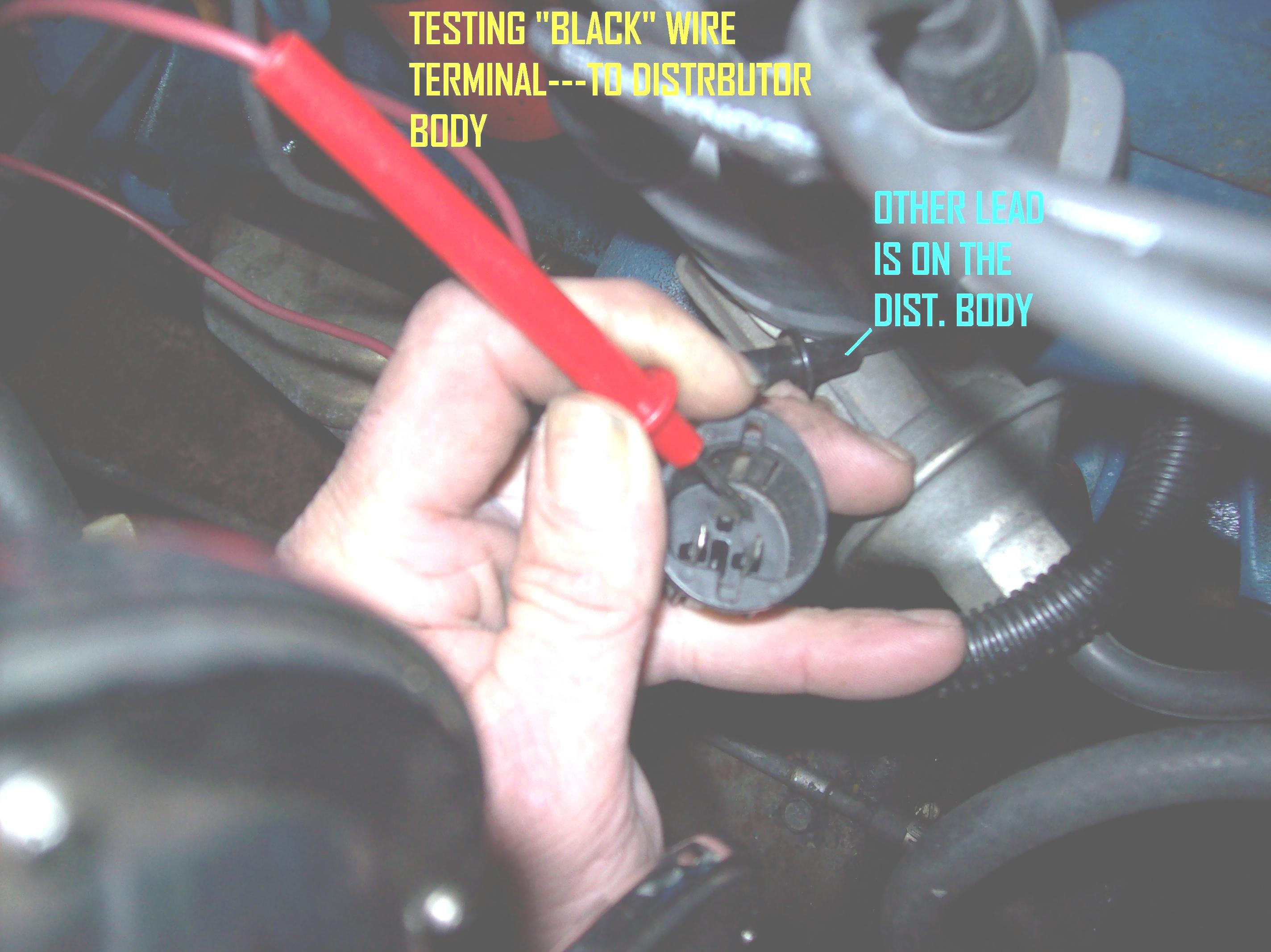

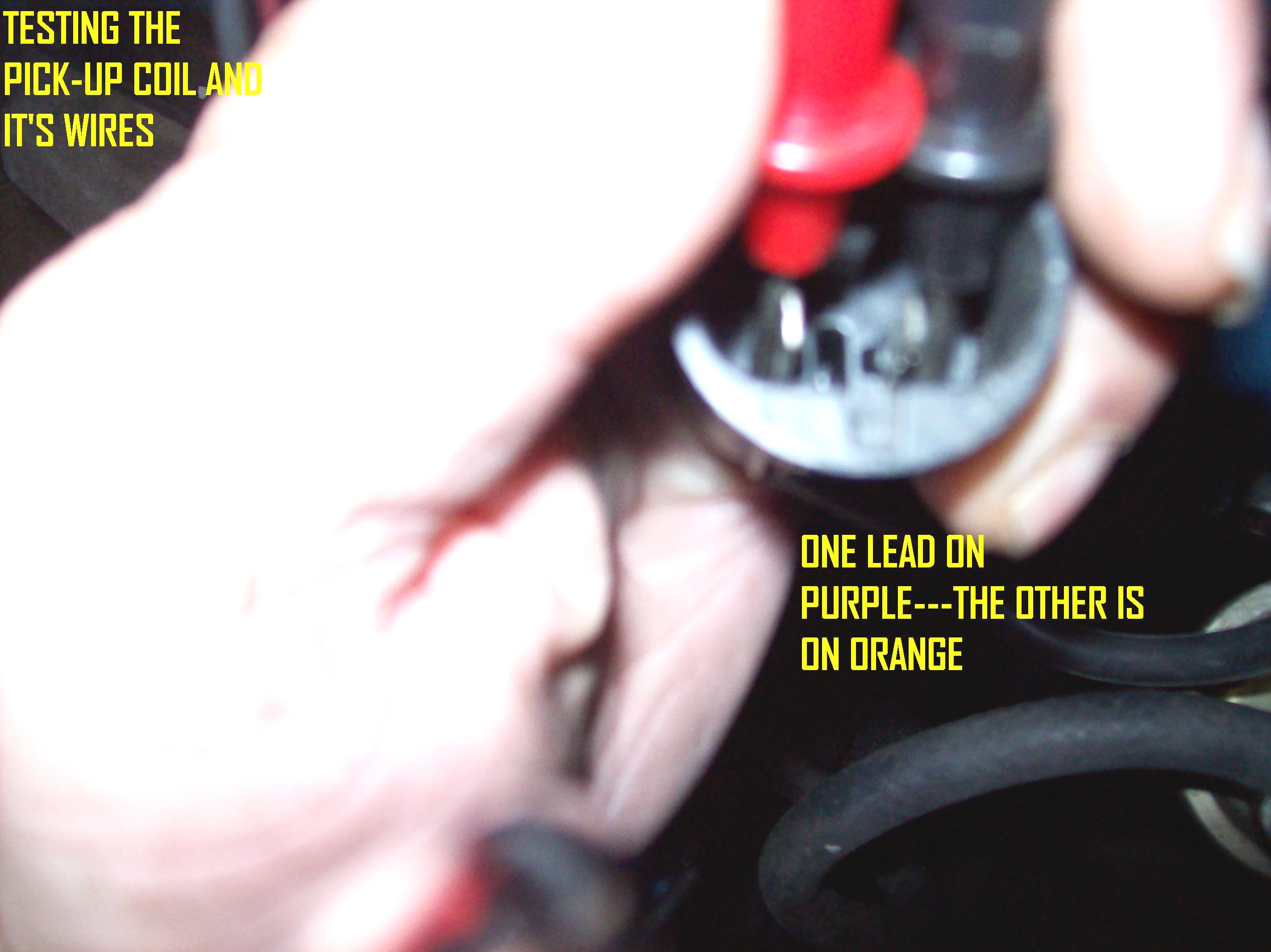

sorry i took so long - work/ uncle died/ daughter's birthday/ etc. just got in. mr. jeep's rear pinion seal has sprung a leak, looks like they'd last more than 38 years (at this pace, i'll never get time to replace it)
prestolite was a very crappily designed system

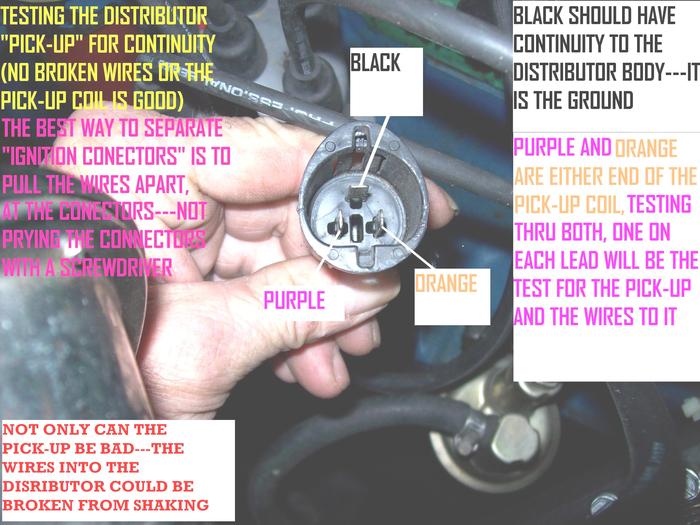

the wires entering the distributor are basically solid copper telephone wires (like about the size of what plugs into your house phone's body)
if this is not anchored well, it will shake around and break the wire(s)
i've seen this many times, especially w/ 6 cylinders, wires sorta just dangle, a 304 ain't as bad, the wires lay on the intake

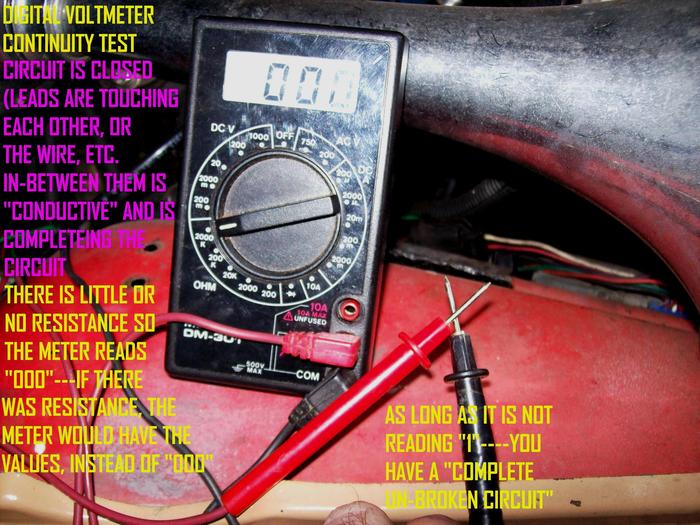

if you disconnect the plug, you can run a continuity test thru it to see if the wires complete the circuit
i upgraded to a motorcraft system (which was standard in '79 on up cjs)

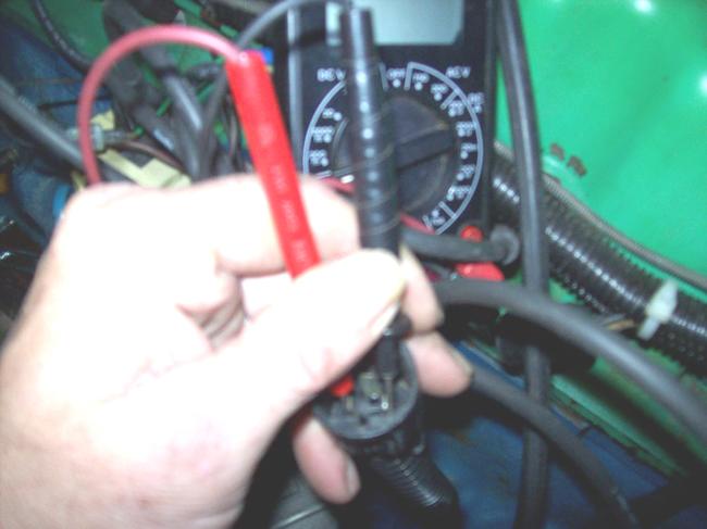

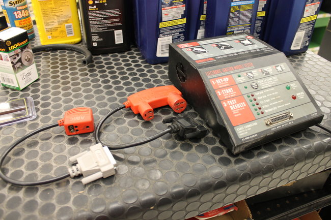

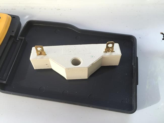

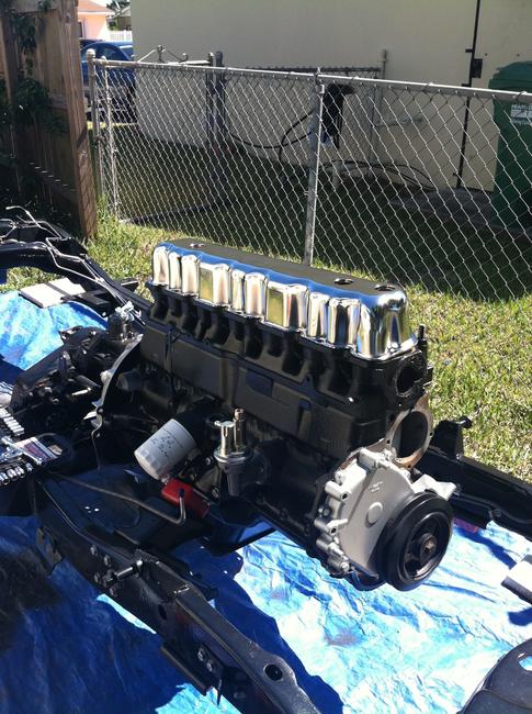

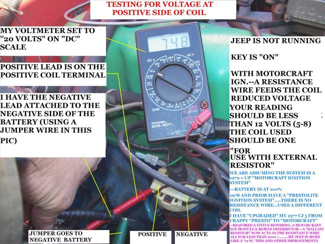

pic 1) this is my motorcraft distributor, it has 3 stranded wires into the distributor. test your 2 pins like i show for continuity (lost? i can explain that too)

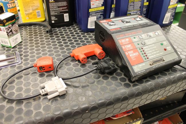

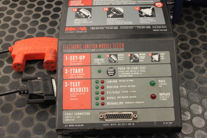

pic 2) you can have your ign module tested at a parts store, this happens to be advance auto parts' machine. i laid out 2 pigtails for this pic, the one next to the machine is to test a motorcraft module, the one to the left is for prestolite. run the test at least 5 time in a row, to insure the module is good, do the same for a new one, should it be needed, before you leave the store.

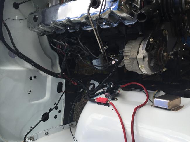

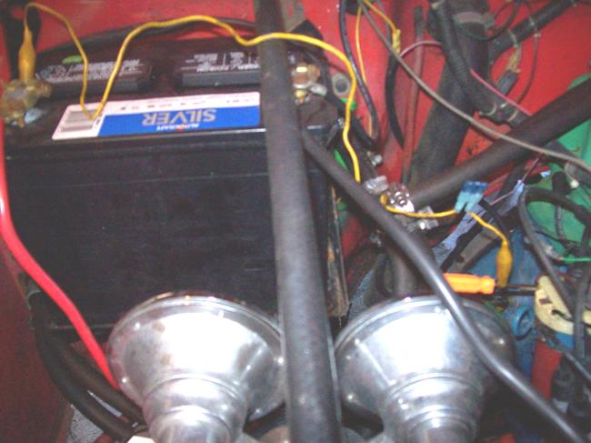

pic 3) key on, what do you have at the positive side of the coil?
if this ain't cutting it, i'll run you thru installation of the distributor again.
should you want to upgrade later to motorcraft, i can talk you thru it. as far as all of this "high speed" and "high dollar" ignition stuff, i have not seen any advantage over stock stuff and "regular jeepin", that stuff may do something special if you are racing.

Yes it is rotating like it should. I am getting a little over 12 volts when the key is on.

10.5 volts is what i believe i tested. i just had spark out of the distributor again for a few cranks, then gone. i don't get it.

If your distributor was not installed correctly
We can get into that later---i have lots of pics---and can give you some good ole rural route explaining
We'll even go into making sure your firing order is correct as well as checking your distributor pick up

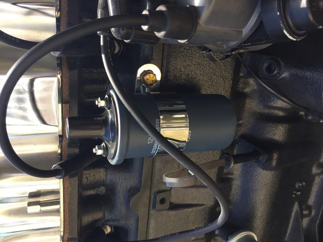

I want to know what kind of non-stock modifications have been done to the ignition system?
........and the whole jeep?
Is your coil new?---where'd it come from?--part number?-----does it say "for external resistor" on it??????

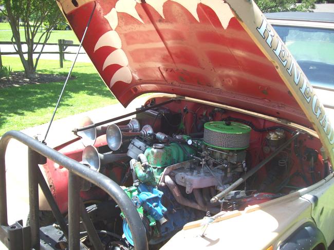

Need to know ..................what engine you have???
Pics are nice to see what we are working on!
I'll hang with you till your jeep is like new again!
Keep responding here

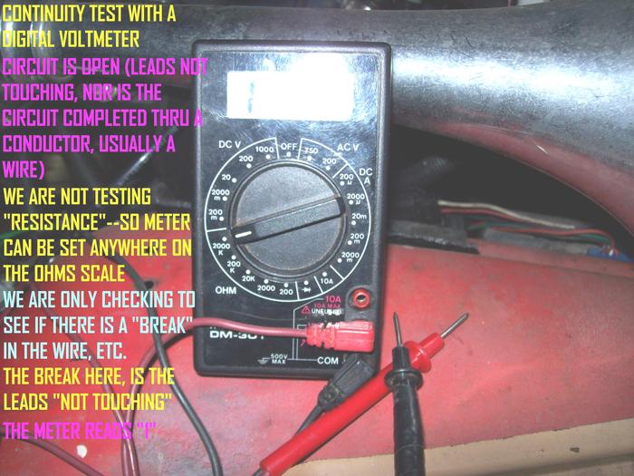

I want you to test the distributor with continuity
Grab the wires on either side of the connector---pull (not jerk)---the connector should come apart (digging at it with a screwdriver usually won't do it)

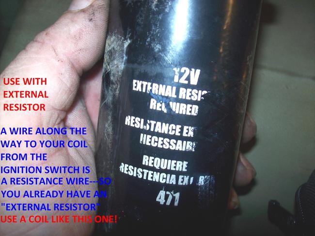

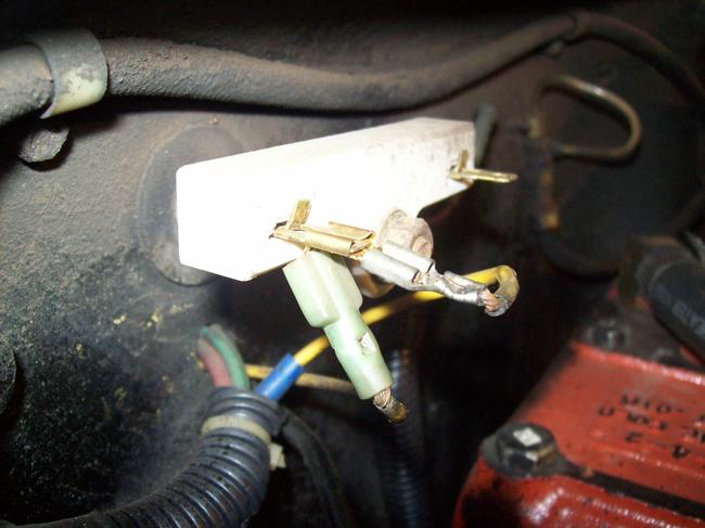

They seem to have had many spools of red wire to use up when they built your vehicle! To start with, check for 12 volts on the ignition coil's positive terminal, then see what you have for voltage on the negative terminal. If the 12 volts is missing, I will try to follow the diagram back to the source.

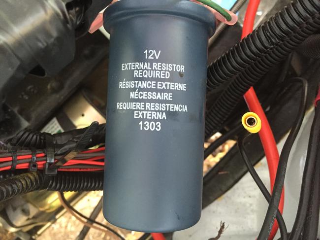

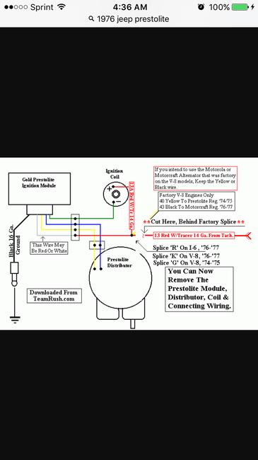

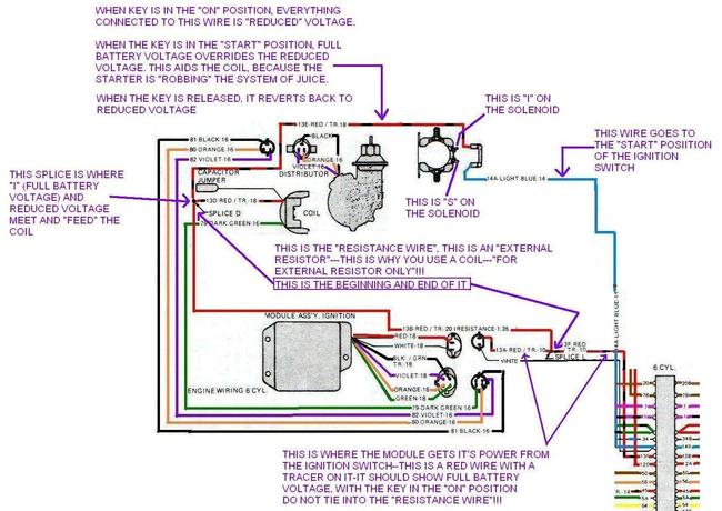

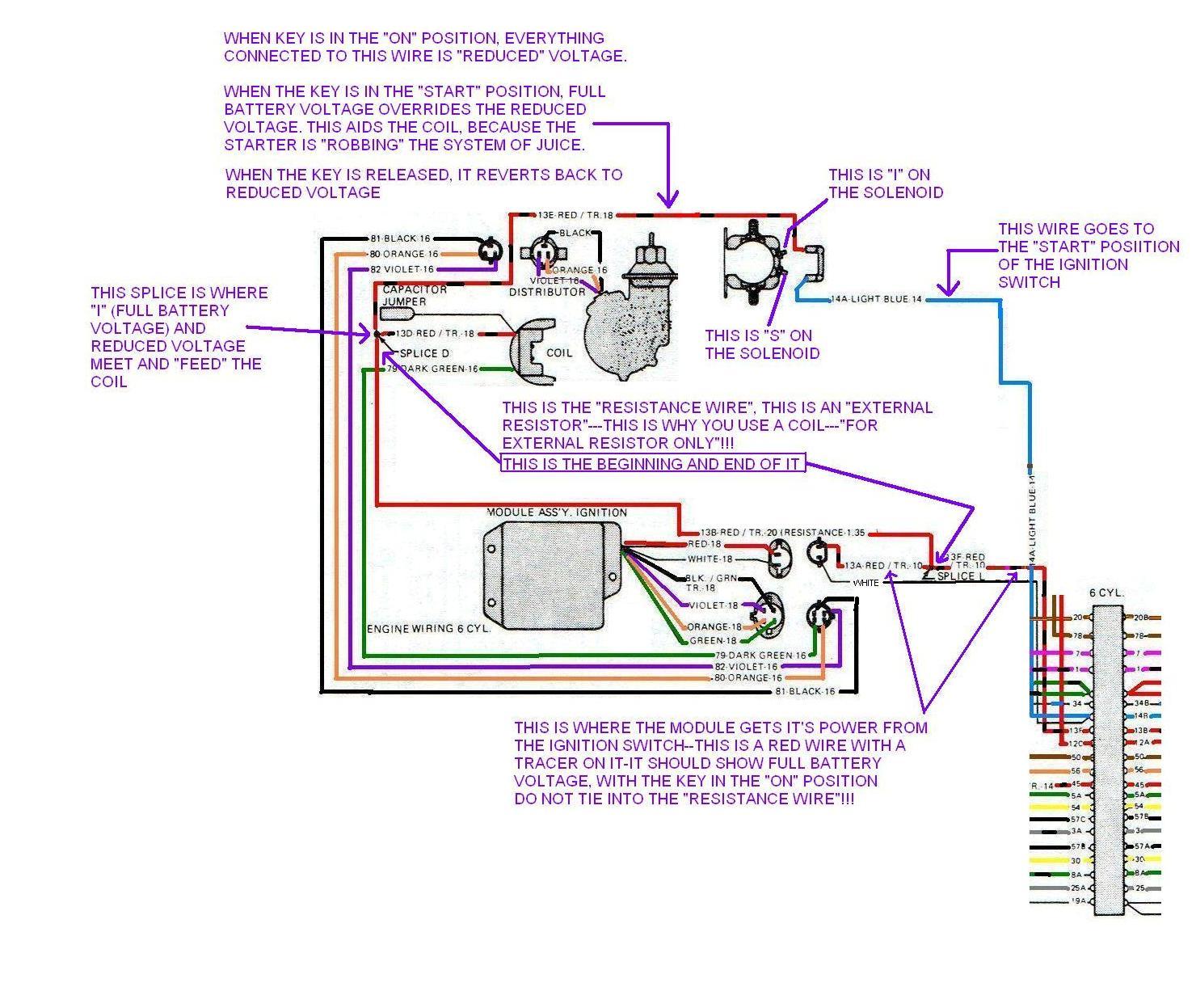

The wiring kit you got, is it specifically for a '76 or does it include years above that, like a '79?
The reason i'm asking is
#1 if you had sent back a value on the positive side of the coil, we might know if it is a resistor wire or not (previous pic i sent)
In '79, they went with the motorcraft sysyem, the wire from (basically the ign switch ) is a resistance wire. '76-'78 just had a regular wire. The coils for either system are different. Maybe you have double the resistance than you should have, if the "resistance wire" is in your new harness.

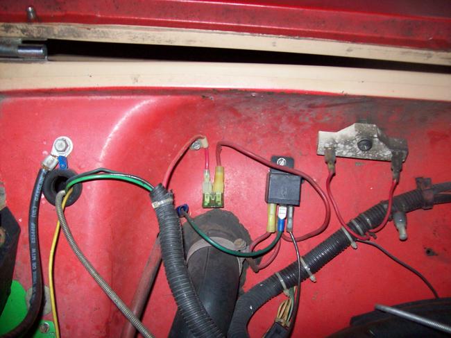

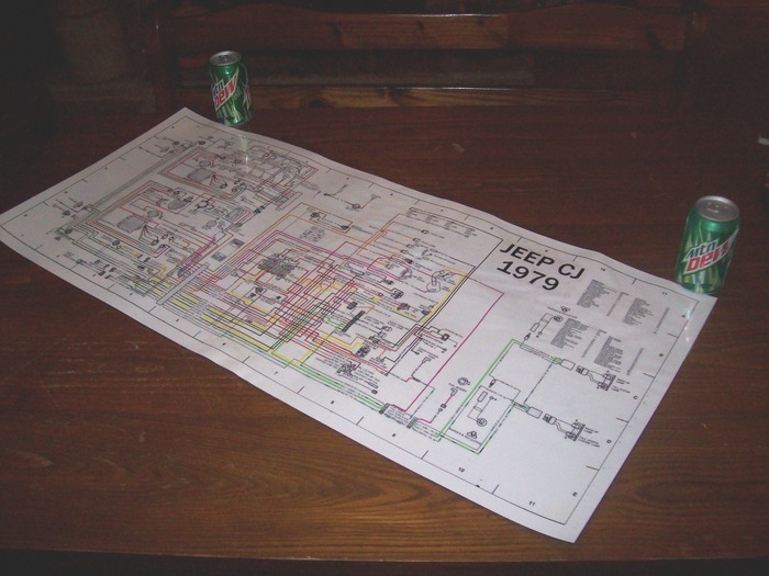

Pic 1) below is an excerpt from a '79
Pic 2) '79 and up coil

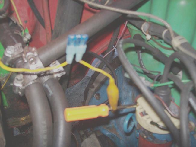

Pics 3 and 4) try this as a test. Positive battery post to positive coil. This would sorta bypass any resistance.
P.s, got mr. Rear pinion seal in about an hour ago! I'm good as new again!
The medic

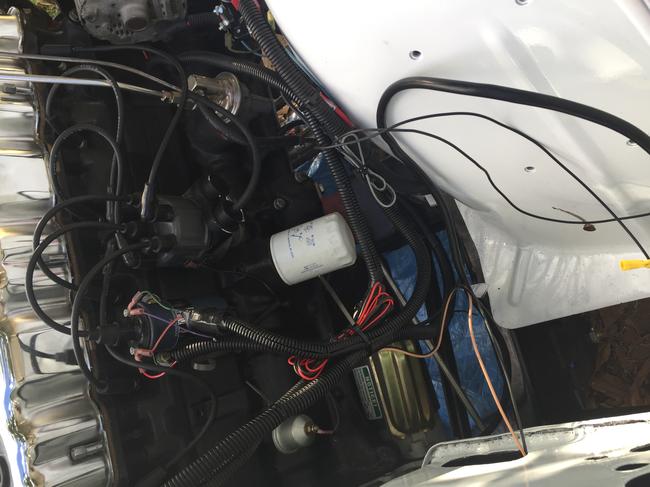

Maybe review the distributor installation?
https://www.2carpros.com/questions/1978-jeep-cj5-engine-wont-start/page/5
How about that module? Read this;
https://www.2carpros.com/questions/1981-lincoln-mark-vi-would-car-run-fine-idol-park-stop-key-turned-off
On to the coil, check out this link.
https://www.2carpros.com/questions/84-jeep-cj7-cranks-but-wont-run/page/3

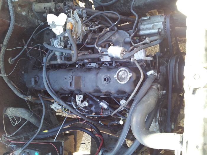

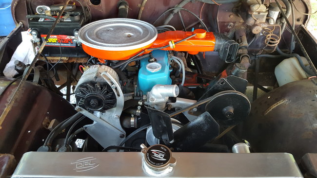

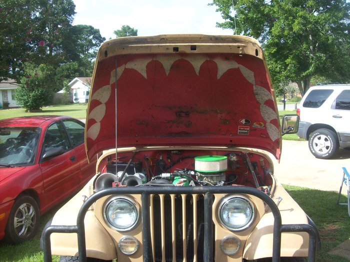

Is this mostly the OEM or have your changed things.

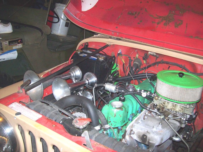

Send left/right over head pictures of your engine compartment.

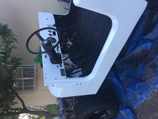

Wont let me upload multiple pics from my phone

The text on that coil pic was meant for a '79 on up jeep guy!

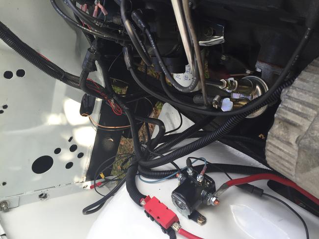

It is all original replacement parts nothing performance. I am just trying to get it to run.
Jul 13, 2019 at 11:45 AM
(Merged)

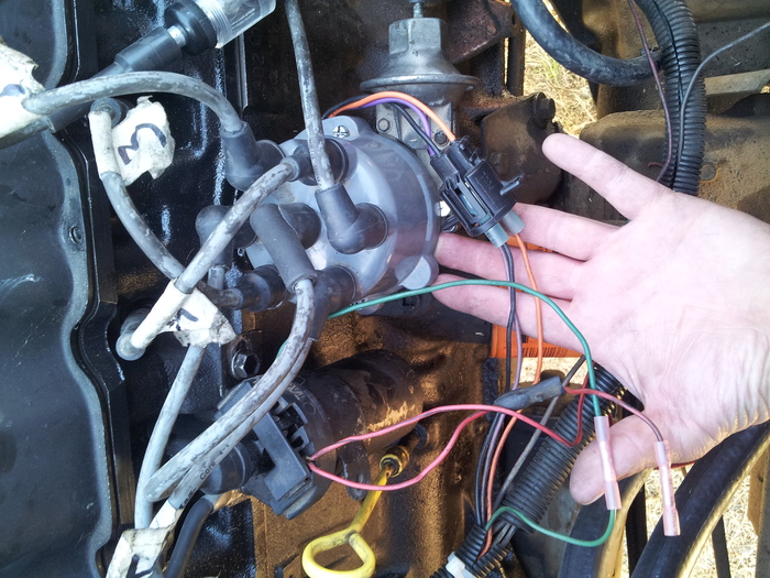

the problem was prior to that mess of wires coming from the distributor. those happened while trying to fix this firing problem. broke the connector to the distributor and broke a wire of of the coil connecter. replaced the connector to the coil with s factory one

What's all of the splicing at the 'stributor?

Voltage at the pos side of the coil w/ key on?
Continuity test thru the distributor connector?
Did you try a jumper from pos battery to positive coil?

Pickup in dist. Tested good.......that's good!

Ok it's Wednesday here's the latest. Bought a new set of plug wires Bingo I have spark to all the plugs????. Now it did attempt to start I poured fuel in to the Carb to prime it up. I'll get working on the fuel delivery tomorrow and let you know how it gos. Thanks

I gotta send you away
I need answers to my questions (like advance auto).....i know you do too...bear with me!
Remove your ignition module
The correct connector is laying beside it.........'cause i put it there myself!
Test this puppy 5 to 7 times
If it fails onceyou need another one
When you get the new one........by gosh test it too!!!!
I really tore thru my wiring for 2 days, when it still would not fire up.................i only cried when no one was looking................... A friend suggested that i go back and test my new............bad.........module!
The module you get should have "blue" plastic where the wires come outother colors are for other applications
Since i don't know where you are----here's part of the '79 wire diagram that i scanned, painstakingly colored in microsoft paint, blew up, and laminated for my garage wall if it's too late to go to the parts store--you can look it over
As far as saving on parts......this is how to do it at advance auto parts online---pay online---pick up at store.............."a124" worked today.........see my answer in this link
https://www.2carpros.com/questions/1998-chevrolet-cavalier-there-constant-drain-on-battery-about-300-ma-now-after/page/5
That'll knock off $10 on an ign module

Now
This would be the oe coil for prestolite, it does not need external resistance (also has a lifetime warranty)
Http://shop.advanceautoparts.com/p/carquest-by-bwd-ignition-coil-e30p/5240212-p?navigationpath=l1*14923%7cl2*15034%7cl3*16064
They have another one for $18 (1 year warranty)
The one in your pic does require the ballast resistor to be installed, (this would also be what you need if you switch over to motorcraft)
Pic 1) is of my ballast resistor (should it ever burn out) you can "get by" temporarily to get you home, by connecting the wires together, bypassing the ballast resistor)
pic 2) i used a piggy back, this way nuthin' gets cut and is reusable, should i need to connect the wires together
Once you get the ballast resistor on and everything hooked up, turn the key on and tell me what the voltage is on the positive side of the coil.

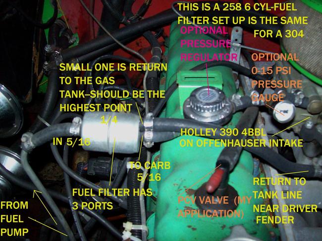

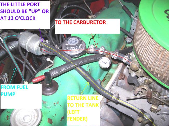

Pic 3 and 4) this is the correct way that the fuel lines connect, i have replaced my steel lines with new ones, except i used a tubing bender to "tidy up" the looks, the originals sort went over and under stuff they just made things look crappy.
The mini pressure gauge and regulator are not necessary, but are useful so you can see the actual pressure, it does pulsate as the fuel pump pumps. They're also a good conversation piece
Your fuel pump will fill the carb bowl pretty darn quick if you feed the carb maybe 2 teaspoons of gas down the carb throat moments before you attempt to start your jeep (dumping some down now is not gonna do nuthin' 'cept evaporate)
The medic
