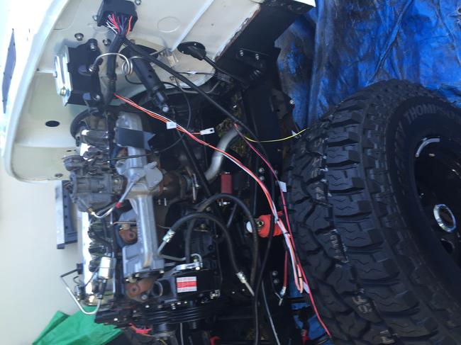

Happy Thanksgiving hope you have the best family. So this morning when out to the CJ check the fuel delivery it's a very good pump is working fine it wants to start but it's it it almost seems like it's off time and I don't understand because I have the top center I've checked the timing thousands of times to make sure it's correct it is. Anyway I did the boat test to the coil I'm going to head and send you some pictures what I did and the fuel delivery set up that I have just temporarily to get started hope you have a great Thanksgiving and I keep you iinformed.

Sorry---i hunt and peck pretty darn slow----i've sorted my pics, but there are hundreds in folders, it takes me time to find them
Just tryin' to give you info in the best order I can without writing an entire manual
When I get the results of all of your testing---we'll get more and more in depth
If you are lost on what i'm shovelling---please ask I want you to do it right!
I do link a lot to to stuff i've already written
How are we doing so far?

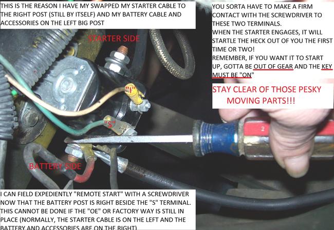

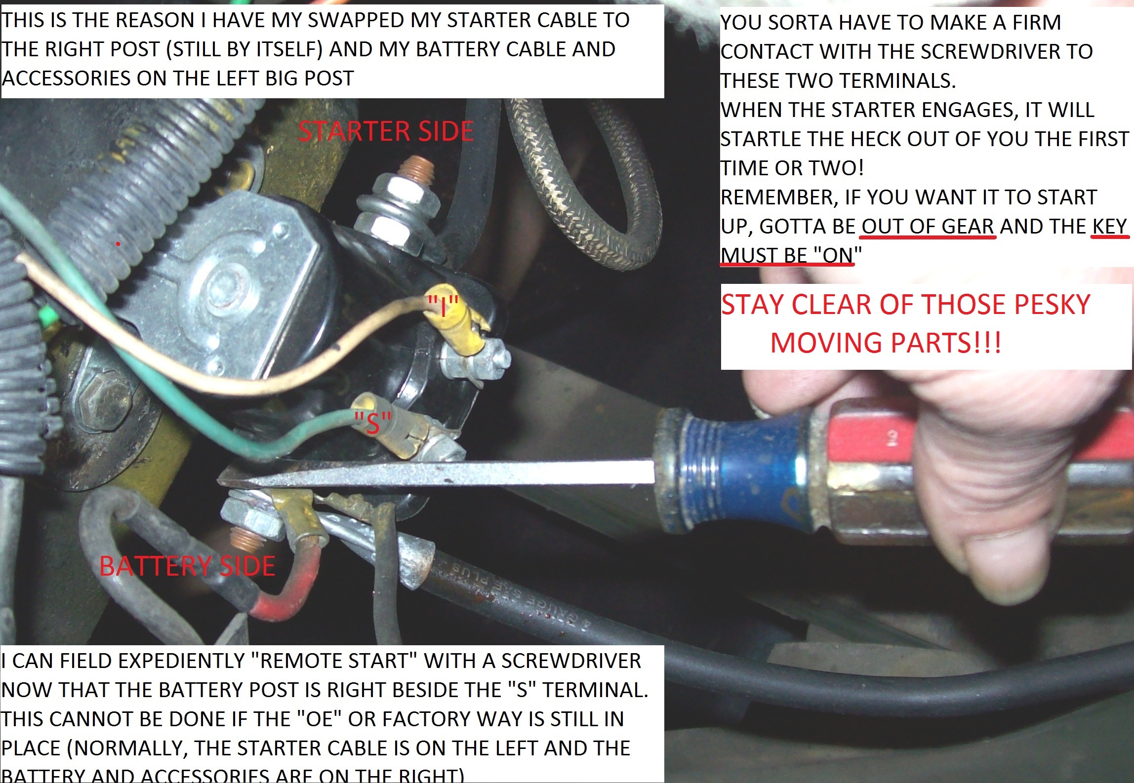

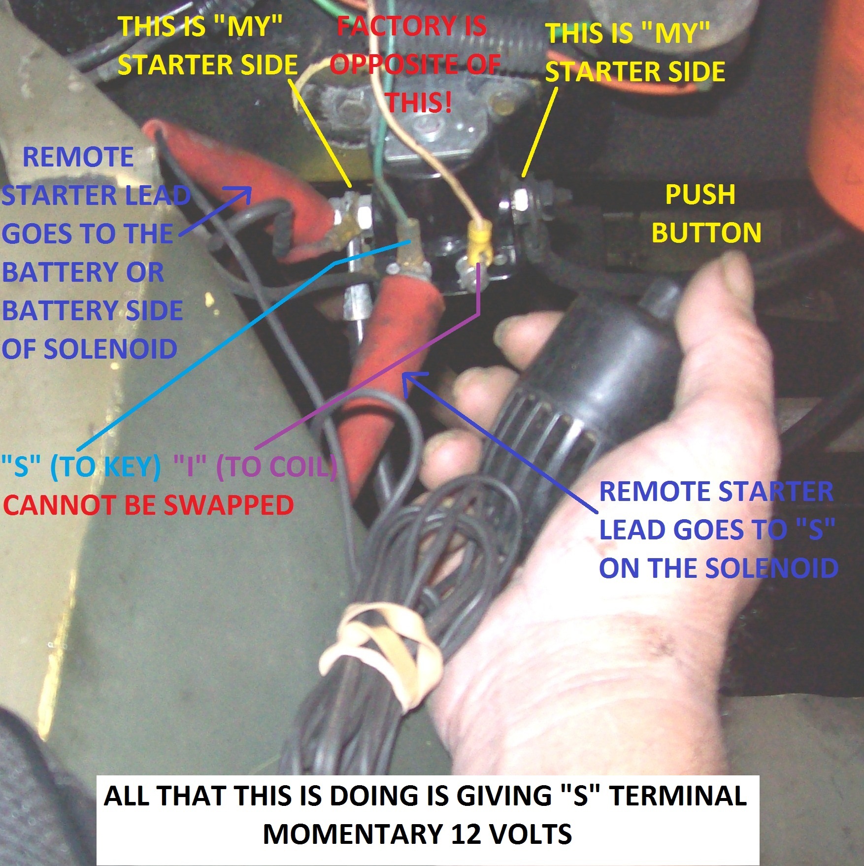

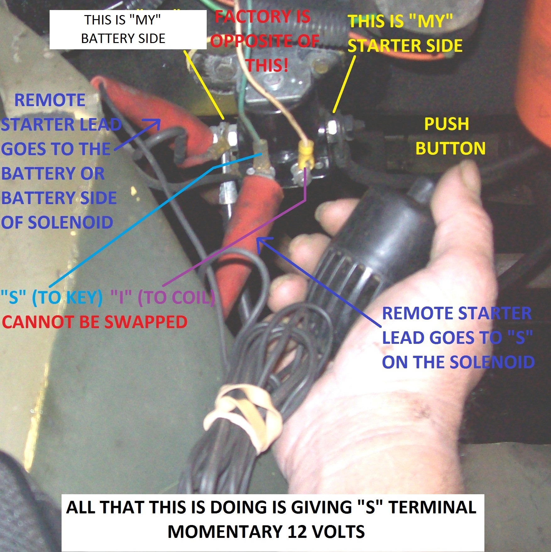

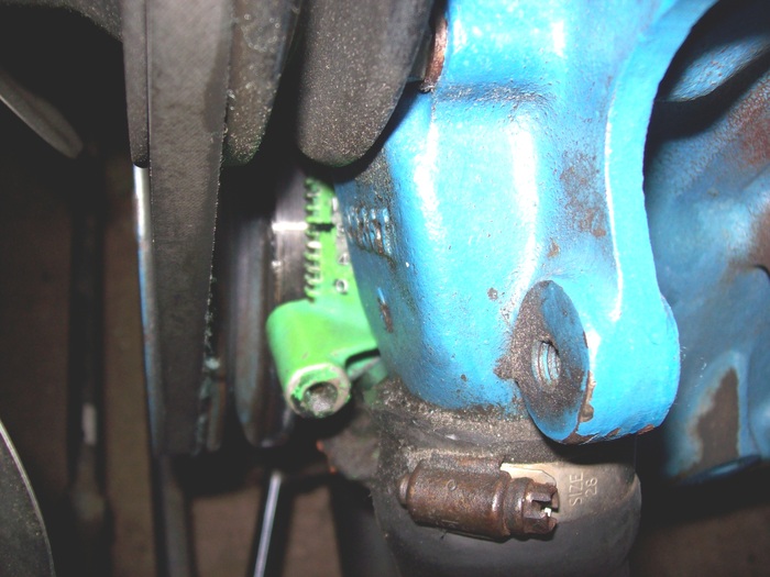

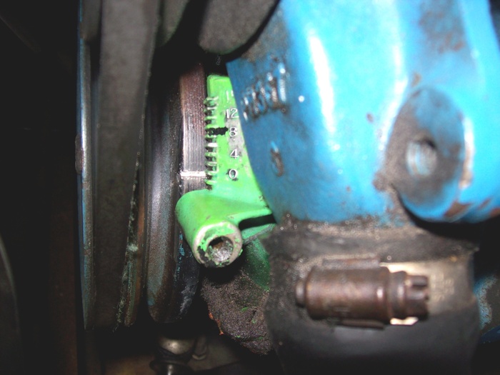

Loosen the distributor clamp so that the distributor is still held down with some pressure but will move and stay put, if you turn it with your hand.
Have a pal crank on it while you ease it in either direction
You can do all of this all by yourself if you turn the key to "on" and have a remote starter switch to use (see my pic)
Again, the two teaspoons of fuel into the carb barrel might help

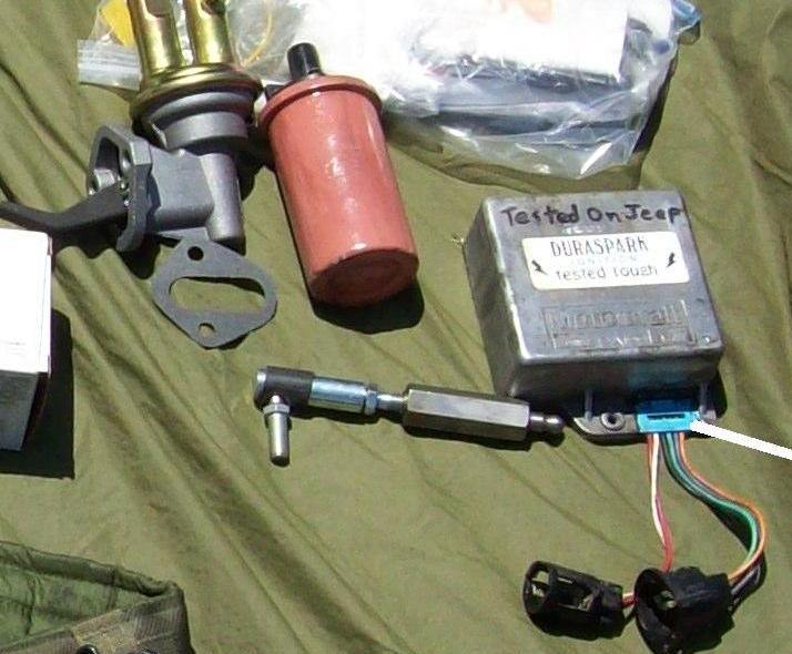

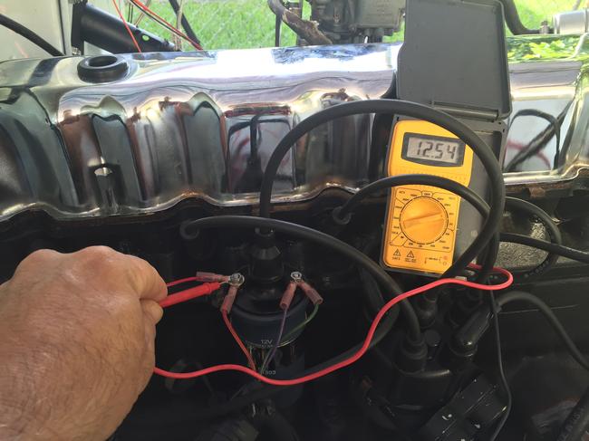

CJ MEDEVAC
  • 11,004 POSTS
This is where I become your bestus buddy!
We're gonna test the coil with the help of morris

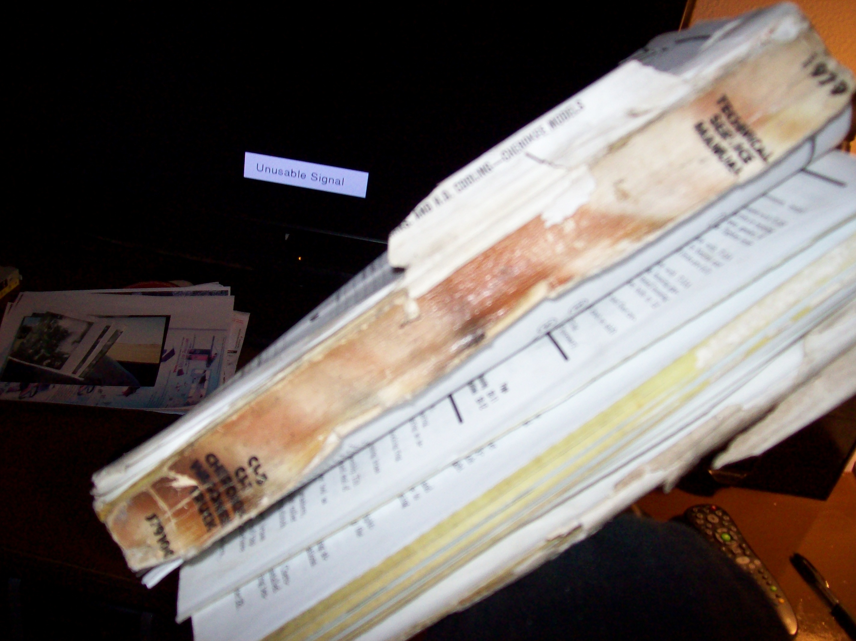

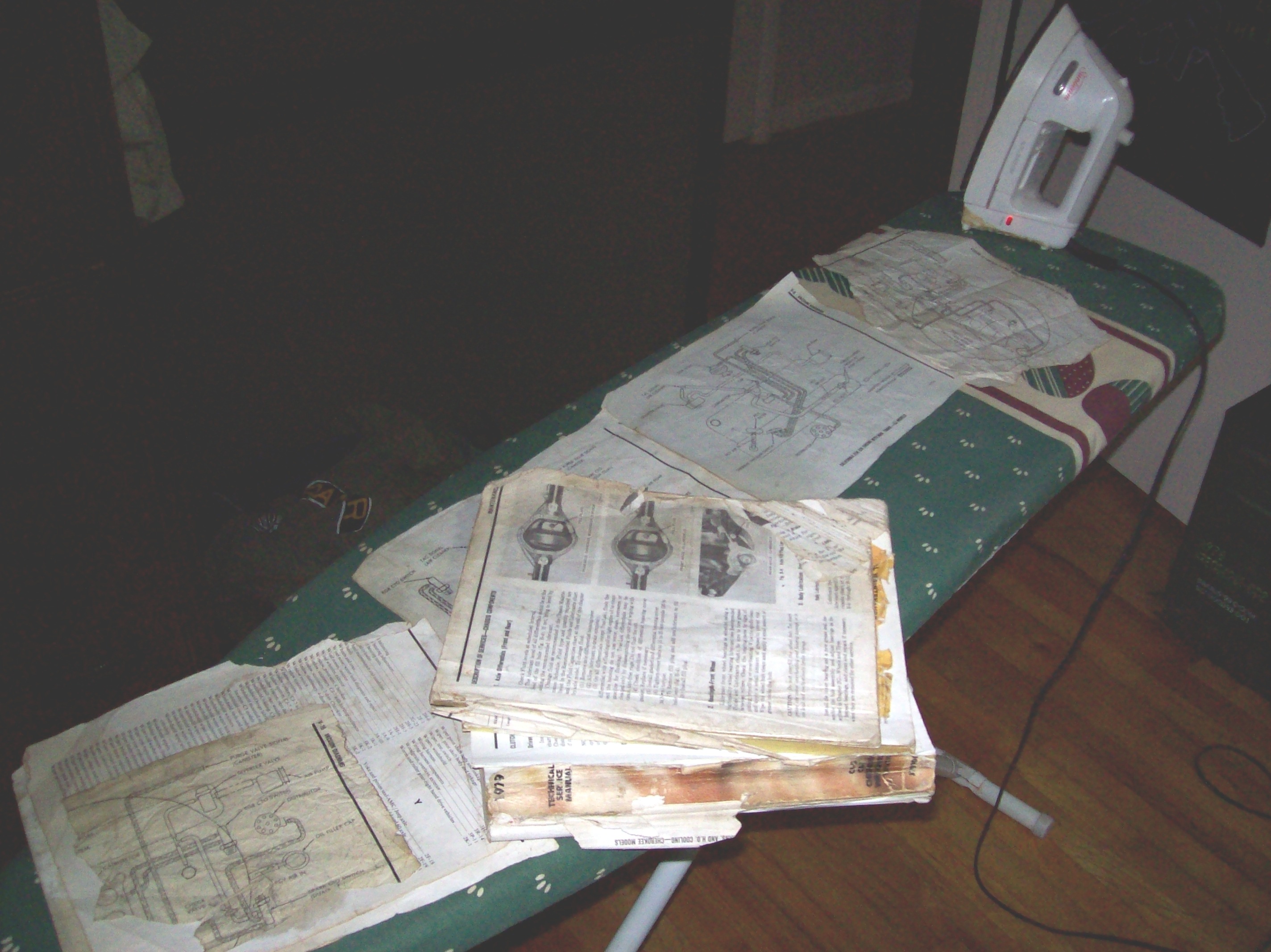

I have the "1979" paper manual that was left in my '79 cj 5, by mistake when I bought it in 1983.I did not take care of it, when I realized it's value, I started treating it like it was a sacred scroll
Using the drop-downs, install: cj 7
. Then 1980 (76-78 ign is different than yours [prestolite].79-80 is the same as yours [motorcraft])
They did not replicate the manuals, so "1980" is gonna be you, when you look stuff up!
Now then, last thing."Power plant-ignition system (1,961kb)". You have just entered "the book"!
Scroll a bit
(these pages can be printed)
You will run into diagnostic chartsthey are like flow charts
The "specs" you need for the tests. Are further on. On page "1g-18"
They also assume that your "mechanicals" are in order when you begin.(Stuff I was trying to pull out of you. Like distributor in right, timing gears right? Modifications other than factory?). That stuff is found in here too, you just gotta have a librarian (me) guide you to them, at the right times!
Forget trying to test the module yourself, you can't do it all--at once, as fast as the parts store tester can over and over, you will be fooled by the test in the manual
In fact, you'd be better off buying one---if it was not the problem, you would have a spare
I keep a spare coil, ignition module, and a fuel pump in my console. So far, 2 other cjs were glad. One needed a fuel pump, the other an ignition module!

It fired up!
Turns out the coil was bad. Thank you for pointing me in the right direction with the testing of it. Turns out it was weak, very weak.
Now I just need to finish the vacuum lines and time it. Thank you so much for all your time and energy!

I really did not think it would be coil failure
It's been very seldom I have seen a "coil" go bad in a cj
I have seen people put the wrong one in many times
95% of the time. It's the ignition module that messes up!

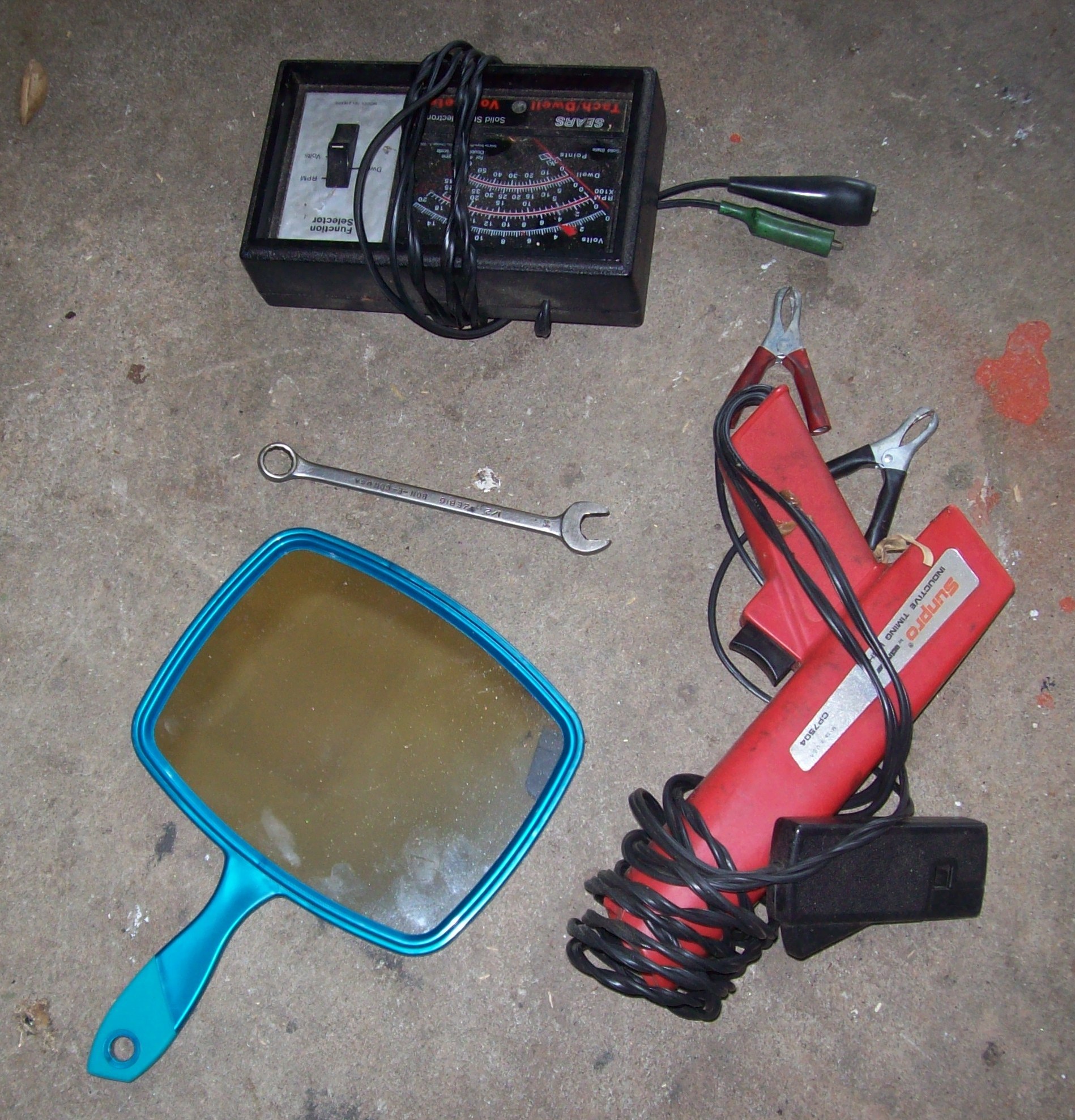

Since then----i learned how to quickly check and confirm that both advances (mechanical and vacuum) are actually working correctly. Using only a timing light.I do this from time to time (usually when teaching else someone how to check 'em!)
Symptoms range from. Backfiring--loss of power---higher idle speed than before a mpg drop. Sometimes it's just not so obvious you even have a problem. These problems are not just limited to the older system, they can also happen to the motorcraft system also. From my experiences with mine and others just not very often

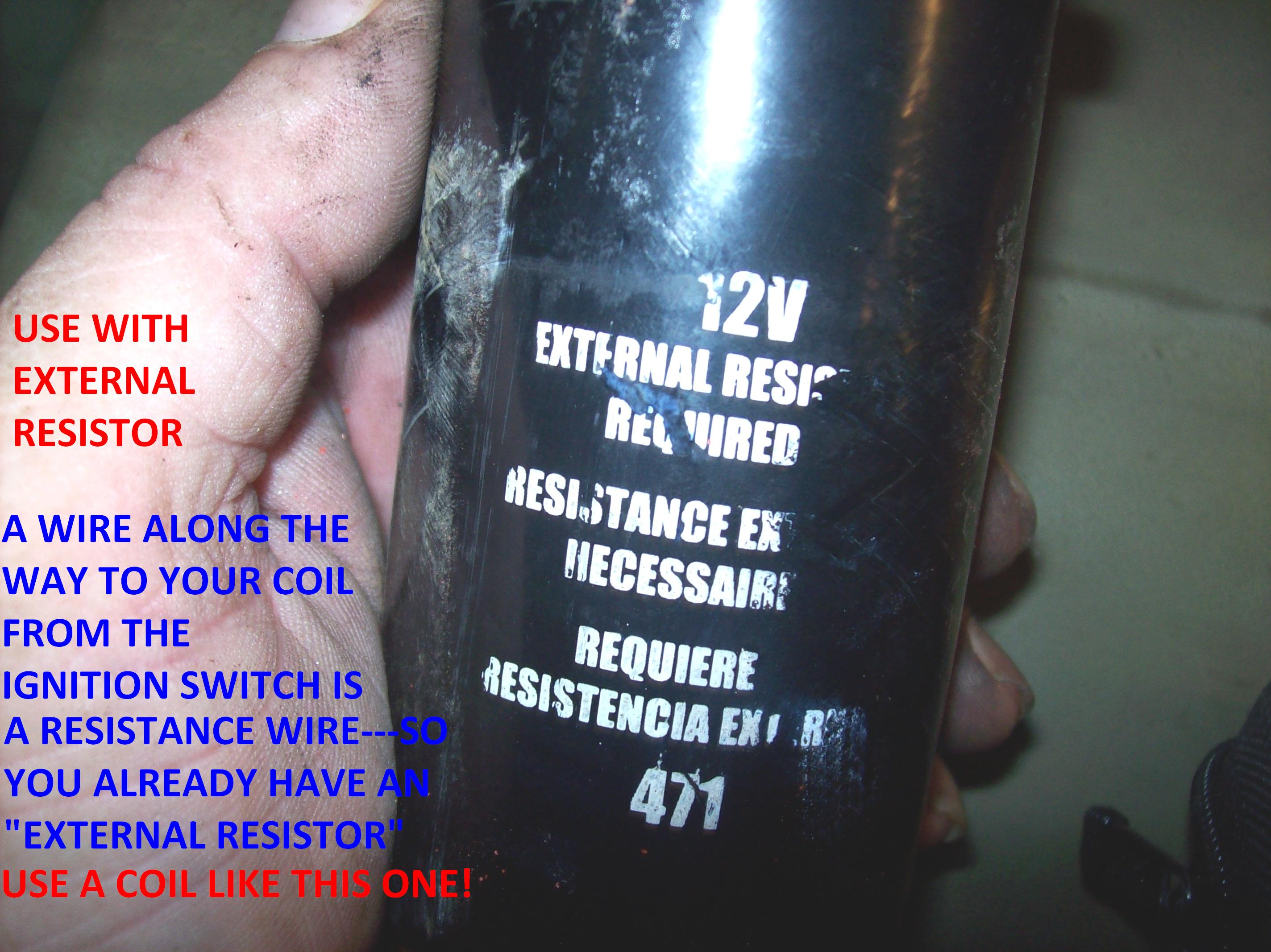

Really there was not a lot involved in order to "upgrade" to the motorcraft system. Motorcraft was installed in the 1979s on upi have not had much trouble with them in my jeeps, past and present---- a so much better design than before!
A few butt splices---a ballast resistor ('78 on back did not use a "resistance wire" like '79 on up)----and a few wires from a 70s or 80s "ford product" ---to tie the ign module to the distributor (those big black connectors).I installed a reman distributor from advance auto parts---it was about $50.I had to buy a distributor cap and rotor button as well

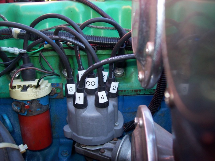

Below is the coil for '79 on up
Glad you got it running----ready to tune it now?
