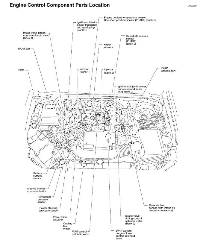

NBESSONETTE
Hello Ken,
I have a 2007 Nissan Pathfinder 4.0L,
Intermittent start issue, spins over but won’t start. I can remove the positive battery cable for 1 minute and then reinstall, and the vehicle will start right up.
What could this be?
Friday, December 14th, 2018 AT 4:58 AM
KEN L
  • MASTER CERTIFIED MECHANIC
  • 55,297 POSTS
This sounds like the PCM is going out because you reset it when the battery is discounted much like you reboot a computer. I would try a used or rebuilt unit and plug it in to see what happens. Here is the location:
We can try to run the codes but I don't think it will show anything.
Friday, December 14th, 2018 AT 11:03 AM

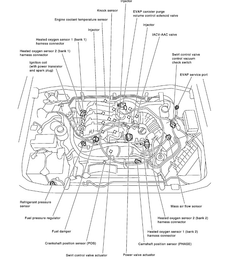

BIGRED68
Hello Ken,
I have a 2002 Pathfinder Ti and have intermittent start but only when the car is hot, Have had a new fuel pump put in plug fuel filter, new crank sensor and had new spark plugs put in but it is still doing it. I am about ready to trade it in
+1
Friday, November 1st, 2019 AT 10:25 PM
KEN L
  • 55,297 POSTS
I have nsee the engine coolant sensor short out "hot" causing the engine not to start we should run the codes even though it may not pick up this problem. Here is the location of the coolant sensor so you can check it out. (rear of the engine)
Saturday, November 2nd, 2019 AT 12:23 PM
ALICIA RAYMOND
We just got a 2007 Nissan Pathfinder! And now we realized it intermittently starts! I can't believe this happened. We should have done our research more (sign). The mechanic said everything is new in the car, and has been replaced. We have the code of P0430. What could be the problem?
Friday, March 6th, 2020 AT 8:43 PM
KEN L
  • 55,297 POSTS
When the engine wont start, turn the key to the on position without cranking the engine over can you hear the fuel pump run in the tank for 5 seconds? Also we need to check for spark.
This guide will help us:
+1
Saturday, March 7th, 2020 AT 12:28 PM

99NISSAN
  • 13 POSTS
I have a 1999 Nissan Pathfinder LE I just replaced my fuel pump and filter because they went out and now I am having these problems my car will start when cold for 15 to 20 minutes maybe and then die. I start it right back up and it’ll run for 5 minutes then dies again and won’t start until it is cold I’ve seen it could be my MAF, Distributor or crankshaft position sensor.
Thursday, October 3rd, 2024 AT 8:14 PM
KEN L
  • 55,297 POSTS
Yes, it could be these things but can I ask if you have scan the car for codes?
This will help us get going in the right direction to help fix the car.
Friday, October 4th, 2024 AT 11:25 AM
