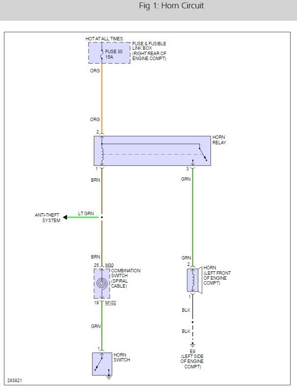

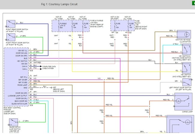

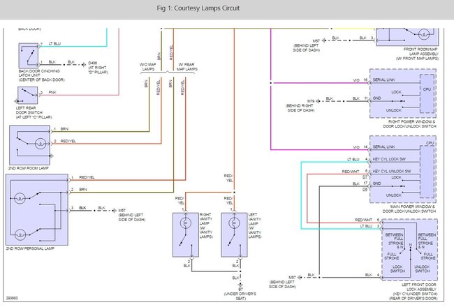

Also to be clear, the horn and light don't come on anymore. The security icon flashes normally when leaving car. Stays on solid whenignition on and trying to start vehicle. Thanks. Just want to bypass the immobilization system
Thursday, April 13th, 2017 AT 4:41 PM
KEN L
  • MASTER CERTIFIED MECHANIC
  • 55,499 POSTS
You can not bypass the system becasue it is built into the computer. By Chance did you connect the battery backwards for a second? Have you checked all of the fuses? For the horn there is a fuse and there are 5 fuses for the interior lights, here is a wiring diagram so you can find them, if there are fuses blown it will cause the security light to stay on.
