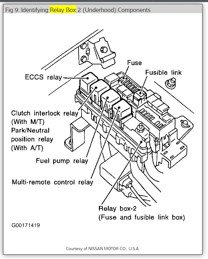

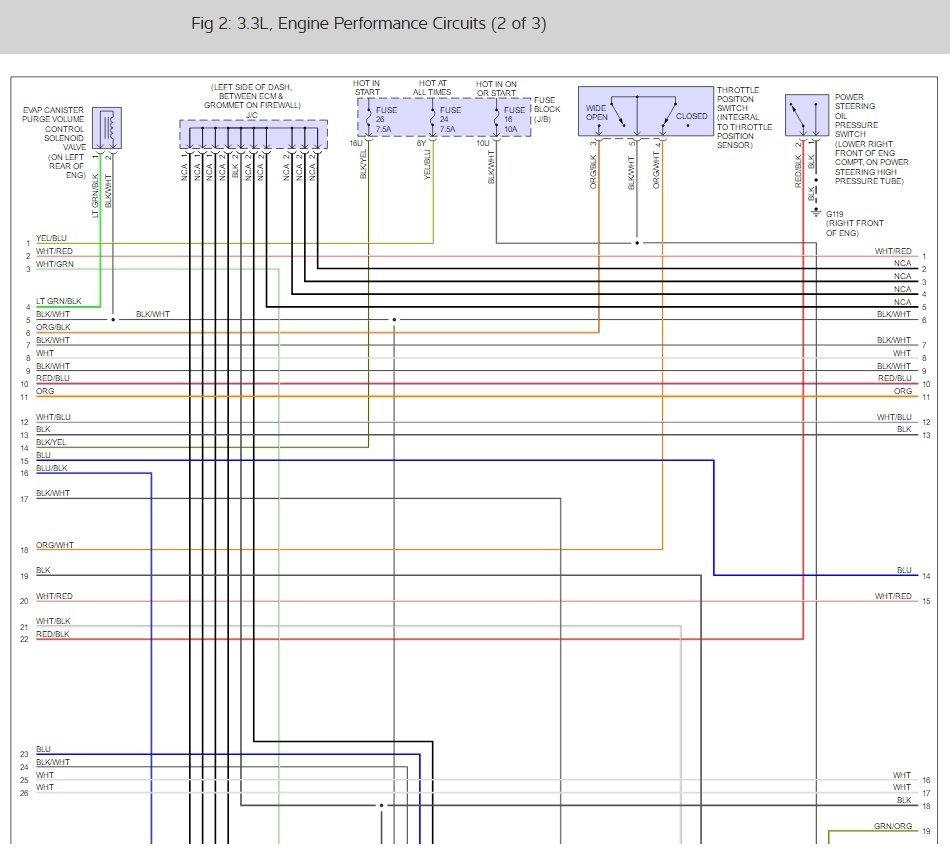

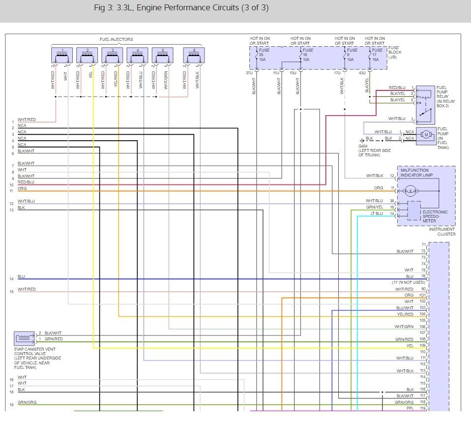

It sounds like the ECCS relay is not working here is a guide to help you check it along with the location of the relay.
this guide can help as well.

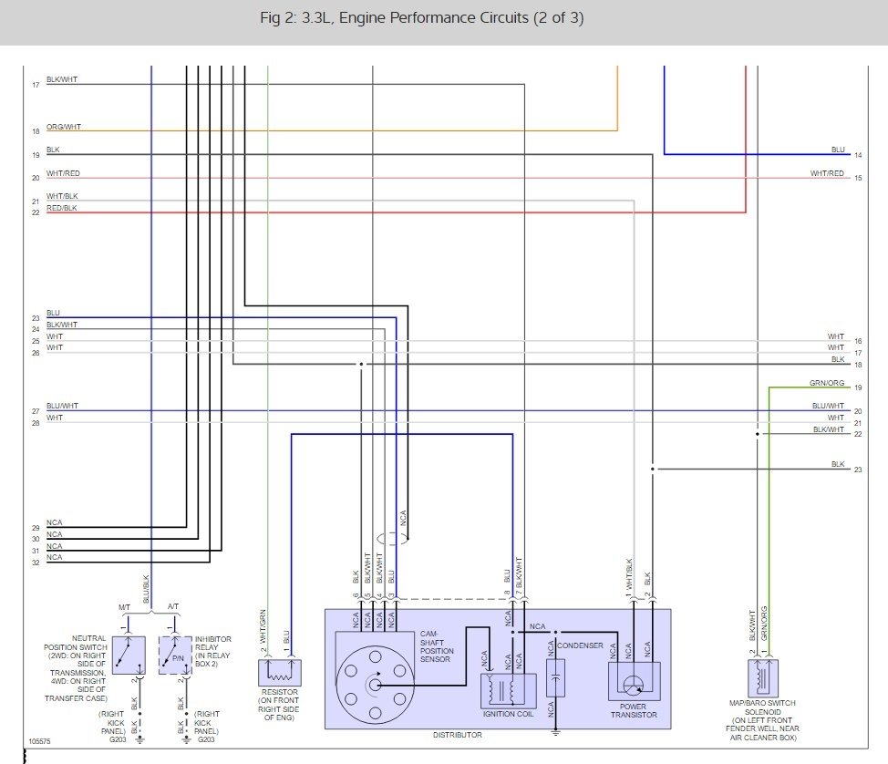

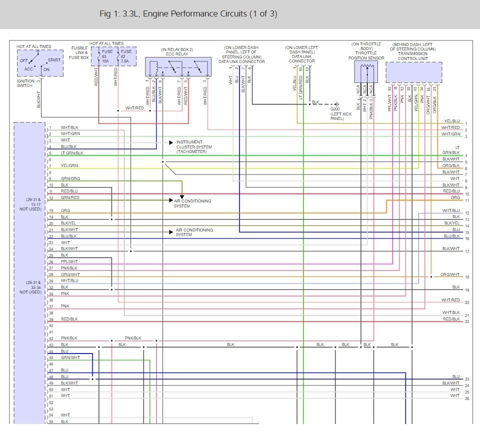

Check out the diagrams (Below). Please let us know what you find. We are interested to see what it is.
Cheers

Thanks for this post the relay was bad I had to get a new one cost me $45.00 all fixed! I love this site.

the engine will not start. the lights in the dash light up but no start. the fuse IGN AT 10A CONT was blown. replaced fuse. tried to start again. blew another fuse.
Nov 14, 2018 at 12:11 PM (Merged)
  • CAR REPAIR CONTRIBUTOR
  • 54,350 POSTS
Do have a short in the wiring causing the engine not to start here is engine wiring diagrams (BELOW) that will show you everything on the circuit so you can do some checking to see what is wrong.
There is an ECC relay, ignition coil or an injector can be causing it. disconnect them one at a time to see which one is causing it.
Please run some tests and get back to us so we can continue helping you.

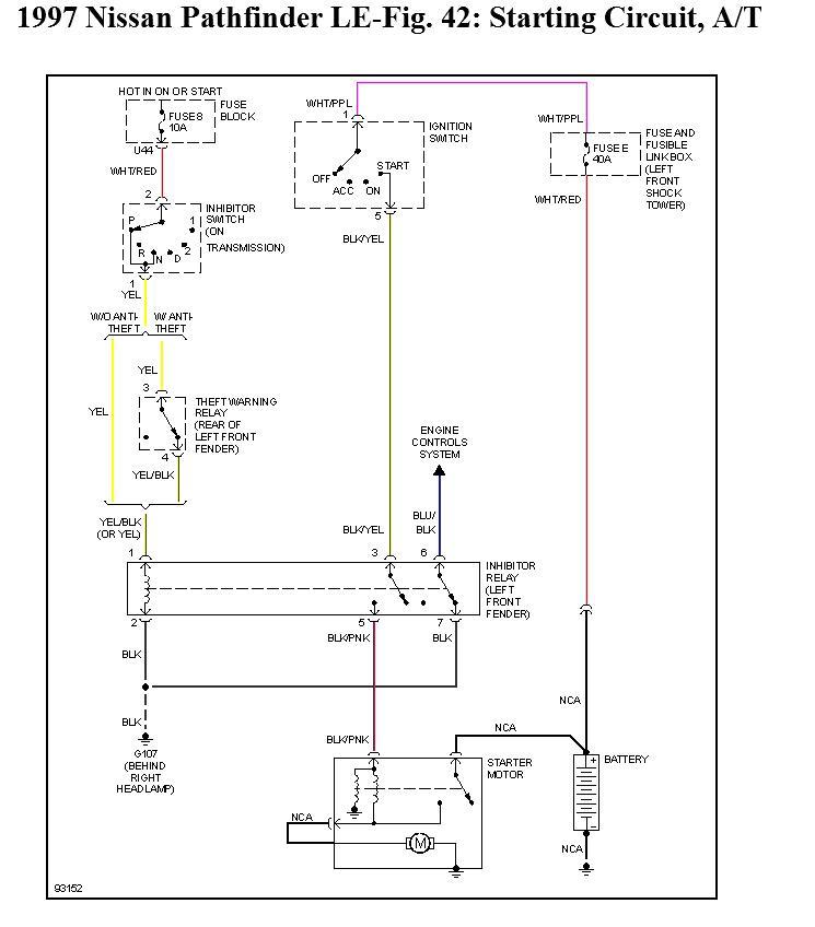

Diagram shows the starting circuit.
With transmission in P or N and ignition turned on, test for battery voltage at the inhibitor relay termnal 1. If voltage is not available, test for battery voltage going to and out of inhibitor switch, Yellow wire.
