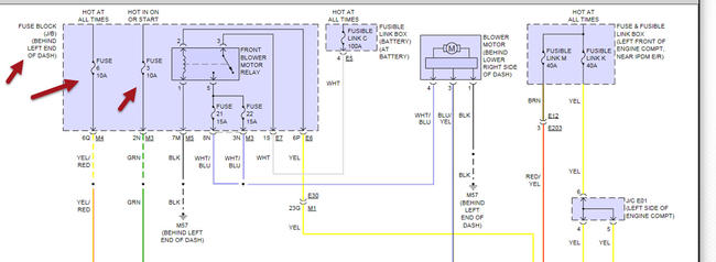

HMAC300
  • 48,601 POSTS
Pull the HVAC fuse in fuse box inside car with key on for sixty seconds then replace. It may reset the air temperature actuator. If still not blowing cold check pipes going into dash one should be hot other cold if not then there is something else wrong like low on Freon which should be checked by a professional. If automatic temperature control where you set temperature

HMAC300
  • 48,601 POSTS
Try this , pull the two fuses in pic for 60 seconds then reinstall them sometimes the actuator will reset from this. If it cools then gets hot have a professional look at it as it may be what is called freezing up. also run the ac after doing the fuse thing and feel the large pipe going into dash. if it is cool it may be the temp actuator or something else. but a pro should do this because of what you have previously stated.
Here is a guide on what to look for and so you can know what a mechanic is telling you
Please let us know what happens so it will help others

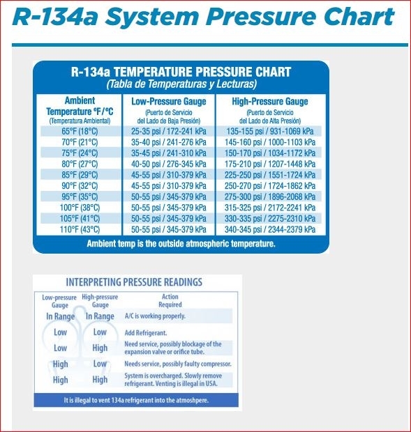

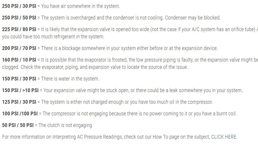

We need to start with what the actual A/C pressures are. You could have a restriction in the system but we can find this out with what the high and low side pressures are and go from there.
If you don't have a gauge set then you can rent those from most parts stores that have a tool rental program. Let's hook that up and see what they are with the compressor on and off.
Let's start here and see what they are telling us. Thanks

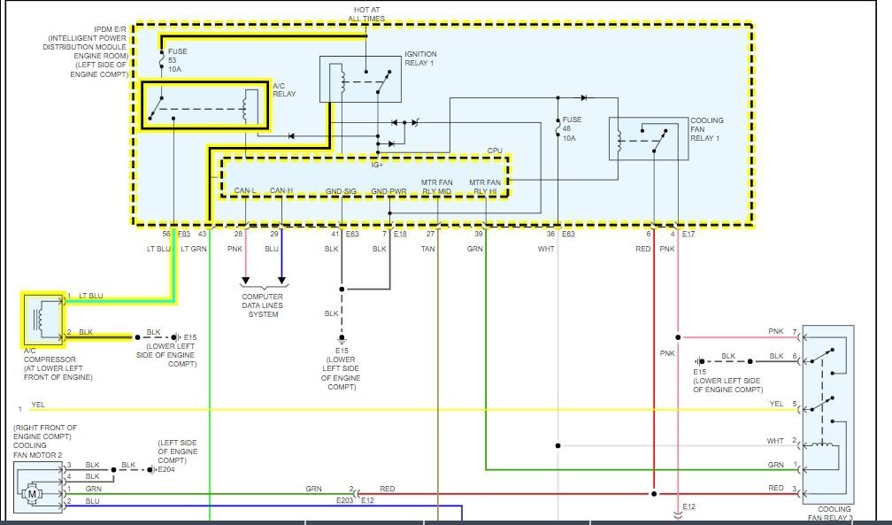

Good morning,
Most likely low in Freon but need to check. Is the compressor working when you turn it on? I attached a wiring diagram for to view if it is not working.
You need a set of gauges to see the actual high and low side pressures. Without pressure, it will not work.

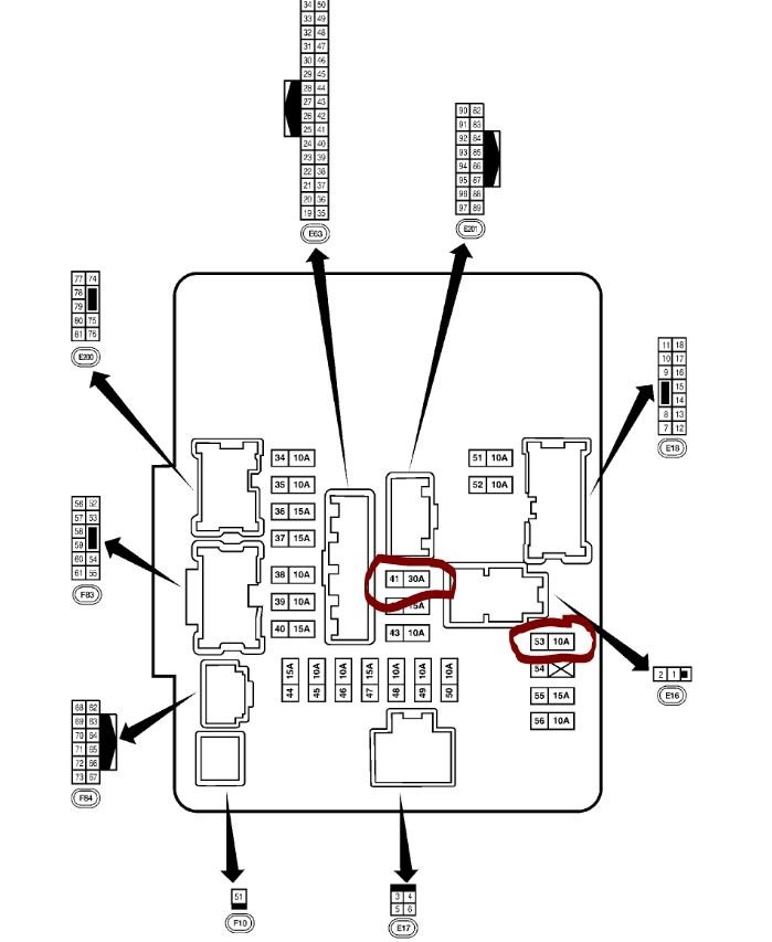

The Freon charge test goes red. Clutch does not engage. Blower was checked and found clean and works well. The compressor control valve was replaced with new one.
Nothing happens. No cold air with A/C placed at max.
Dealer diagnostics pointed to the A/C compressor. It has to be replaced. Exorbitant price. Did not bite it.
But what they did not check is the A/C fuse. Based on video online the fuse box near the battery shows the fuse to be Red 10A which is found on top space at 2nd spot. Not sure if indeed this is the aircon fuse. But when we tested it, it was not blown but does not light up when tested.
Questions:
As described were we able to pinpoint exactly the real A/C fuse?
If it is, then where shall we look to make it work? If that is not the A/C fuse, where can we accurately find it?
Thank you and best regards,
Ray Raz
Tuesday, May 25th, 2021 AT 11:25 AM (Merged)
STEVE W.
  • 15,697 POSTS
What are the actual pressures in the system using a set of A/C gauges? Saying the gauge goes red sounds like one of the gauges on a can and if it's in the red the system is likely overcharged.
As for the fuses there are at least 4 different versions of that system. The 4 door manual system where you have a dial to control the temperature uses fuse #53 in the under-hood box. If you have the automatic system where you just set a digital temperature and it does the rest uses fuse #41 If you have the 2 door coupe then both use fuse #41 for the A/C clutch. Fuse 41 will be either a 10 amp or a 30 amp depending on which version of the car you have, Both 41 and 53 are circled in the image of the under-hood fuse block.

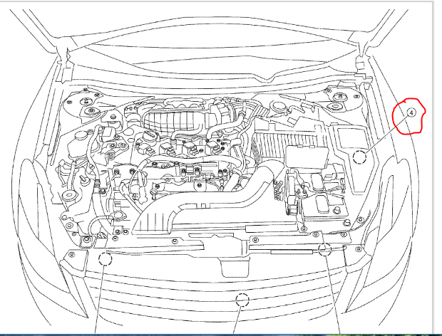

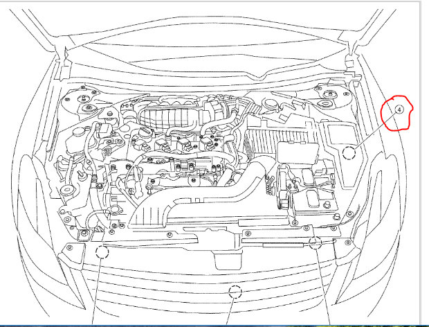

The AC will not blow cold air after filling it with refrigerant. It's not cycling right. Where is it located and what is the price of the relay?
DANNY L
  • 5,648 POSTS
Hello, I'm Danny.
The relay is located in the IPDM (integrated power distribution module) under the hood.Here is a tutorial showing how to test a relay:
Relays are available at any local auto parts sores and generally run about $10.00. I've attached a picture below showing its location.Its location in the IPDM will be marked on the plastic cover.Hope this helps and thanks for using 2CarPros.

Let's start with the AC pressures with the engine off and then with it running. If the Freon is low then it will prevent the compressor from coming on.
If this is okay, then we can move onto the next item which will be making sure there is power to the compressor but let's start with what the pressures are.
