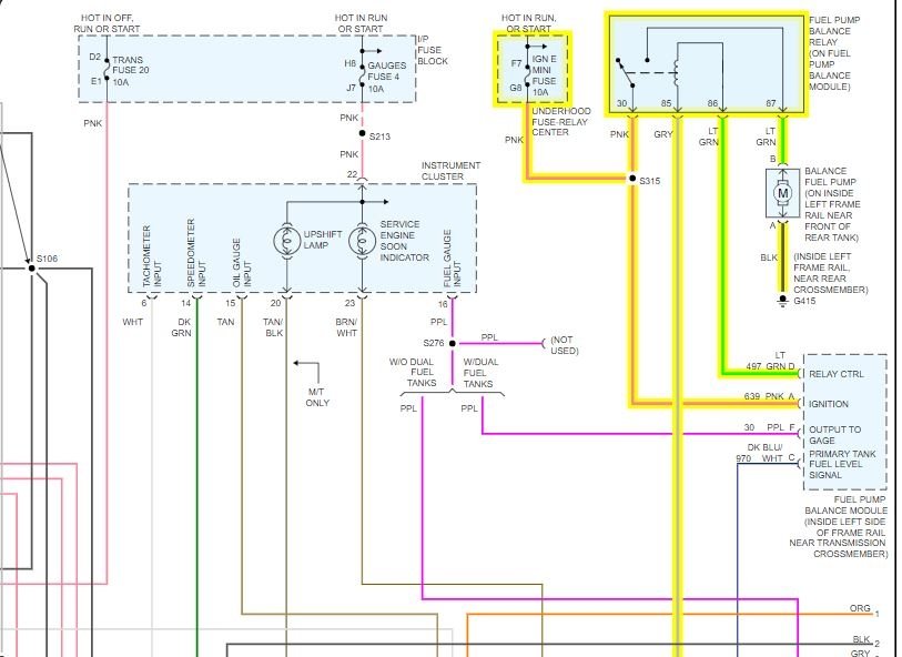

Just replaced the transmission in my truck. Got everything hooked up and went to start it. Heard the fuel pump kick on and off while I turned the key over. Truck started with a jump and ran for approximately 3 minutes then just shut off. Tried to start it again and now nothing coming from the fuel pump. No hum or noise whatsoever. Is there something that i'm overlooking that would cause the fuel pump to just stop in mid idle and not engage again? I'm about to my whits ends with this truck.

I attached a wiring diagram for you to view. You will need a test light or voltmeter to do some wiring tests to find the failure.
The gray wire is what goes to the fuel pump. Test that for power when you turn on the key. It will run the pump for 2 seconds and shut off.

You need to go to the relay and remove it. With the key on, you should have 1 terminal that has power.
Then test the other terminals. Have someone in the truck and turn the key to on. 1 of the other terminals should have power for 2 seconds and shut off. That is normal.
Do these checks and let me know.

Yes, black lead to the negative side of the battery.
I attached a guide for using the test light for you.

Okay, that is good. That means it is being activated by the ECM.
Now you need to go to the fuel tank and test the gray wire for power when you turn the key to on.
If you have power and the fuel pump does not work, you need a pump.
If you do not have power, then there is a wiring issue between the relay and the fuel pump.

When I put the key in the ignition and turn it on there is no power coming to the gray wire, but there is power going to the purple wire which is the one that is in the middle of the three.
