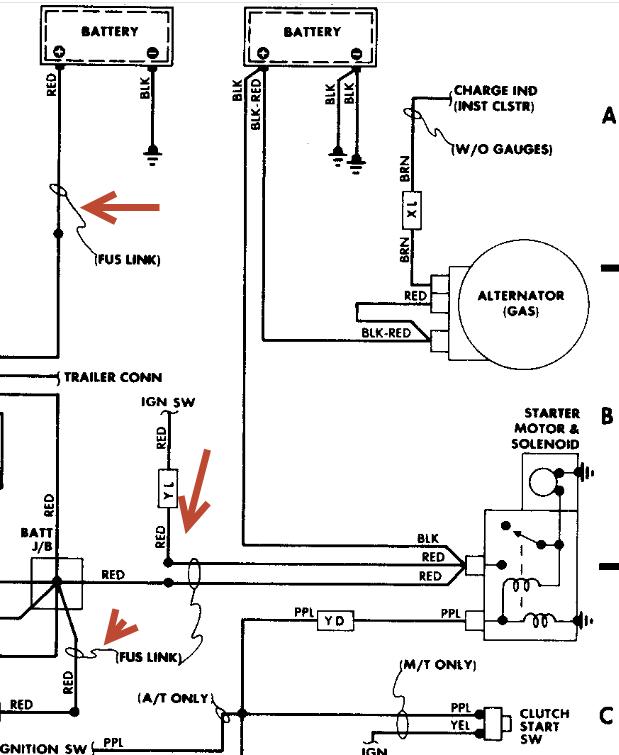

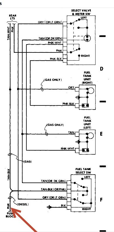

I am attempting to trace why I am only getting 8.4 volts to my dual tank switch on my 87 R30. I have ohmed all the fuses, checked every ground I can find, have jumpered 12 volts directly through the switch, switch connection, and both relay's and got 12 volt's to the fuel pumps, which work fine. I am currently trying to locate a fuseable link that I read about behind the gauges. Have yet to find this mystic wire. Any suggestions??

most fusible links on that year are attached to the starter under the manifold. if you rlinks were bad it could cause this but it almost sounds like a wire is grounding out partially. the pink wire leads to the fuse box off of the ign switch. see diagrams

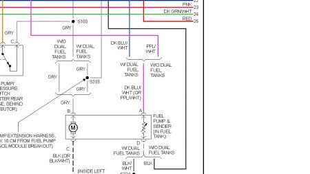

  • CAR REPAIR CONTRIBUTOR
  • 75,992 POSTS

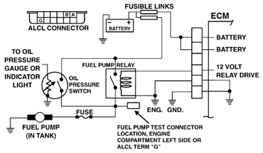

The fuel pump gets its power from the gray wire the black is ground. The fuel pump relay only works for 2 secs. and its energize by the computer below is the fuel circuitry
https://images.2carpros.com/forum/automotive_pictures/12900_pump_wiring_1.jpg
https://images.2carpros.com/forum/automotive_pictures/12900_oil_sending_unit_and_fuel_pump_circuit_19.gif

must be getting too much voltage on system then to have popped the fuse and the switch. yes it could be caused by a failing ECM. may also be the oil pressure switch, the fuel pump circuit runs through the oil switch as safety measures. does the oil pressure gauge work ?

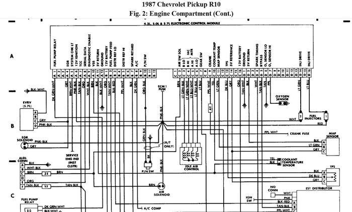

KHLOW2008
  • 41,814 POSTS

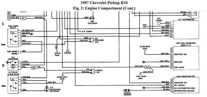

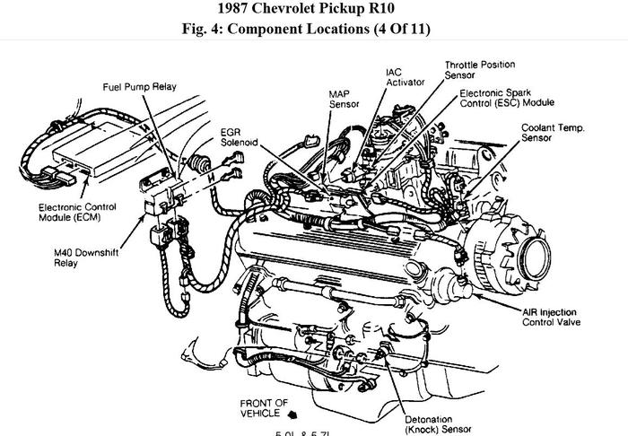

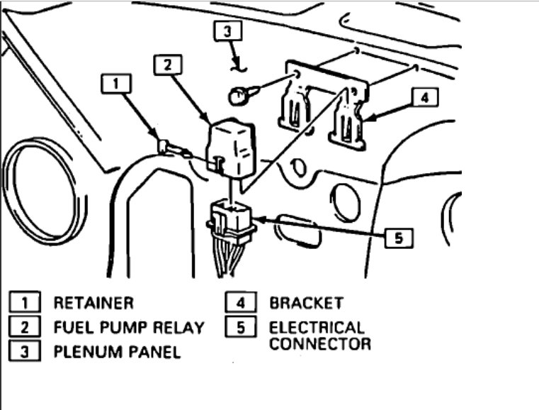

At the ECM, check terminal A1 for battery voltage with ignition turned on. This would only last a couple of seconds as the fuel pump primes. Crank the engine and if battery voltage is available, you have a broken connection between the ECM and the relay. There are 5 terminals for the fuel pump relay, do you have battery voltage at the Tan/White wire? If no, check the oil pressure switch.
Here is a guide to help you test the relay
Cheers
Jul 7, 2020 at 1:42 PM (Merged)

FABIAN19720
  • 5 POSTS
do u have the wiring diagram for the fuel system in my truck that u can post for me
WRENCHTECH
  • 20,761 POSTS
While your in the area, make sure the tension on the contacts of the harness plug are sufficient to make good solid contact. They have a known problem with them. You can use a pick to bend them a little to make them tighter.
KHLOW2008
  • 41,814 POSTS
Here you are. They are too small so I split them up. See if you can print them out and join together for a clearer picture.

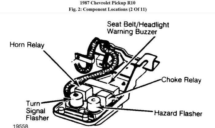

ok on my truck on same bracket as fuel relay theres another relay there with different number but nothing plugged into it do u have any idea on what its there for
FABIAN19720
  • 5 POSTS
i read on another website that some trucks cam out with a 20 second relay for harder starting trucks not sure if thats what it is or not

These are what I have for the relay.
Sorry I do not know anything about the 20 seconds relay.
