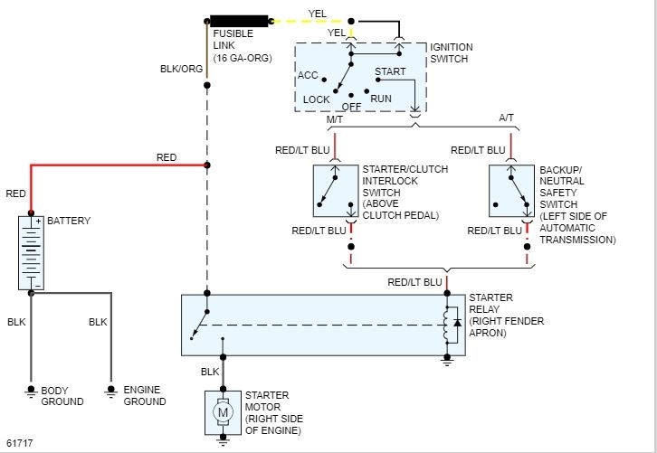

When you turn the key nothing happens but all accessories work ( all lights and radio).
To start the truck you have to use a screwdriver and connect the two posts on the solenoid. But once you get it running it runs for about ten to fifteen seconds then shuts off.
Monday, March 8th, 2021 AT 5:52 PM (Merged)
  • 110,192 POSTS
I need you to check a couple things. First, the starter relay needs ground for the system to operate. Check the relay first. Switch it with a different relay with the same part number.
or check this link.
Next, there could be a problem with the neutral safety switch. See if the starter will engage if you put the shifter in neutral. Also, if it does not, put it in park, parking brake on, and slid under the truck to see if the switch is disconnected or damaged. The switch is on the left side of the transmission.
If all of that fails, I want you to try this test:
I attached a schematic of the starter system for you to review. Let me know what you find.
