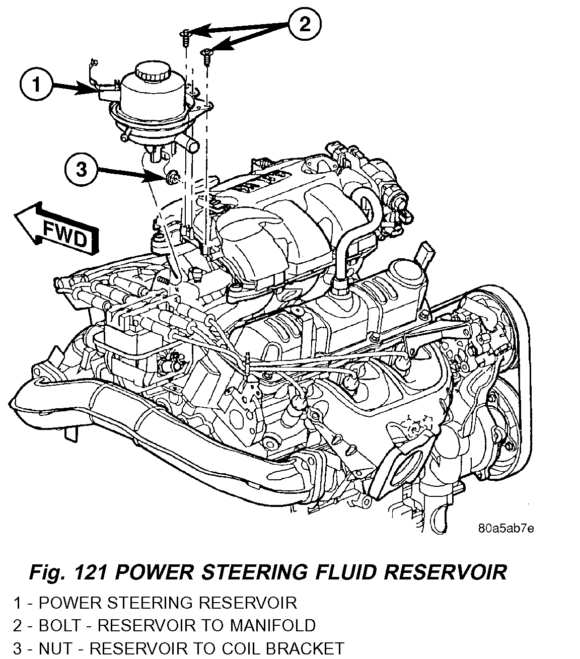

I would need instructions/diagram, yes. Wondering if the power steering reservoir needs to be removed for if it can be pushed back. Same for ignition coil. Also, do you have to replace intake gaskets, being metal?

Yes, the reservoir will need removed and the upper intake. The only other thing I can think of is the MAP sensor, but feel it would be more likely to cause a random misfire and not just that one. Also, a compression variation in that cylinder can cause it.

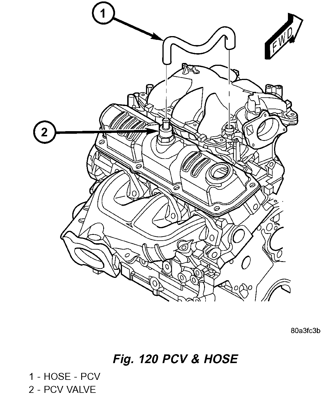

9. Disconnect the PCV hose (Fig. 120).

10. Remove the power steering reservoir attaching bolts and only loosen the nut (Fig. 121). Lift reservoir up to disengage lower mount from stud. Set reservoir aside. Do not disconnect hose.

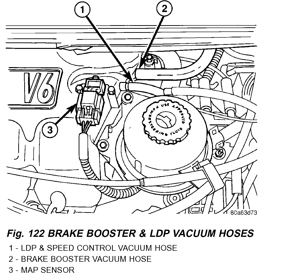

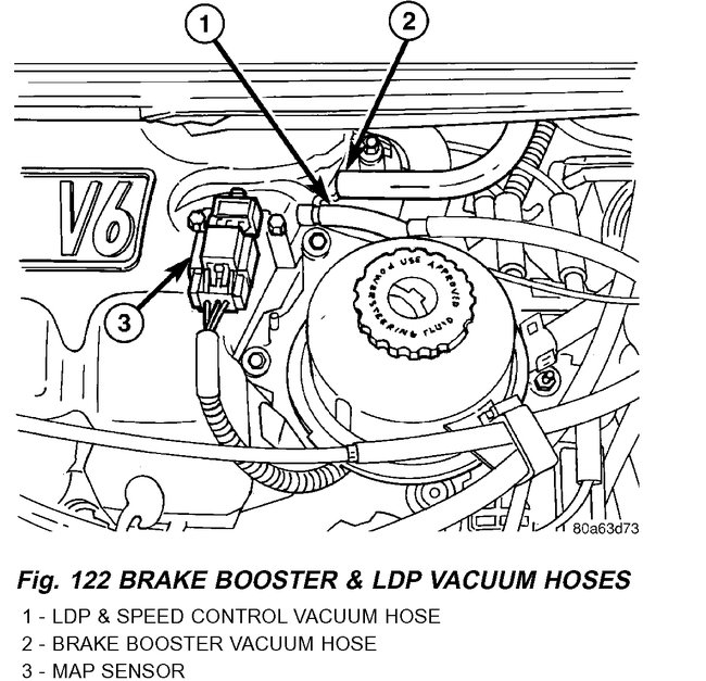

11. Disconnect the brake booster and Leak Detection Pump (LDP) hoses from intake manifold (Fig. 122).

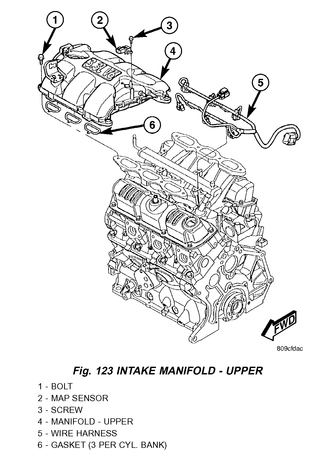

12. Remove intake manifold bolts and remove the manifold (Fig. 123).

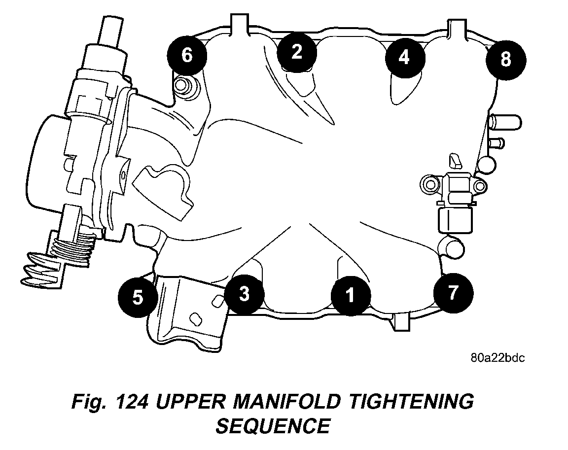

4. Position upper manifold on lower manifold (Fig. 123). Install and tighten bolts to 12 Nm (105 in. Lbs.) Following torque sequence in (Fig. 124).

6. Connect the brake booster and LDP vacuum hose to intake manifold (Fig. 122).

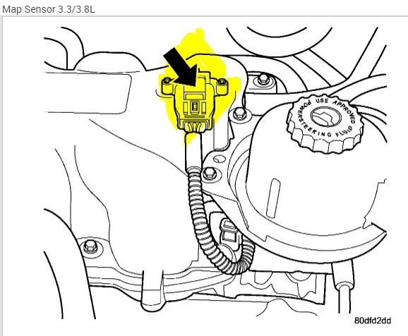

The last thing left is to do a compression check, but before I have you tear everything apart again, would you consider replacing the map sensor? Also, since you have a live data scanner, can you tell me what it is reading.
The thing that has me the most confused is that you are only getting the misfire on cyl 3. A MAP sensor on this vehicle basically has taken the place of a MAF sensor. The computer uses pressures to determine fuel injector pulse widths (which can cause the STFT and LTFT to act crazy), spark advance and so on. Because of that, I would suspect it wouldn't be limited to only one cylinder, but who knows.
It is mounted on the intake manifold. I attached a pic and highlighted the sensor for you. You may want to remove and inspect it and confirm all connections are clean and tight.
If you don't suspect that could be the issue, then we need to check compression.
Let me know your thoughts. If you plan to check compression, let me know that too.
