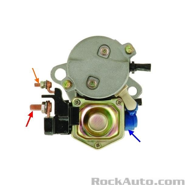

How do I check to make sure the right voltage to the starter motor? How do I check to make sure the starter works? Thanks

My main reason for sticking my nose in here is your starter has a very common failure with a somewhat easy fix. This is a little silver Nippendenso starter used by Toyota, and a little later by Chrysler. They develop burned-away solenoid contacts that cause an intermittent rather loud single clunk each time you turn the ignition switch to "crank", but it doesn't crank the engine. If you cycle the ignition switch off, then back to "crank" enough times, it will eventually work. That problem gets progressively worse and worse over many months.
The way to verify this is to start with measuring the voltage on the battery terminal on the starter solenoid, (red arrow). You'll find 12 volts there. That voltage will drop a little during cranking, but must not drop below 9.6 volts. If it does, suspect a corroded connection in that battery cable. Next, measure the voltage on the other solenoid terminal that goes to the starter motor, (blue arrow, under the blue rubber cap). You will find the same voltage on both terminals when the starter is cranking the engine. When the intermittent problem acts up, you'll find 0 volts, or very low voltage, at the blue arrow.
These voltage readings are easier to take if you use a pair of clip leads, (small jumper wires), to hook the voltmeter's test probes to the solenoid terminals so you don't have to hang onto them by hand. That makes testing these contacts a second way possible. To do that, connect one meter probe to each solenoid terminal, then see what you find for voltage. You will find 12 volts at first, meaning full battery voltage. When a helper tries to crank the engine, you will see that difference in voltage drop to near 0 volts if the starter / solenoid are working properly. If the defect occurs and the starter doesn't spin the engine, you will see the voltage stay closer to 12 volts. It is supposed to go to 0 volts during cranking because the solenoid switches the two contacts together. It's when those contacts are burned away that the switching action is impeded.

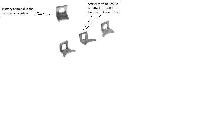

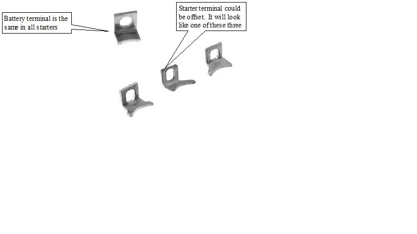

Most hardware stores and farm and home stores have repair kits for these starters. The problem is there are at least three versions of these starters, and it's easy to get the wrong kit. Included in the kits are the four contacts shown in the second photo, but not shown is the plunger that is included. Those have a copper contact disc that makes the connection between the solenoid contacts. They also have a shaft on them that pushes the drive gear into mesh with the ring gear during cranking. In the case of those starters used on Chrysler products, there's two different lengths of shaft on those plungers. The repair kits are listed for specific model years, but the starters as a complete assembly are completely interchangeable from one year or engine to another, so if a rebuilt starter was installed previously, you have no idea what year the current starter is from. That means there's no way to know which of the two kits to buy. Fortunately that contact disc is rarely burned or arced away to the point of needing to be replaced, so you can use the old plunger over. It's the contacts shown in the photo that must be replaced.
Four contacts are shown, but every solenoid uses only two of them. Here again, until you remove the cover, there is no way to know which of the three of them you need. The good news is the kits come with all four contacts. One is the "battery" contact because it has the battery cable bolted to it. That one is at the top left of the photo. It is the one used on all Chrysler and all Toyota starters. The other contact is bolted to the braided strap that runs under that blue rubber cover and into the starter motor, so it's called the "starter" contact. You have to look at the old contact, then match it to one of the new ones. It can be symmetrical, (the left one of the three), or offset to one side or the other. Those vary by the date the starter was manufactured. These repair kits cost around $12.00. If you have a starter / generator rebuilder company, you can buy just the contacts for around $3.00 ea. Every larger city has at least one of these companies. If you don't know where to find one, ask at any heavy truck or heavy equipment repair shop where they send their starters and generators to be rebuilt.
The same applies to these starters used on Toyotas, except they use a plunger that has a much longer shaft than the two used by Chrysler. I've never seen these plungers available in a repair kit or from the rebuilder companies. You'll rarely need to replace it, but if you do, they have to come from the Toyota dealer's parts department.
