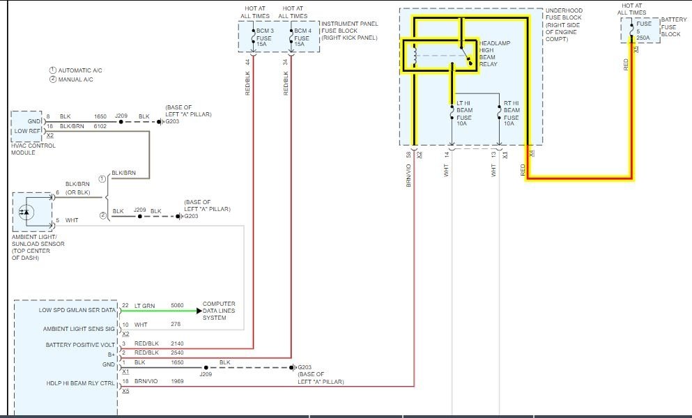

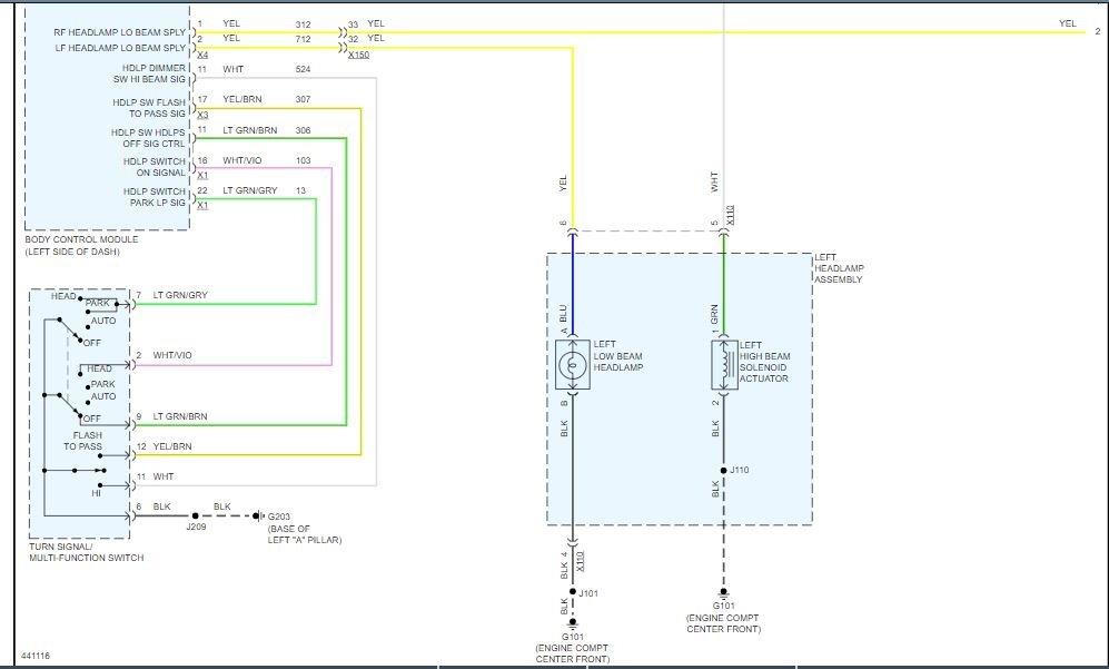

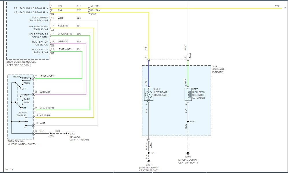

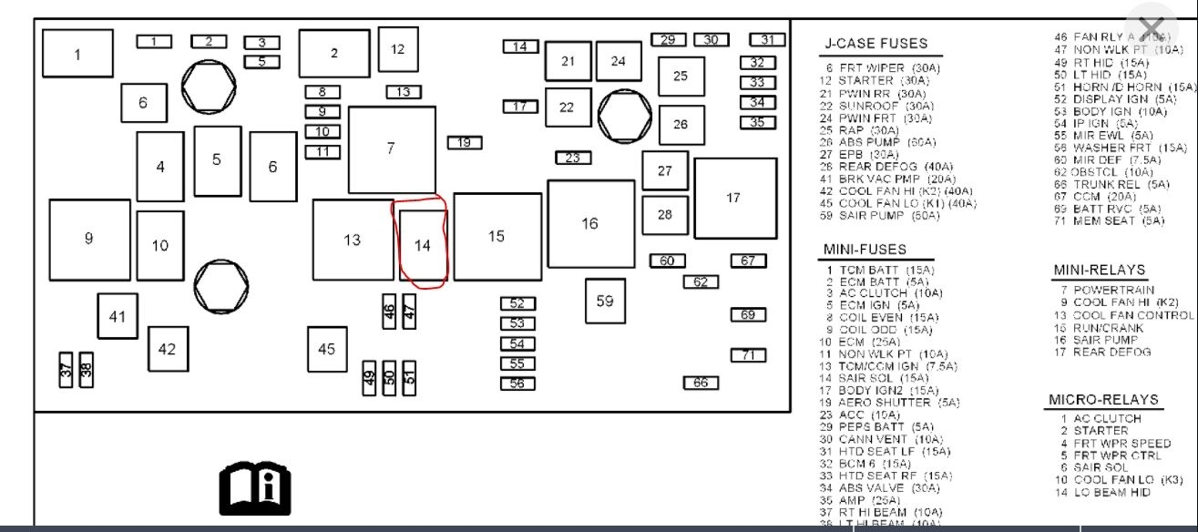

High beam work but no low beams. Need to know location and maybe part number of head lamp relay.

I attached the location of the relay for you as well as the wiring diagram. Check the fuses for power on both sides.
