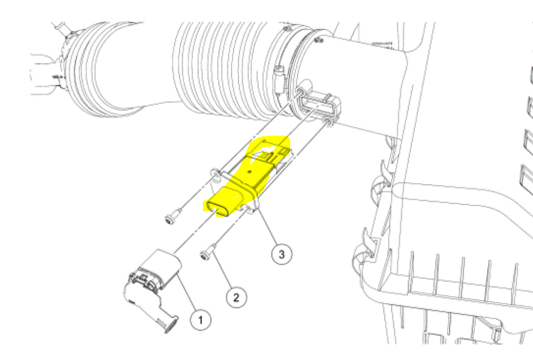

As far as the idle, that is usually the result of a faulty idle air control valve. That is what allows metered air to enter the engine when the throttle plate is closed. However, your description could also indicate an issue with the mass air flow sensor.
Let's do this: Remove the MAF and see if it appears dirty. Try cleaning it with MAF cleaner that you can get at a parts store.
Here is a link that shows how it's done:
https://www.2carpros.com/articles/mass-air-flow-service
The attached pic shows the location.
Wednesday, November 11th, 2020 AT 5:13 PM

Clarification, when I looked at the time stamp it shows 3 hours difference. I am in southern Ohio so our time is the same. I replaced the MAF's module. Seems to be idling fine but was still hard to start. Might be because I tried to start it right after instillation. Cannot remember where I read it but one article said if replacing the MAF's that the computer would have to readjust (recalibrate) itself and I did not give it time to do so. Supposed to be cooler overnight so will test it again on Friday morning. After warming up it had restarted with no problems and the idling seemed smother but the jury is still out on that also. Time will tell. Could I possibly have a "Crankshaft Position Sensor" that is breaking down in cold weather? As I mentioned it starts fine when the engine is warm and in warmer weather.
