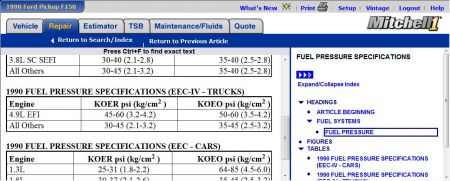

The haynes manual calls for, on 4.9 EFI, 50-60 psi engine off and 45-60 psi running with vacuum hoses connected. I dont know why but the 4.9 calls for more. All others say 35-45 engine off and 30-45 running. And my engine doesnt have a MAF.

Mit1 .com specs below:
KOEO 50-60psi KOER 45-60psi
Your fuel pressure is okay lets start checking the items I've mentioned earlier also inspect and test the fuel pump relay and the PCM power relay
