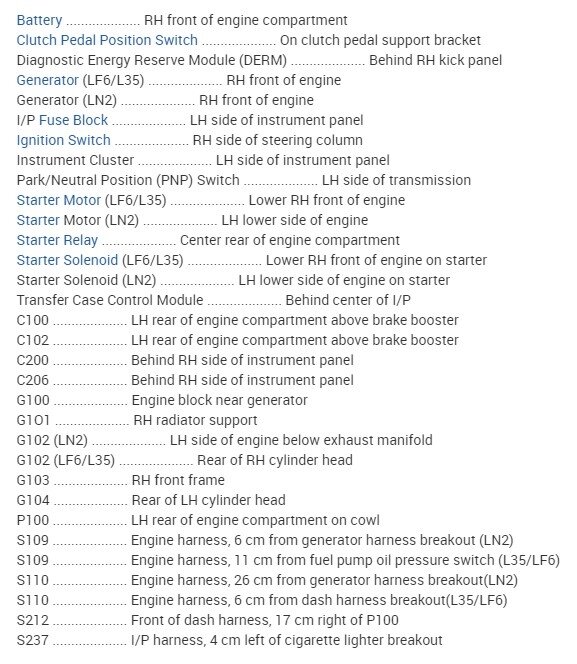

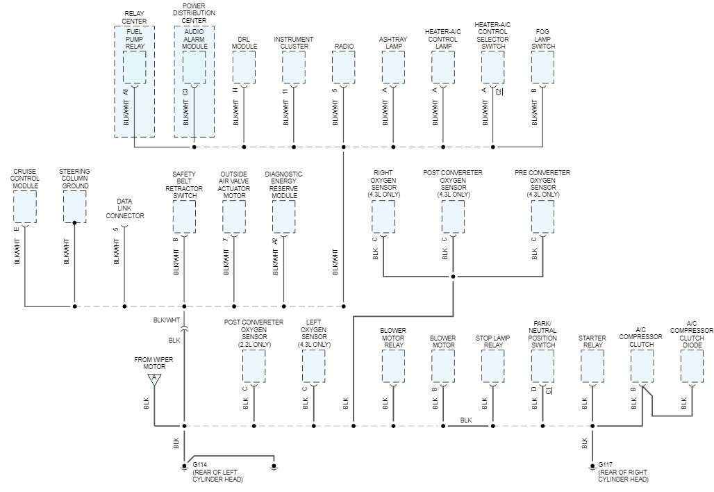

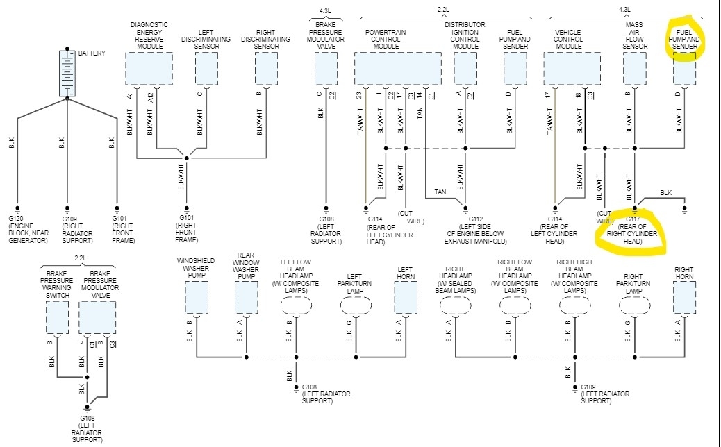

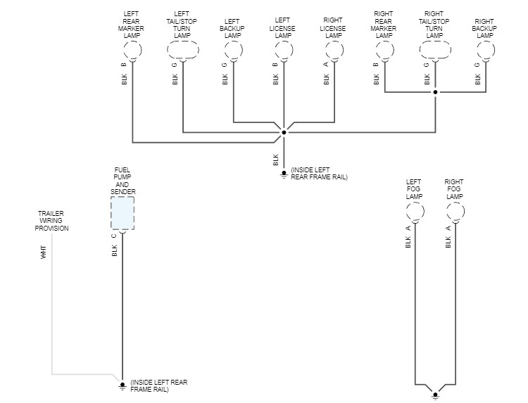

Same location on the opposite head. These are the engine compartment grounds. The list are the grounds and splices for ground wires. They are all interconnected in many ways. A common one is the ground strap that runs from the right head the body, I replace those with a universal ground cable even if they look good. Because of the way they are put together a bad ground can cause a lot of weird problems.

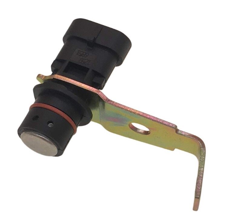

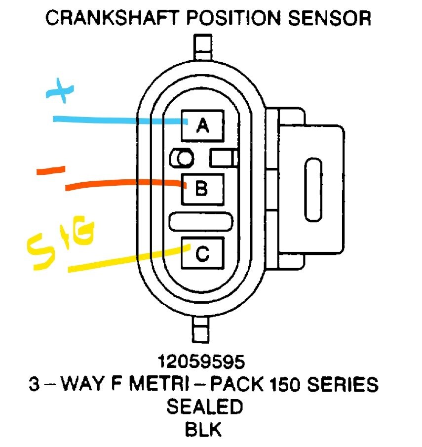

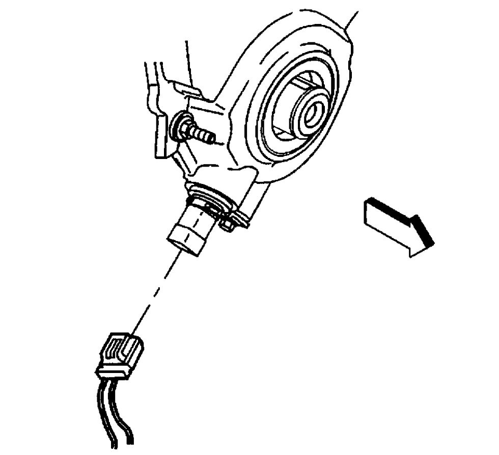

For the injectors just use a test light connected in place of the injector. It should flash if they are getting power. If you have a way to check the timing those engines have a bad habit of eating the crank sensor mounted on the front of the engine, they fail but don't set any codes.
+1
Saturday, May 27th, 2023 AT 5:18 PM
BRIAN333
  • 99 POSTS

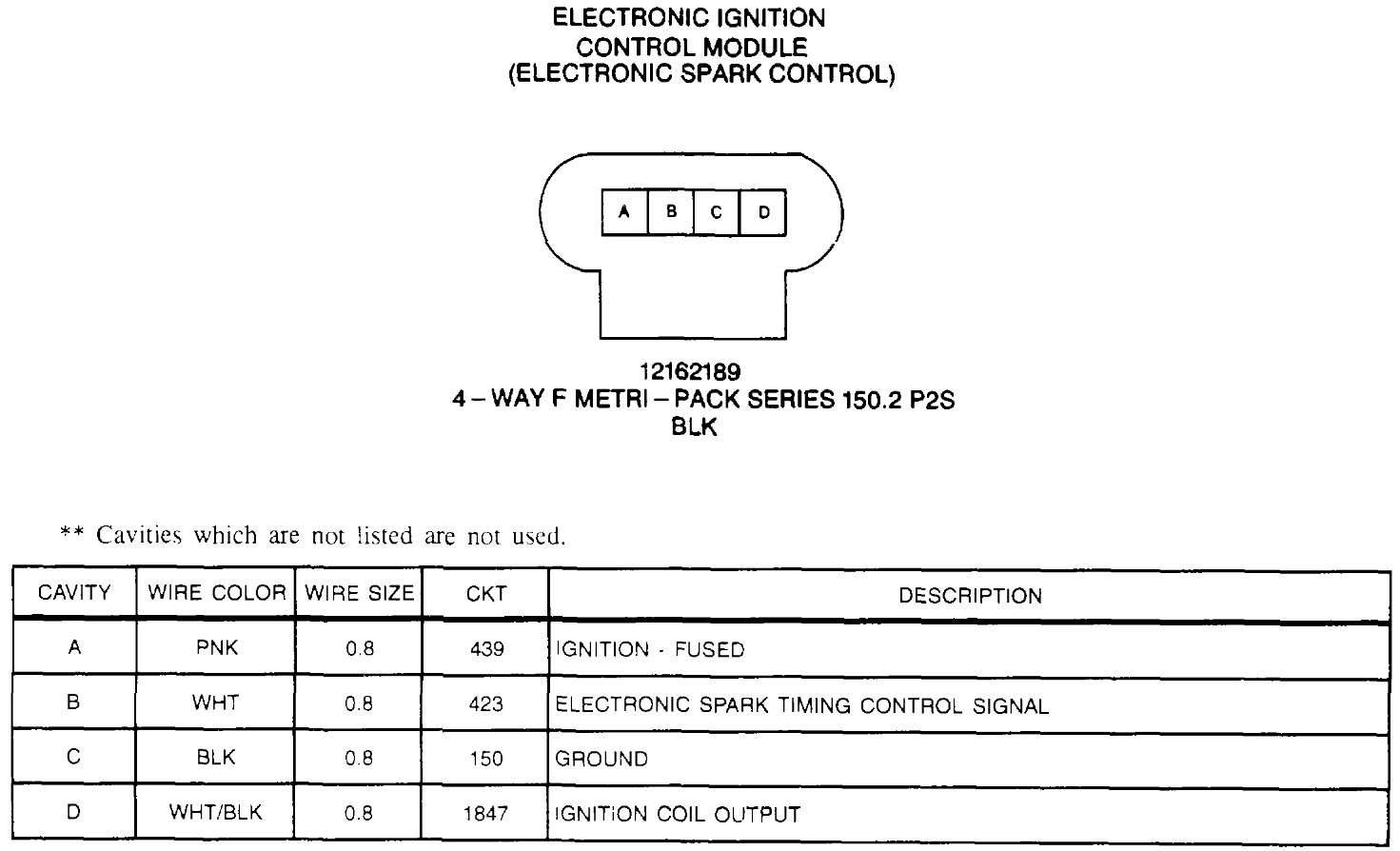

Thanks Steve, I replaced the crank sensor and have the same results with the new one as the old one, so I put the old one back in. I got a code p1361 which says ignition control module, I'm fixing to put a new one on in a minute, but I am getting spark so I’m not sure if this has anything to do with timing, but I’ll find out shortly. From day one I’ve gotten a throttle position sensor code, it’s been cleared many times along with other random codes I created along the way to make sure my reader was working, I’ve put in a new one and the old one back in a couple times and this code refuses to go away, any thoughts?

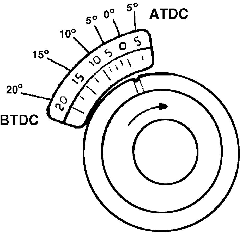

Pretty much nothing built after 94-95 has adjustable timing. The ECM does it all. From everything so far, I'm going to say it's an ignition issue. Get an old-style timing light and use it to check the timing on number one. See what it shows. Might not be a bad idea to move it to different cylinders just to be sure that the distributor is turning.

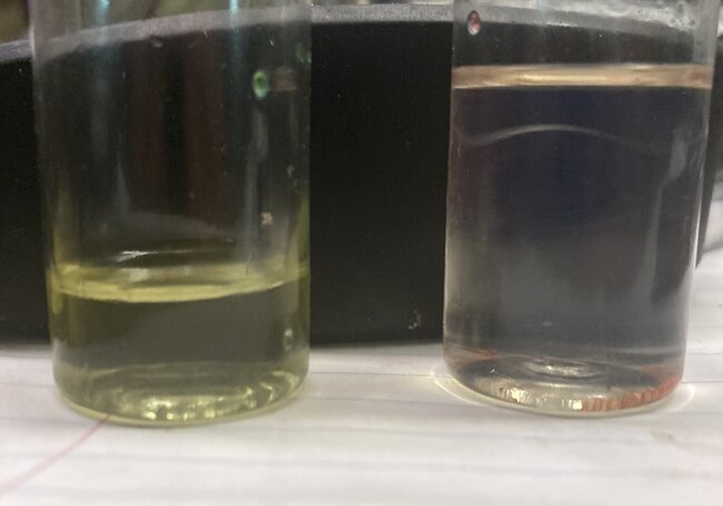

I can appreciate that for sure, but I have between 1/4 and 1/2 tank. I took some gas out to see if any water was present but it doesn’t appear to be, I even split the sample and added water just to compare and it doesn’t appear to be compromised, I’ll send a pick of the fuel that came out of the truck compared to fresh from the gas station when I’m done here. I don’t have any experience or explanation for my plugs being so wet with gas, I’m figuring that is why it won’t fire. I used an inline spark tester and it showed all 4 plug wires I tested (out of 6 of course) and I even watched the spark arc to a bolt with a screwdriver in the wire and it looks pretty good. What should I be looking at in the morning?
Monday, May 29th, 2023 AT 8:40 PM
BRIAN333
  • 99 POSTS
One on left came out of my truck.
Monday, May 29th, 2023 AT 8:41 PM
STEVE W.
  • 15,679 POSTS
Toss some on a paper towel and see how it lights up with a match. Almost looks like diesel but you would know by the smell.
+1
Monday, May 29th, 2023 AT 9:02 PM
BRIAN333
  • 99 POSTS
Funny how you think things look normal until you have something to compare it to!
Definitely gasoline, I’m looking forward to the fire it up and see if it burns test in the morning. Thanks again for all your time and input.
