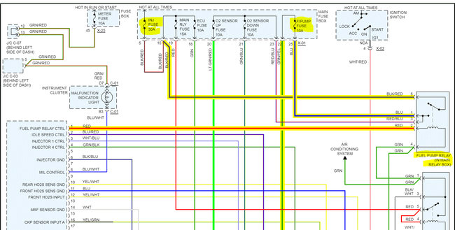

Are you able to hear if the fuel pump primes for a couple of seconds when the key is first turned on? If not, then you really should perform a fuel pressure test. You will need a fuel pressure gauge, but most parts stores will lend one to you. Here is a link that explains how it's done:
Now, if you don't hear the pump and there is no pressure to the engine, we need to determine if there is power going to the fuel pump. Although the fuse is good, we can still lose power at other places.

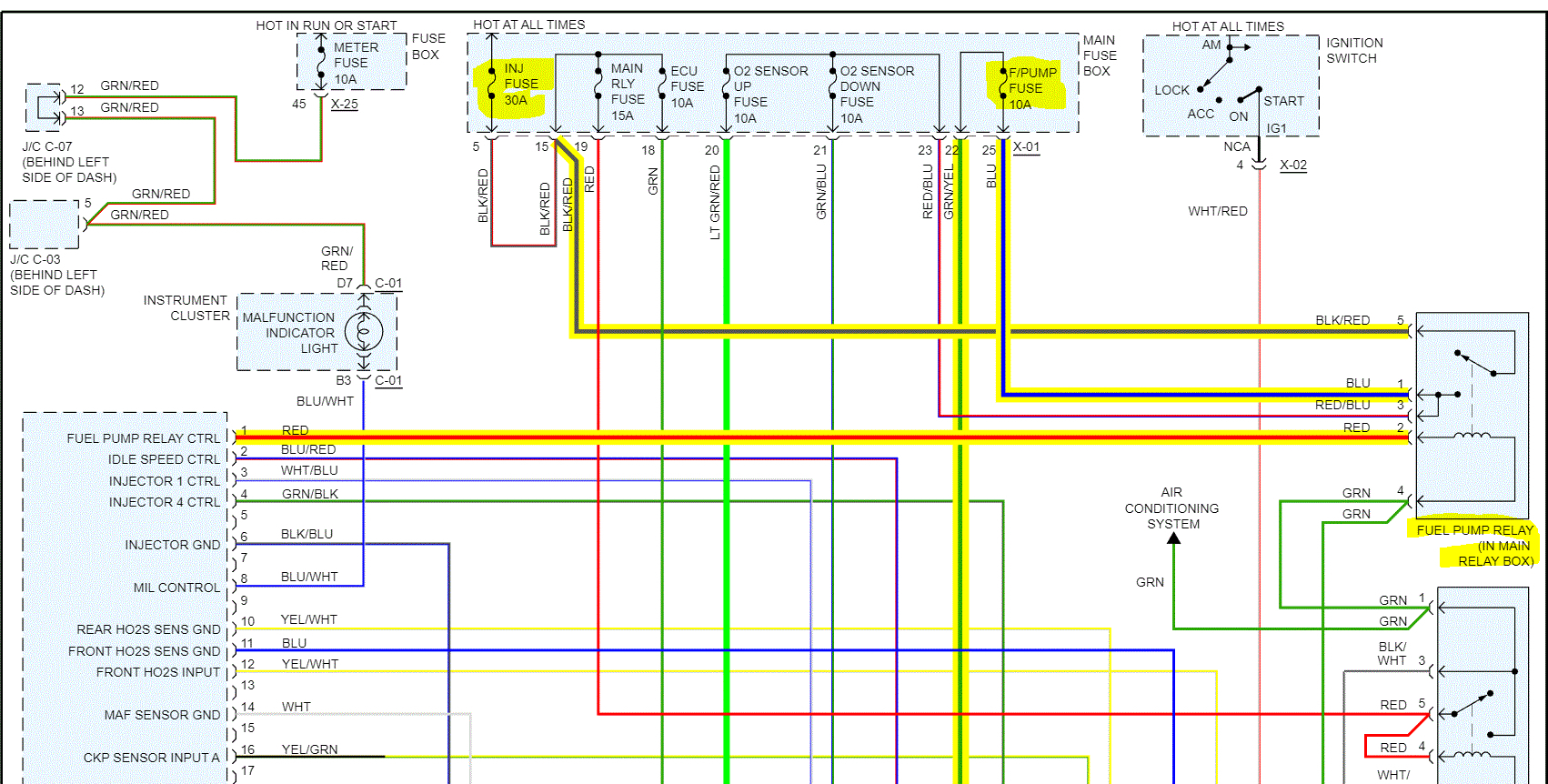

There are two fuses of interest. One is for the fuel pump and the other is for the fuel injectors. Here is how it works: When the fuel pump should turn on, the ECM sends power to the fuel pump relay primary circuit which energizes the coil in the relay. This closes the switch in the relay allowing power to flow from the fuel pump fuse to the pump.
So, I need you to check both fuses. Note that the 10-amp fuel pump fuse will only have power when the relay is energized. The 30-amp fuse should have power with the key in the on position.
In addition to checking the condition of the fuses, make sure there is power to and from therm. Here is a link you may find helpful:
If they are good, remove the fuel pump relay and switch it with a different relay in the box having the same part number. If there isn't one, here is a link that explains how to test a relay:
I attached the schematic related to the fuel pump for your reference.
See pic below.

I did not make it to a parts store to borrow a fuel pressure tester, but I did get a new battery for my VOM. So, I checked the fuses and found the one 15A that was labeled fuel pump. It was black on both sides so I could not see if it was burnt or not, but I went ahead and changed it. I checked the voltage at the pump connector, and it was 12+ with the key on. I still cannot hear or feel any sound or vibration from the pump when cycling through the second key on-off several times. But when I checked the output to the engine side of the fuel filter by disconnecting the fuel line after a period of on-off and trying to start the engine the line had fuel in it. I have not gotten fuel out there before. The problem is I have to walk to an auto parts store about 5+ miles from me. At 80 years old in this heat wave that is a bit too much. I had a friend let me use jumper cables to do the above ignition on off and try to start. I still do not see any air type value on the fuel intake area. My friend will come by later this week on his day off. Is there anything I check in the meanwhile? Thank you, James

We need to determine if the new fuel pump has power to it. Have you checked the fuse and fuel pump relay that I mentioned in an earlier post?
If you have and they are all good, we need to check for power at the fuel pump. At the pump, there is a green wire with a yellow tracer. That will have power for only a couple of seconds when first turning on the key to start the vehicle, so you will need a helper to do this.
Also, there will be a black wire that is for ground. If you find there is power to the green/yellow wire, then you need to confirm continuity to ground on the black wire. If there is continuity and there is power, you must have gotten a bad pump.
Do me a favor. In addition to checking the black wire for continuity to ground, locate where it grounds at the right rear of the vehicle and make sure it is in good condition.
