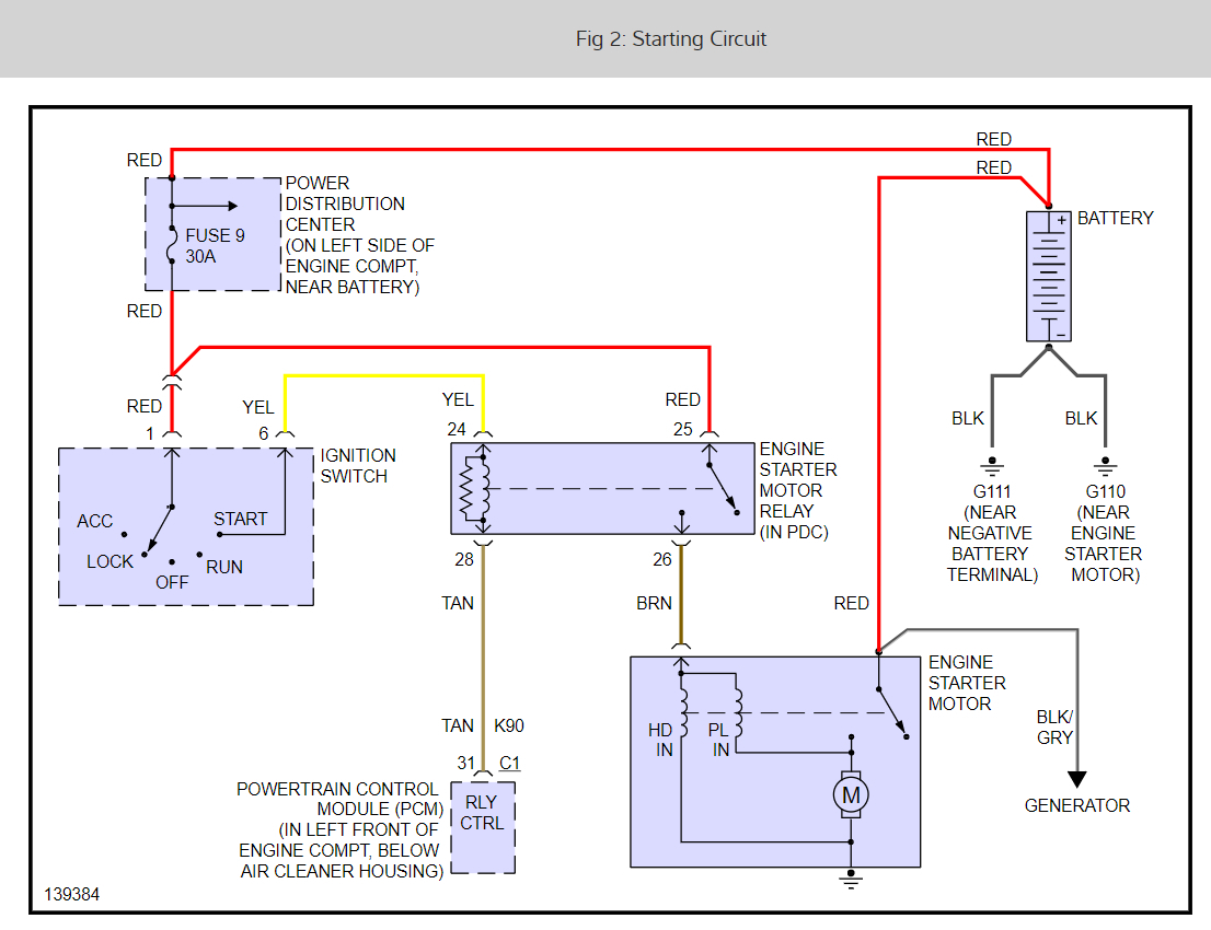

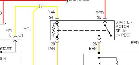

turn the ignition key and I get nothing ?
2003 DODGE NEON
82,000 MILES • 4 CYL • FWD • AUTOMATIC
CKOPCZYNSKI

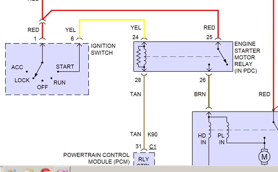

I turn the ignition key and I get nothing why?
Jan 21, 2010 at 11:09 AM
JDL
  • CAR REPAIR CONTRIBUTOR
  • 16,098 POSTS
This sounds like the starter is having problems or the battery needs to be load tested these guides can help us fix it. https://www.2carpros.com/articles/starter-not-working-repair and https://www.2carpros.com/articles/car-battery-load-test Please run down these guides and report back. I'd make sure the battery has a full charge and the connections are good. Next, I'd check the voltage circuits at the starter relay, in the power distribution center, under the hood. Also, your theft/security system might cause an issue? Did you try cranking in neutral?
https://images.2carpros.com/forum/automotive_pictures/170934_03_dodge_neon_starter_circuit_1.jpg

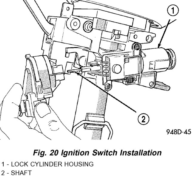

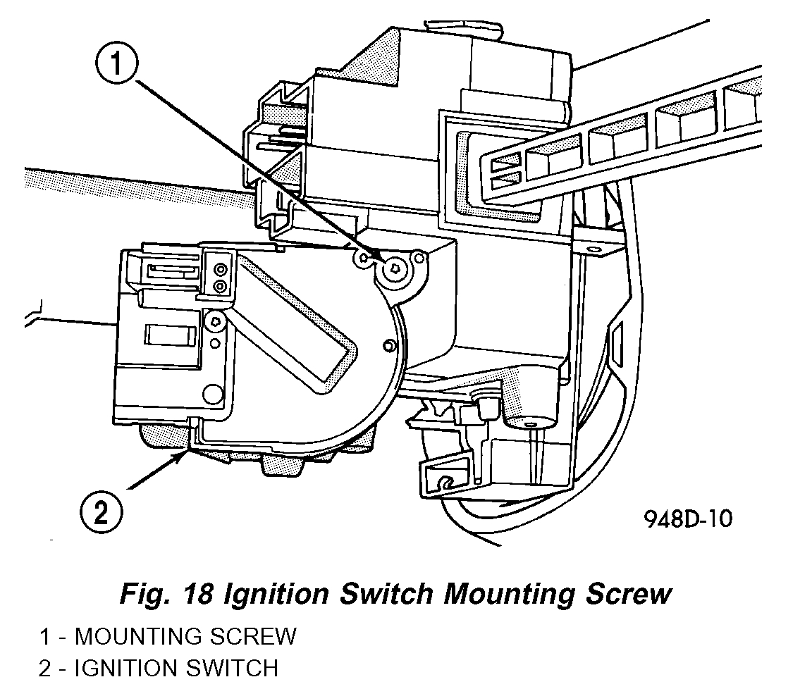

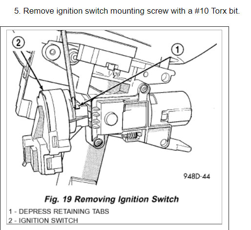

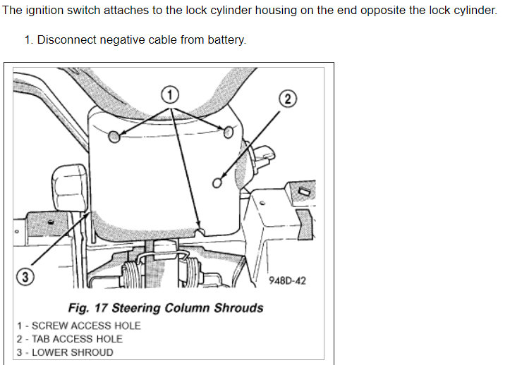

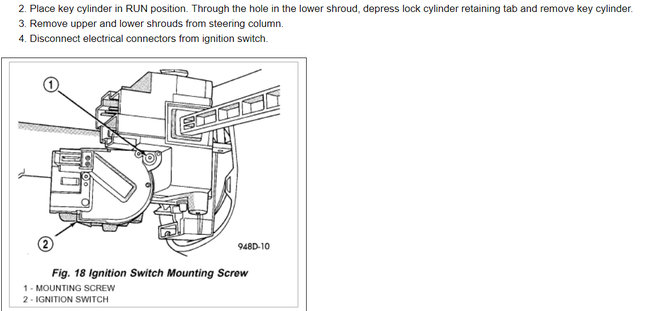

The key does have a transponder in it, but the anti-theft or security light will flash or illuminate if the transponder is bad. If that is not happening, I question the ignition switch itself since you mentioned it catches at times. First, the ignition switch is not part of the cylinder where the key goes. It is an electrical device located in the steering column. There is a shaft which is moved when you turn the key which engages it. I hate to suggest this and be wrong, but you may want to inspect it to determine if something is loose and not allowing the shaft to properly engage the switch.

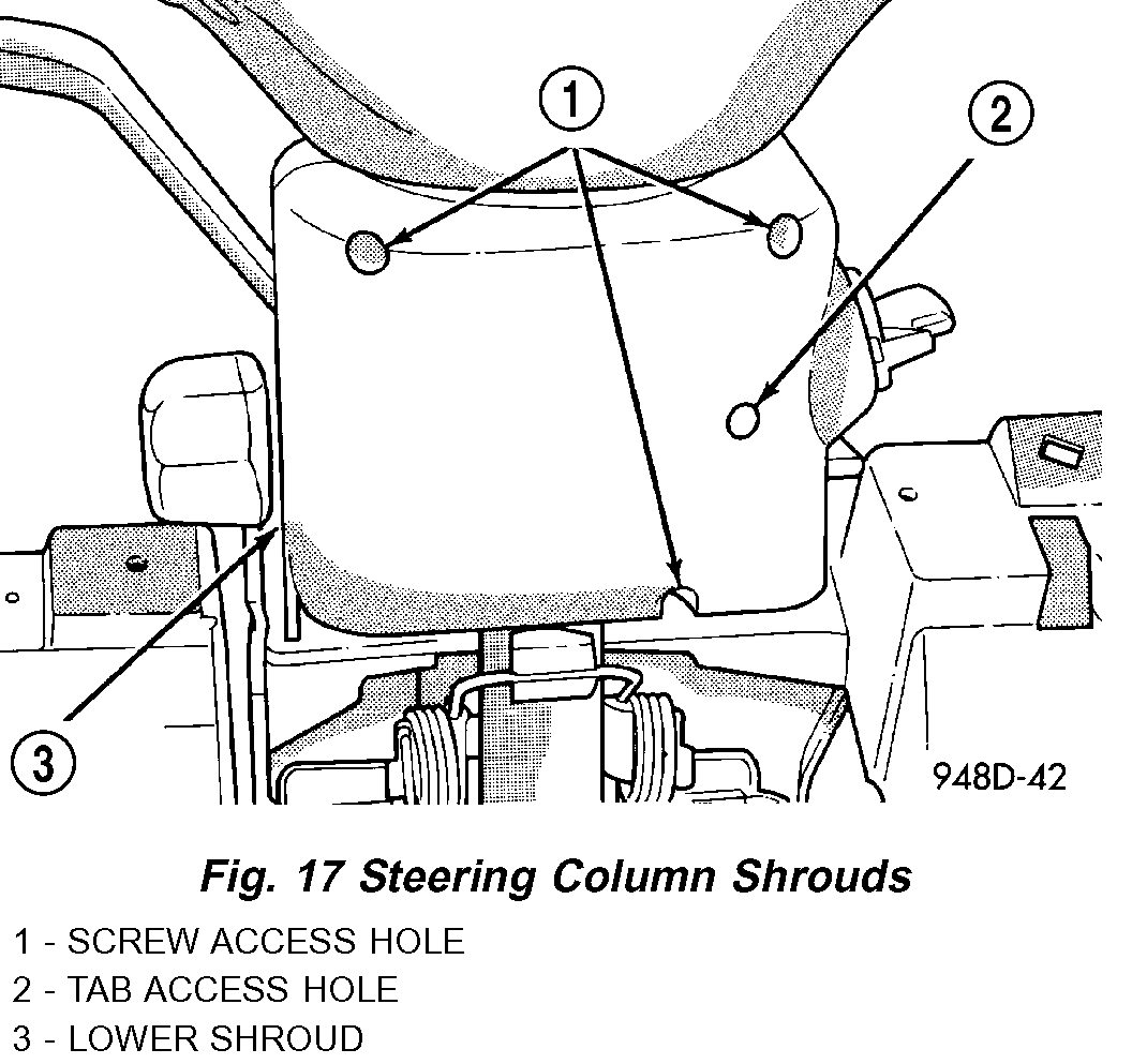

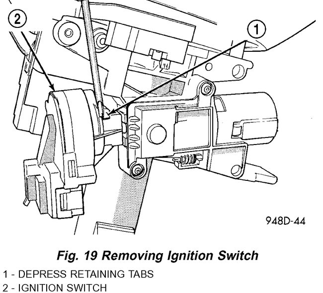

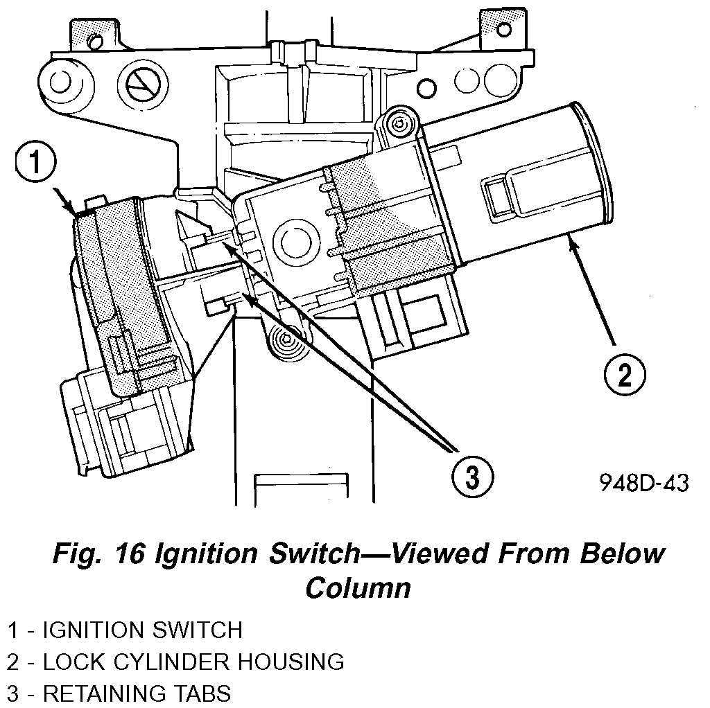

Here are directions for removal and replacement of the switch. I am not saying to replace it, but the directions show how to access it and work on it. The attached pictures correlate with these directions.
_____________________________________________

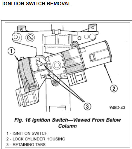

IGNITION SWITCH REMOVAL
The ignition switch attaches to the lock cylinder housing on the end opposite the lock cylinder.
1. Disconnect negative cable from battery.
2. Place key cylinder in RUN position. Through the hole in the lower shroud, depress lock cylinder retaining tab and remove key cylinder.
3. Remove upper and lower shrouds from steering column.
4. Disconnect electrical connectors from ignition switch.
5. Remove ignition switch mounting screw with a #10 Torx bit.
6. Depress retaining tabs and pull ignition switch from steering column.
INSTALLATION
1. Ensure the ignition switch is in the RUN position and the actuator shaft in the lock housing is in the RUN position.
2. Carefully install the ignition switch. The switch will snap over the retaining tabs. Install mounting screw.
3. Install electrical connectors to ignition switch.
4. Install upper and lower shrouds.
5. Install key cylinder (cylinder retaining tab will depress only in the RUN position).
6. Connect negative cable to battery.
7. Check for proper operation of ignition switch and key-in warning switch.
_____________________________________________________
I hope this helps. Let me know your thoughts or questions.

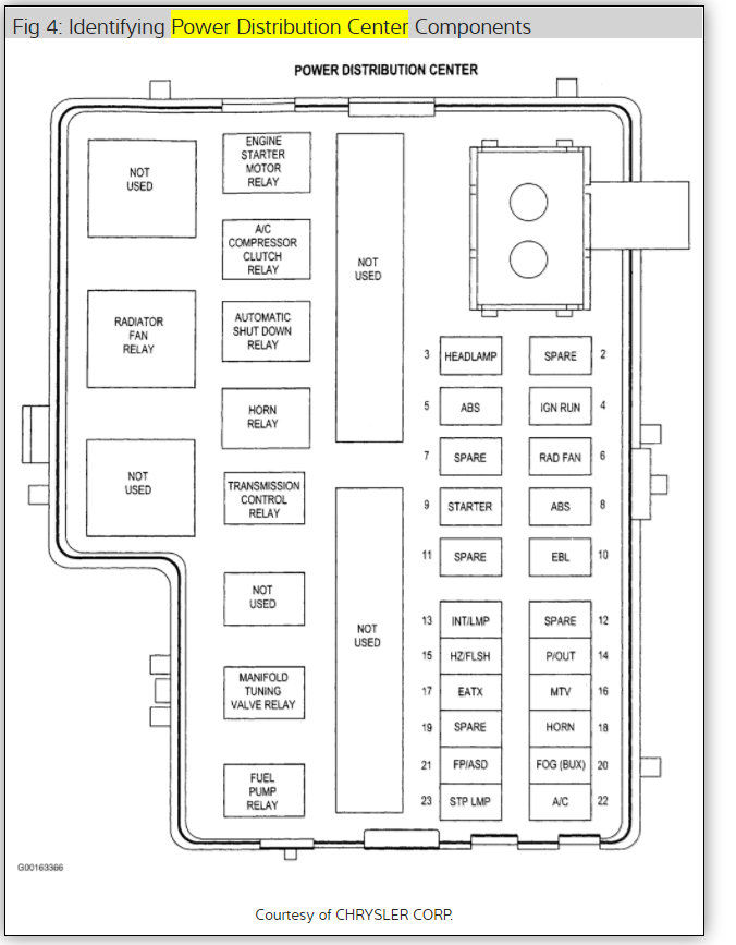

The car will not crank. I checked the fuses and the relays; it appears they are all good. I jumped terminal 30 to 87 on the starter relay and the starter engages, There is power to terminal 86 when I engage the ignition to crank. There is no ground at terminal 85. I checked the center post of the neutral safety switch and I have continuity to the transmission case. When I turned the key to the on position and jumped the starter it would crank but would not start. I tried the key dance to pull possible codes; I got nothing and the check engine light does not illuminate when I turn the ignition to the on position. What would you suggest is my next step to diagnose the problem?
Apr 15, 2021 at 6:56 PM (Merged)
HMAC300
  • 48,601 POSTS
ok I have adiagram now check fuse 9 under hood then where yellow wires enter should be on when you go to start then brown wire is activated for pcm finally to starter. If you hear clicking at the starter hit the body of starter with a hammer if it starts you need a starter.
BSKT
To clarify, it was the starter relay thank you

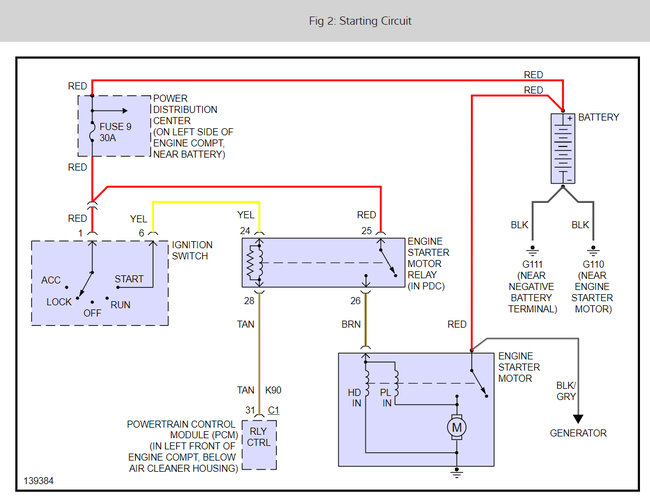

Will check the solenoid wire tonight. Checked the solenoid wire. No power when in the start position. What role does the PCM play at this point? I just noticed the idle control valve is making a buzzing sound. Can reset it by unplugging the connector and plugging back in. Do not think this could cause a no crank situation?
Double checked all the circuits. Twelve volts at the starter relay pin 30 and 86 when in start position. Have ground at pin 85, so unless the idle control valve can cause a no crank I will have to trace the solenoid wire. Thanks for the help so far.

We are loosing power somewhere here is a guide and a starter wiring diagram so you can test where the power is being lost.
KRHODES11
  • 10 POSTS
Was away for a bit and got back to the vehicle last night so late in replying.
Traced the solenoid wire, no shorts or grounds, and verified continuity...all good.
Went back and checked starter relay circuitry.
12v at pin 30 and 86 when cranking but now no ground at pin 85 from PCM?

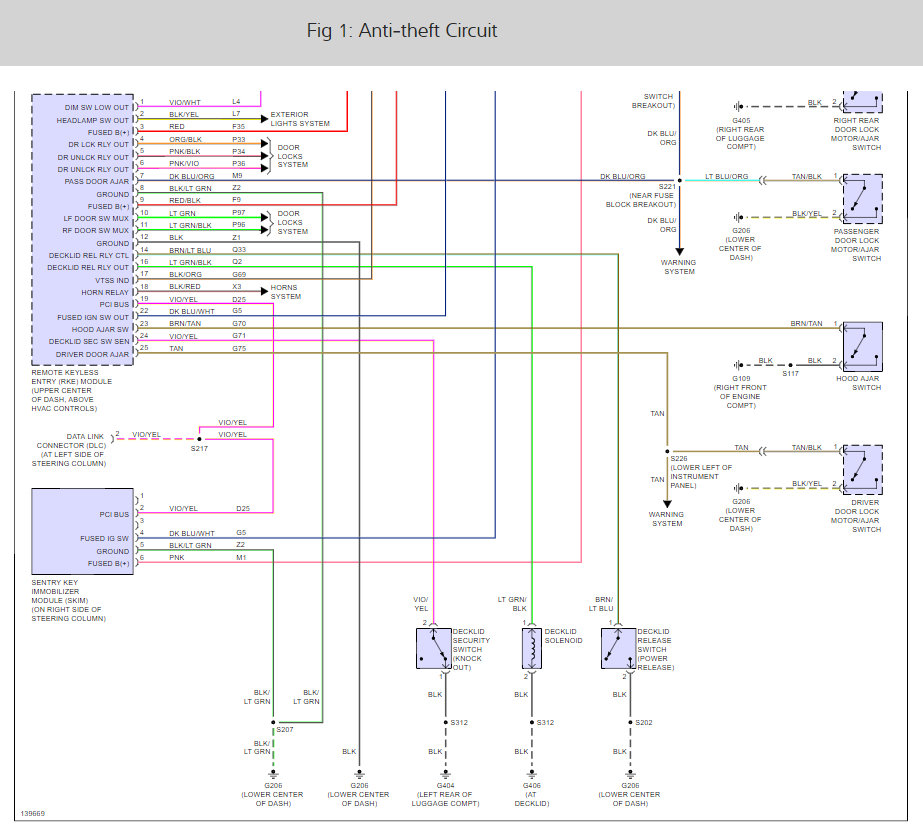

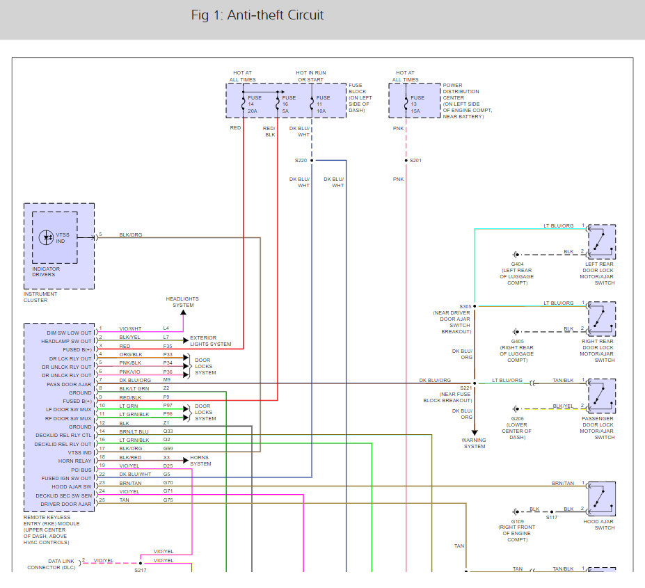

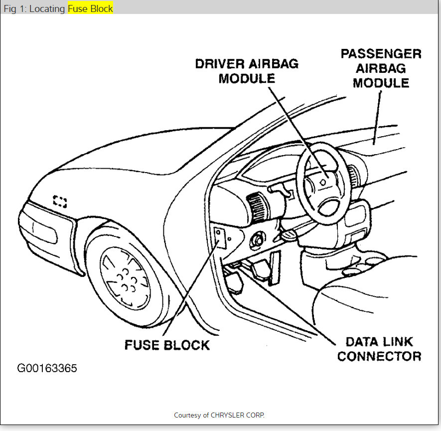

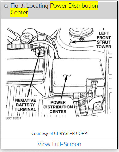

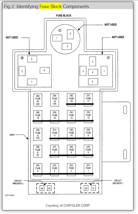

The car does have a security system here is the wiring diagrams for it. I would check fuses #14, 11, 16 and 13.
Check out the fuse panel diagrams (Below)
KRHODES11
  • 10 POSTS
This particular model does not have a security system.
It was an option in 2001. Has a black key with no chip.
All fuses check out ok in both the under hood power distribution center and the interior fuse box.

You cant see the chip of it had one because it is inside the black part. Anyway so no security light comes on.
If you checked the wiring diagrams above then the only thing left is the ignition switch lets test it here is the wiring diagrams. Use the guide from about to see if you power in and out of the switch.
Please let us know what you find. (below)
KRHODES11
  • 10 POSTS
Thanks, Ken. Appreciate all your help. I replaced the ignition switch and it has good power in and out, and power to pin 86 of the start relay when in the start position. The vehicle had an aftermarket front door remote lock system installed. Beginning to think that might be the problem. I can't find the brand name and the owner doesn't have the paper work so haven't been able to find schematics to troubleshoot. The relay bank is connected to the yellow ignition switch wire, and that circuit appears to be working up to the start relay so don't think disconnecting will yield any positive results? Is it possible it could be preventing the PCM from initiating the ground to engage the start relay coil? This one has been quite the challenge.

All the troubleshooting kept pointing to the pcm. Replaced it with refurb. Vehicle started and running great now. Learned a bunch on this one. Thanks for all your help.
