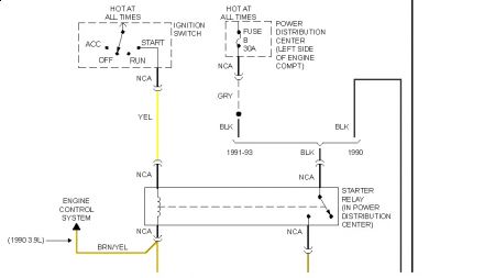

JBRAVO69
  • 8 POSTS
new starter,battery,ignition switch, checked all wires and all grounds,fuses,relays,all seem good wont turn over no click nothing any ideas???
Jan 13, 2020 at 10:37 AM (Merged)
DOCFIXIT
  • CAR REPAIR CONTRIBUTOR
  • 18,828 POSTS
Was neutral safety switch checked out?
this guide will help us

At starter relay is there 12v on black wire?
JBRAVO69
  • 8 POSTS
yes at the relay is a yellow(switch) brown(power) and a brown/yellow(ground/neutral safety) and a black that ends in the harness if i take out the relay and swap it out with any of the other 3 relays(all the same) i get nothing , but if i take out the relay and run a jumper from the brown to the yellow it starts now aint that a ass scratcher?? any ideas i`m going bonkers here! thanx
DOCFIXIT
  • 18,828 POSTS
O.K. then when key in start position does yellow wire have power?
JBRAVO69
  • 8 POSTS
yes
DOCFIXIT
  • 18,828 POSTS
What about Black wire does it have 12+ volts
JBRAVO69
  • 8 POSTS
brown wire does black wire goes nowhere
DOCFIXIT
  • 18,828 POSTS
There MUST be voltage on black that is what powers solenoid. it should go to fuse"B" in PDC

Don't know who has been working on truck brown wire should go to starter solenoid, black wire hot, yellow hot with key, Brown'yellow ground. Yellow powers uo coil closes relay black wire feeds brown to close solenoid. When you say Black wire goes no where what just hanging?
Jan 13, 2020 at 10:38 AM (Merged)
JBRAVO69
  • 8 POSTS
yes looks like it was cut with a coupla others and taped up back in the harness going to nothing. had the truck for 7 yrs never done anything to it but routine maintenance til now. never had any issues whatsoever, my son was listening to the radio in it and ever since it hasnt started, unless i run a jumper wire from the yellow to the brown in the PDC and it will start.....
DOCFIXIT
  • 18,828 POSTS
Wire up black wire to power then it should start
JBRAVO69
  • 8 POSTS
wired it up and it fired right up! thanx docfixit!!!!! still cant figure out how it started all this time unless there was a power feed on there and it busted or fell off but couldnt find any signs of where it was or should have been oh well the mysteries!!!! THANKS AGAIN DOCFIXIT!!!!

What would cause a starter to bench test fine and then when you put it in the truck it doesn't work at all. I can get it to work by jumping the two terminals on the starter.
JDL
  • 16,098 POSTS
I'd check the voltage circuits at the starter relay. Voltage for the load/switch side of relay, is hot all the time. Voltage to the coil side of relay, goes hot with the key in the crank position.
https://images.2carpros.com/forum/automotive_pictures/170934_dakota_starter_relay_1.jpg
