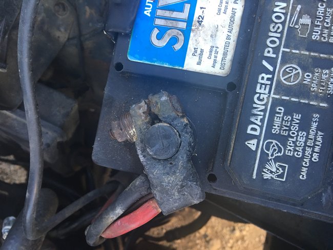

No crank, no start, I did the check engine test where I switch to gear 5 times to get a code and I got a 36 check engine code check flash 3 times then pause then a flash 6 times

Just my opinion, if starter motor won't even crank, I'd test that circuit first. Make sure battery has a full charge and battery connections all good. Usually two hot circuits at the starter motor, one comes from the battery, hot all the time. The other voltage circuit, goes hot with key in the crank position, may be wired through starter relay and neutral switch. I haven't looked at your wiring, yet. The starter housing should ground through engine block. Any testing make sure tranny is in park or neutral and parking brake is set.

Well the battery connectors are a mess
