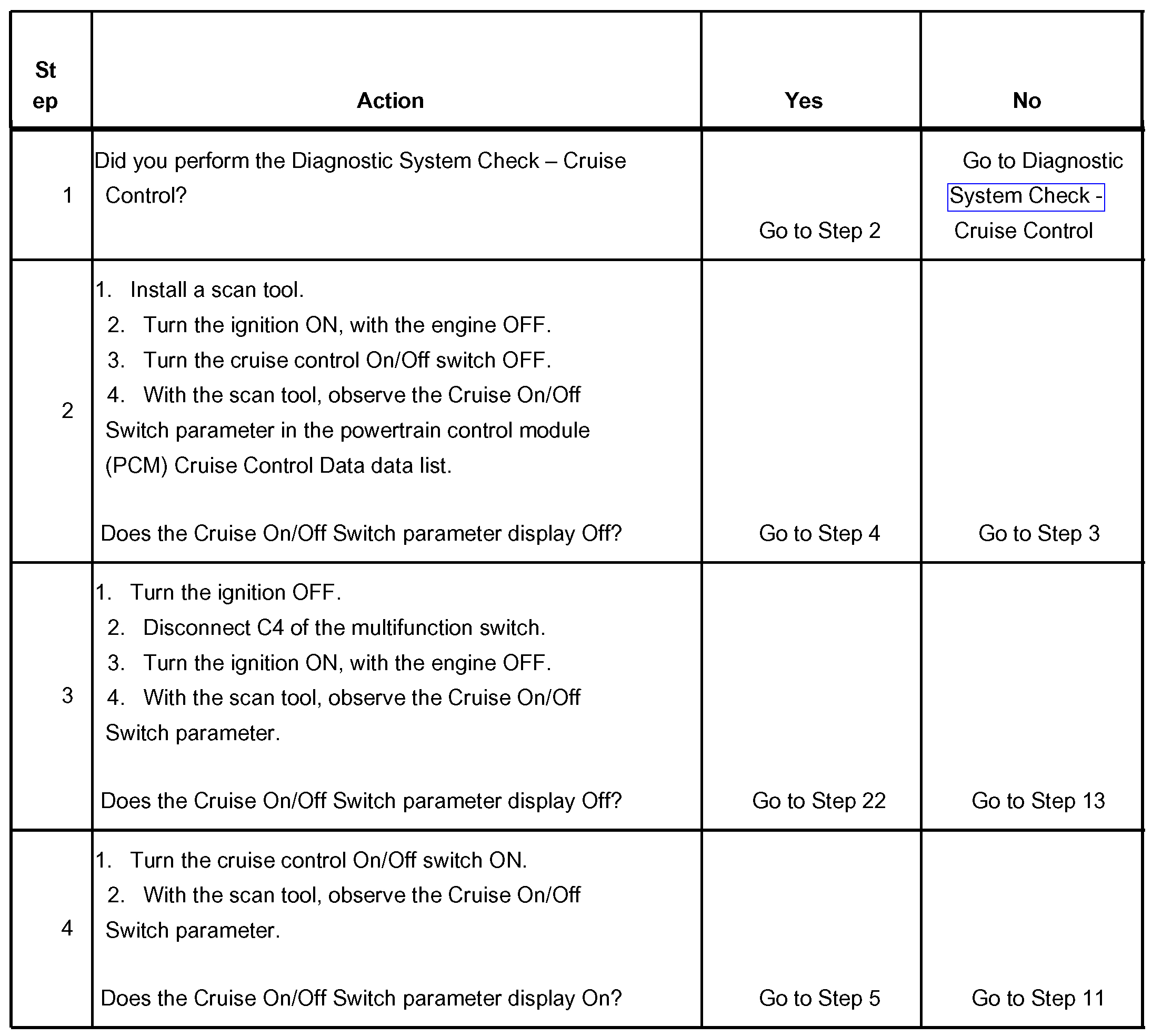

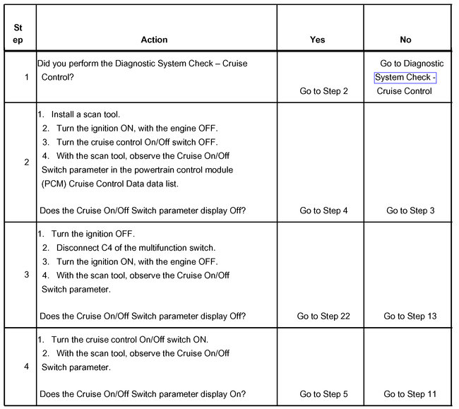

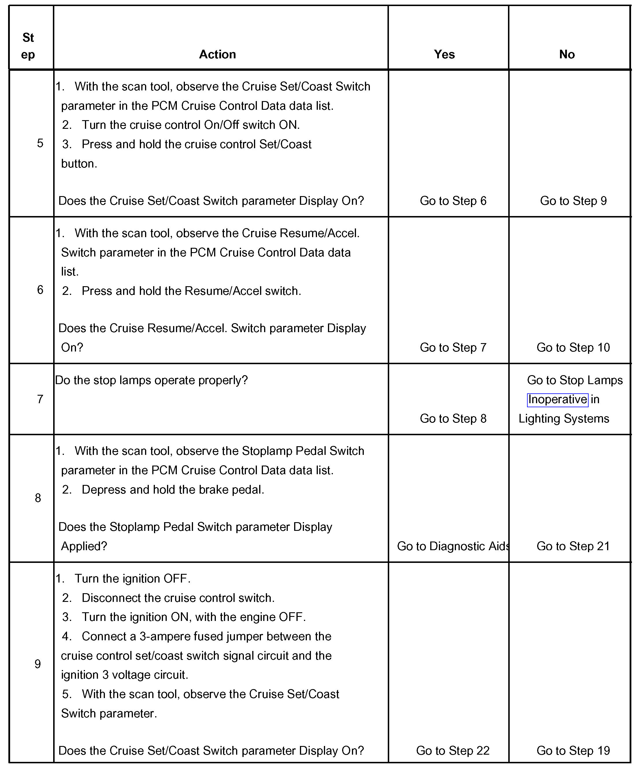

TEST DESCRIPTION
Steps 1-4
see pic 1

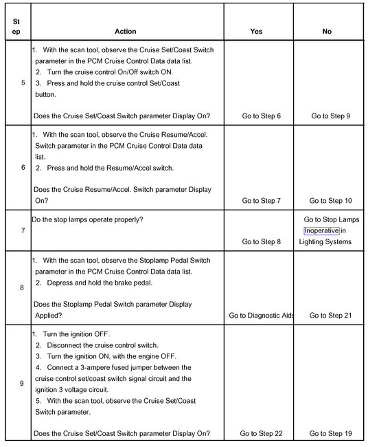

Steps 5-9
see pic 2

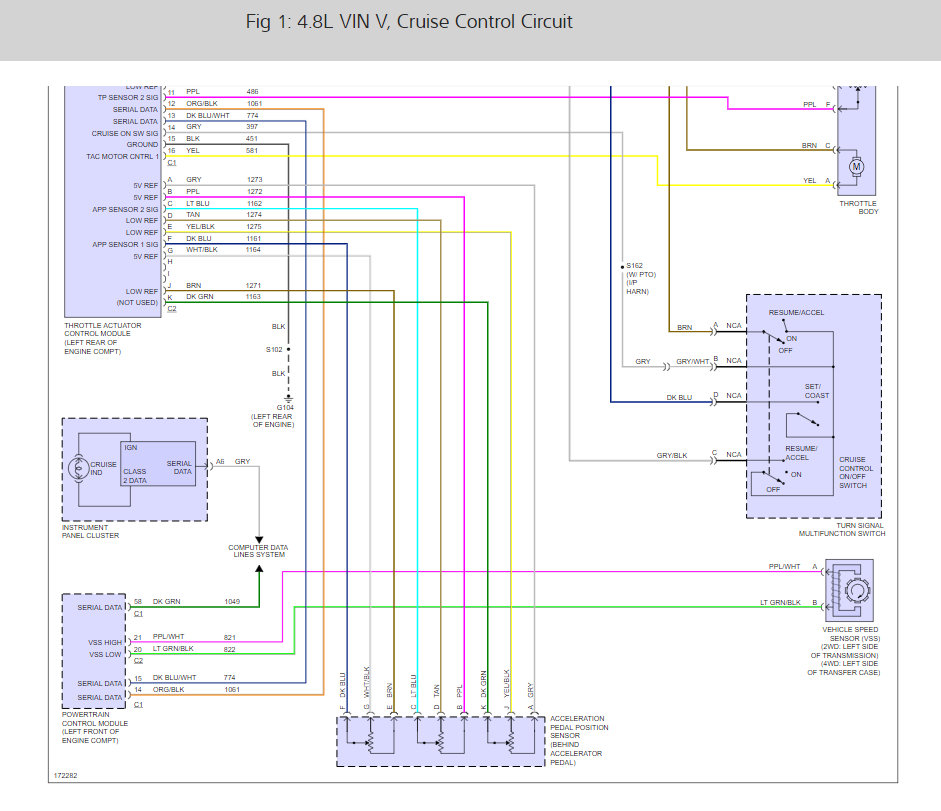

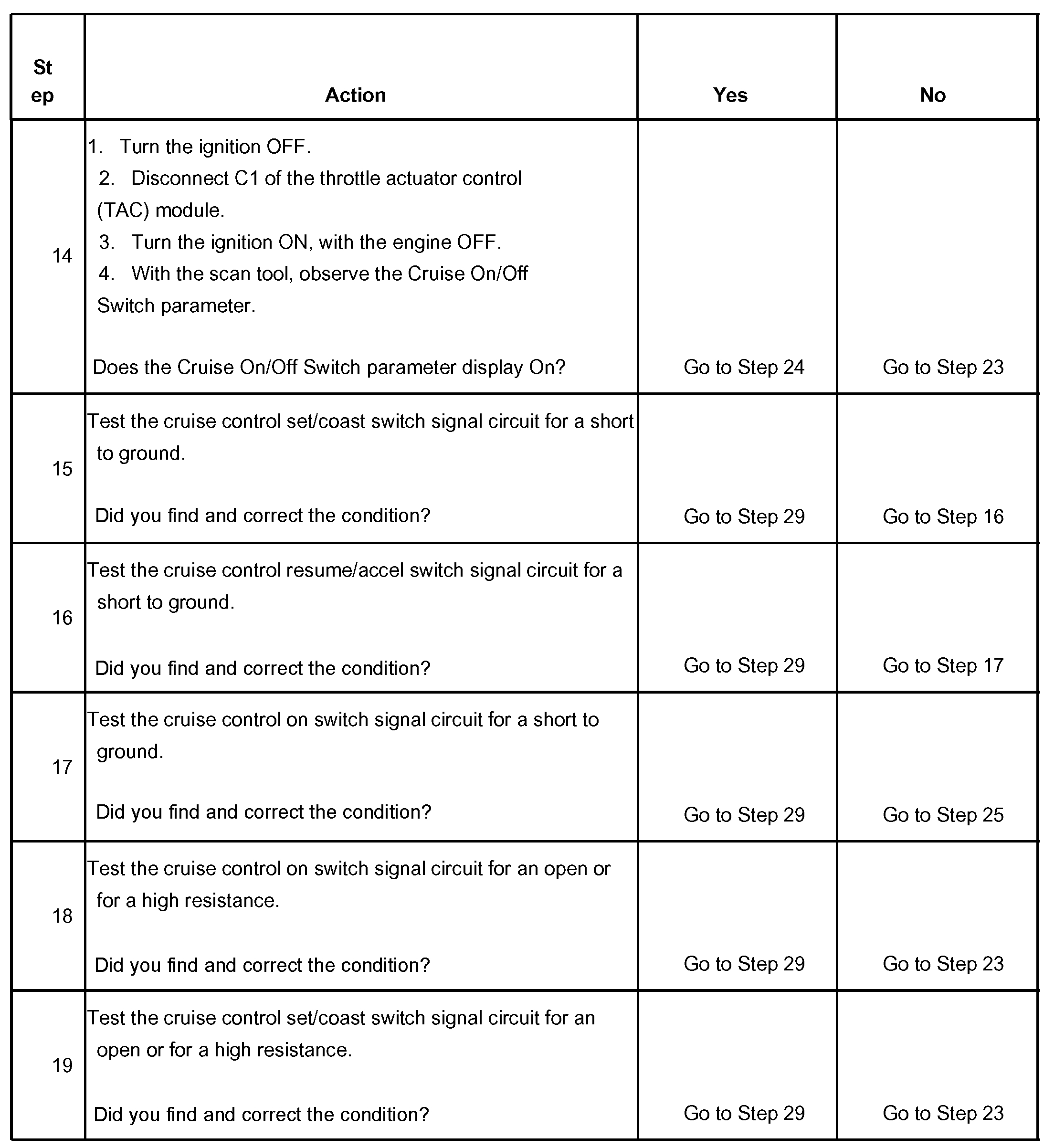

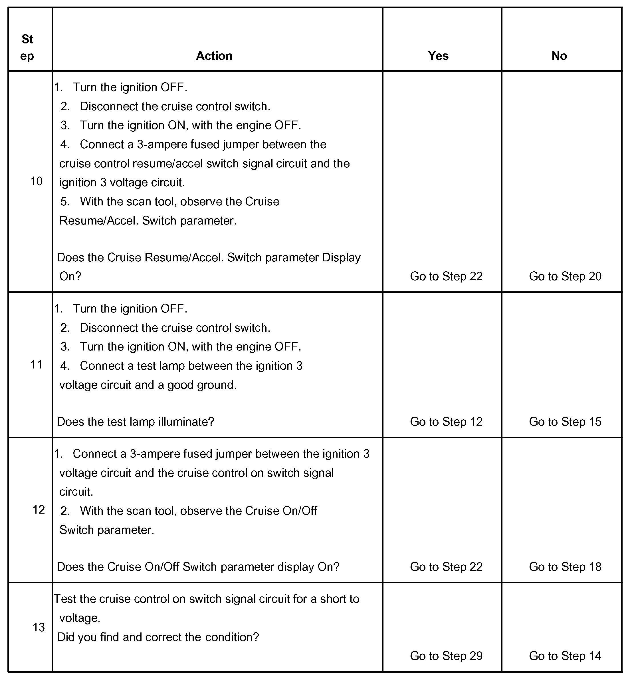

Steps 10-13
see pic 3

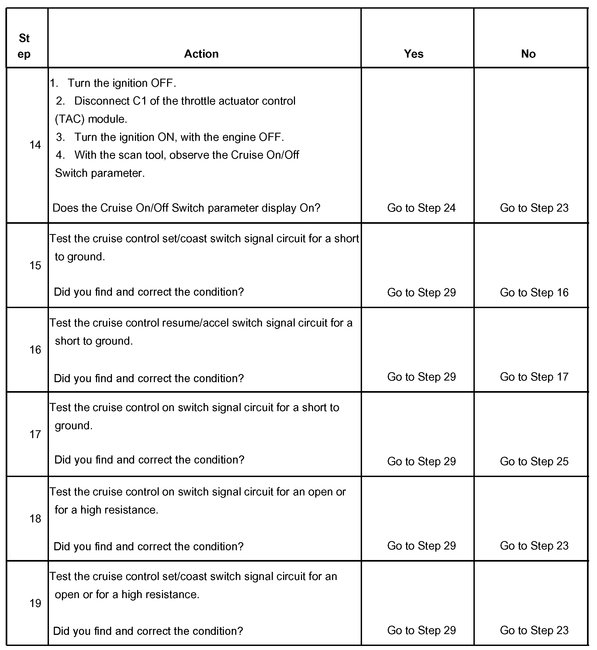

Steps 14-19
see pic 4

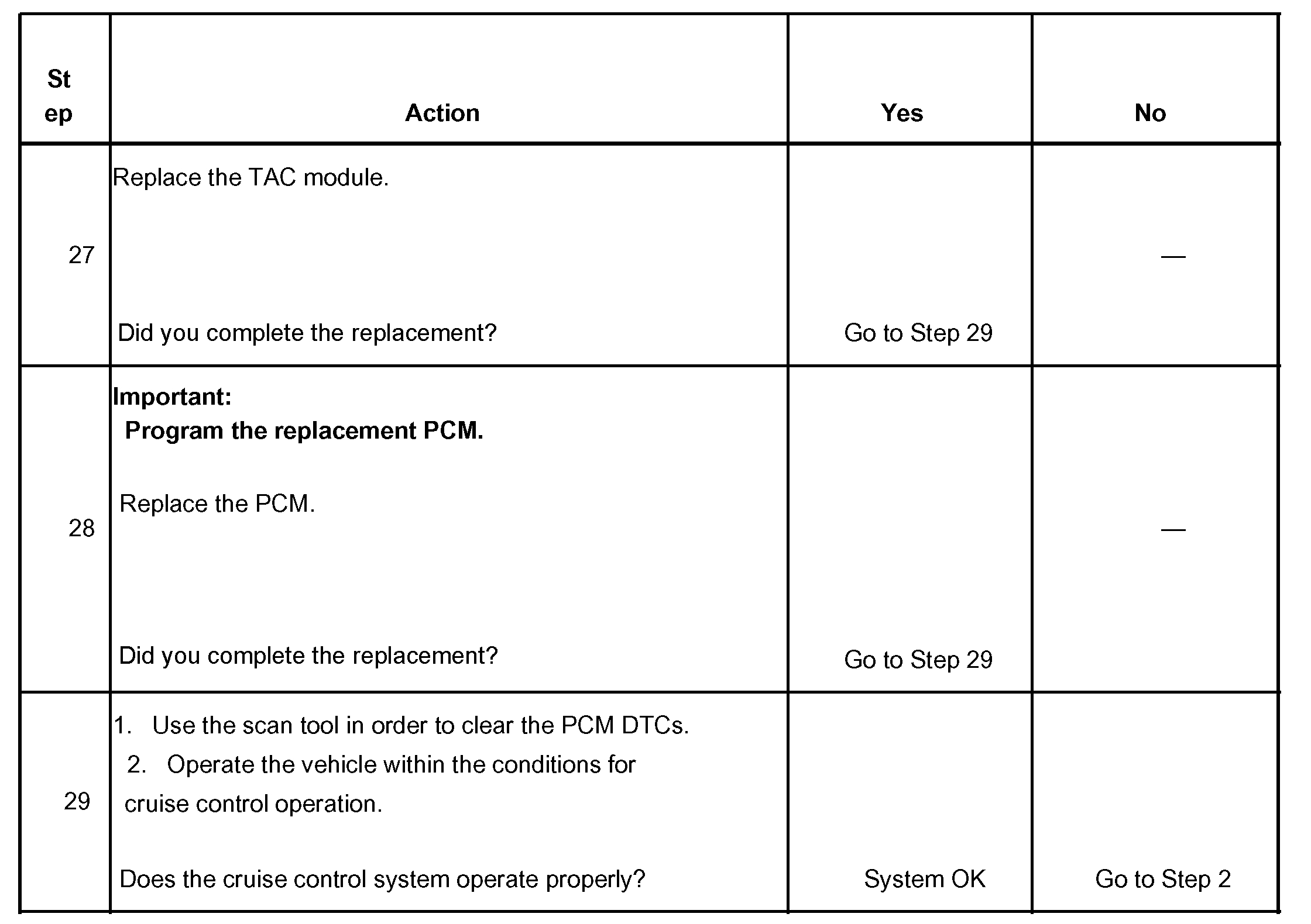

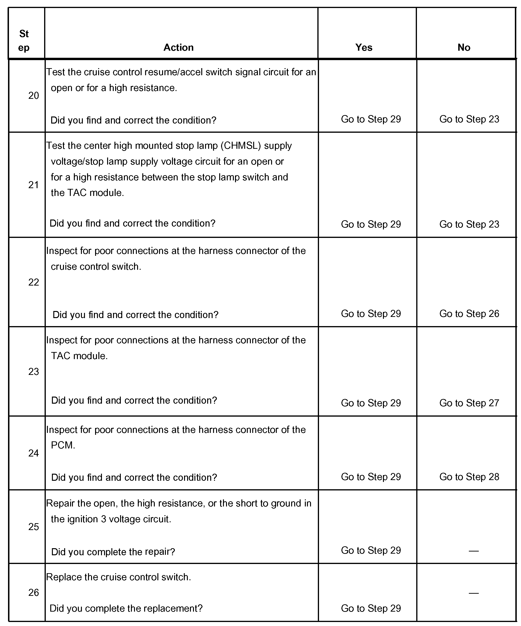

Steps 20-26
see pic 5

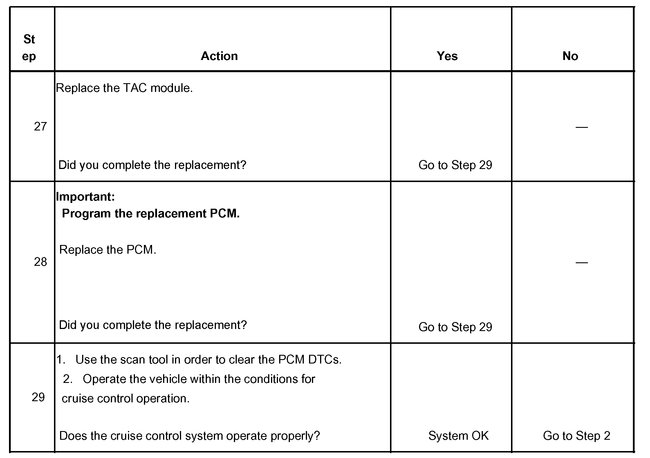

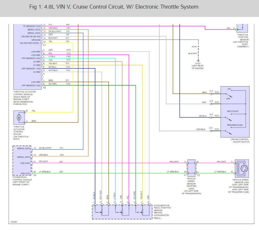

Steps 27-29
see pic 6
The numbers below refer to the step numbers on the diagnostic table.
8. This step tests the center high mounted stop lamp (CHMSL) supply voltage/stop lamp supply voltage circuit for an open or for a high resistance between the stop lamp switch and the throttle actuator control (TAC) module.
9. This step tests the cruise control set/coast switch signal circuit for an open or for a high resistance.
10. This step tests the cruise control resume/accel switch signal circuit for an open or for a high resistance.
11. This step tests the ignition 3 voltage circuit for an open, for a short to ground, or for a high resistance.
29. DTCs will set in the powertrain control module (PCM) when you perform this table.

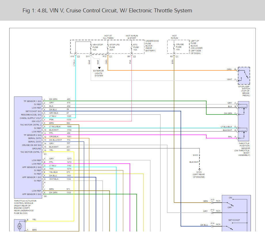

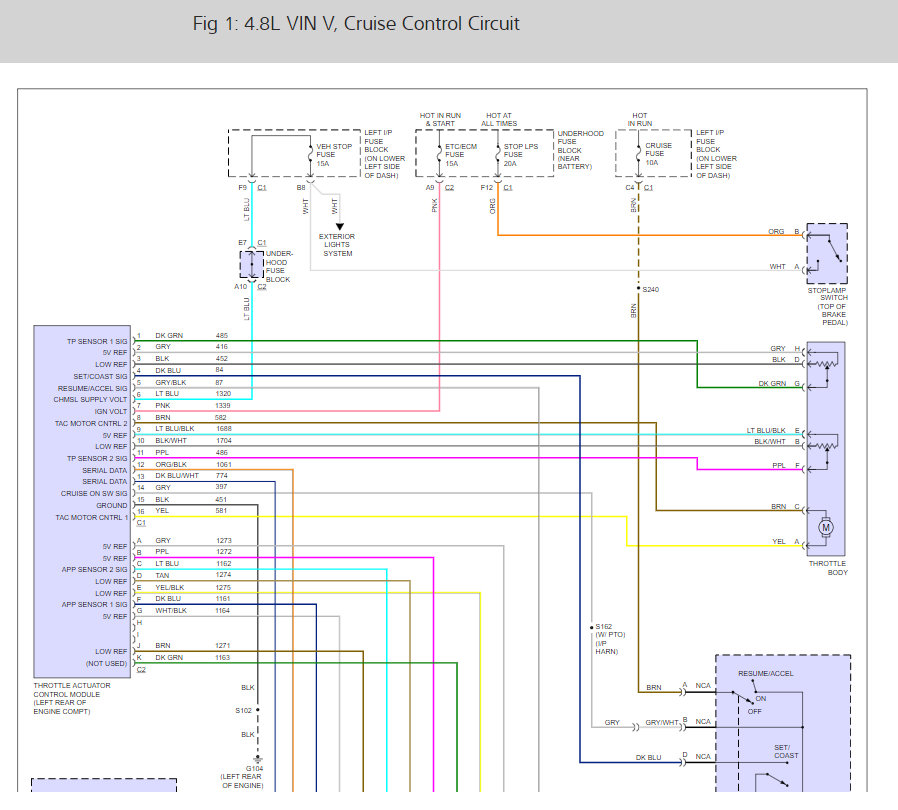

JDL
  • 16,098 POSTS

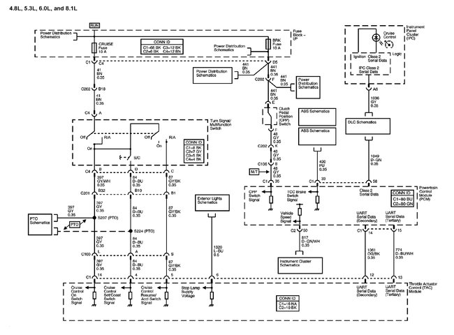

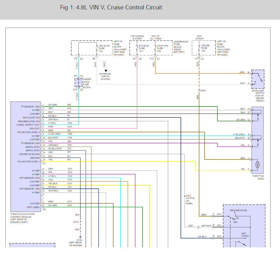

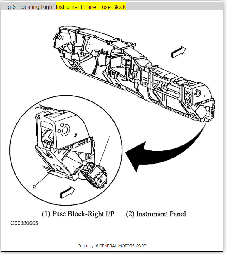

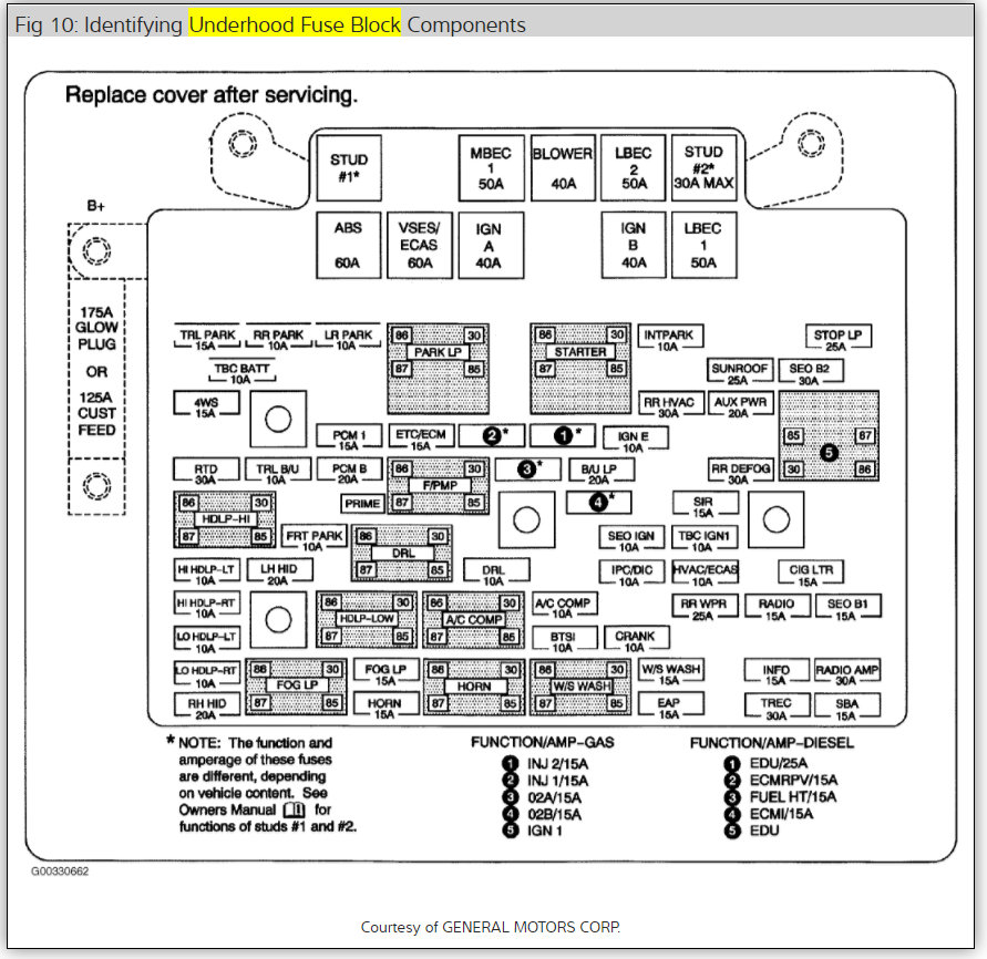

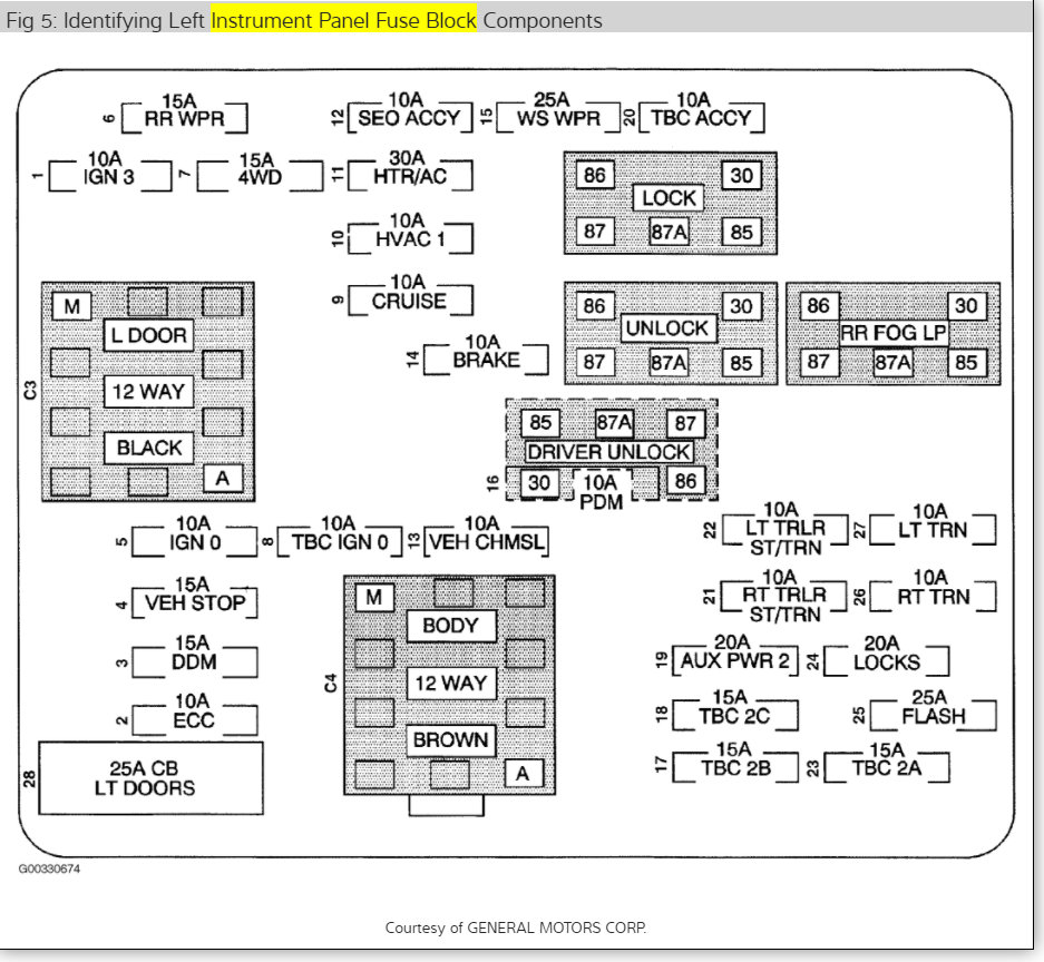

There are 4 fuses that run the system that needs to be checks here is a guide to help you with the fuse location and cruise control wiring diagrams below so you can see how the system works and which fuses to check.
Check out the diagrams (Below). Please let us know what you find.

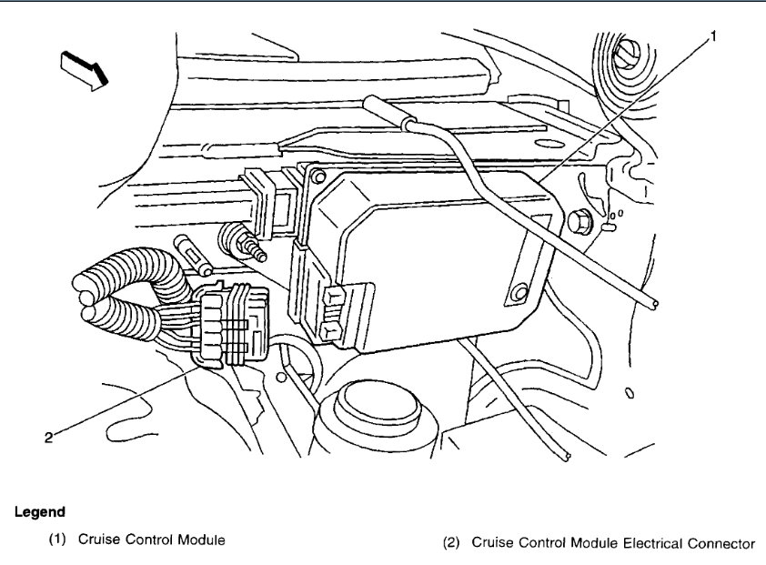

DANNY L
  • 5,648 POSTS
Hello, I'm Danny.
The first thing I would check is the cruise control module. It's located on the left side of the firewall under hood. I've attached a picture below of its location and description. Hope this helps and thanks for using 2CarPros.

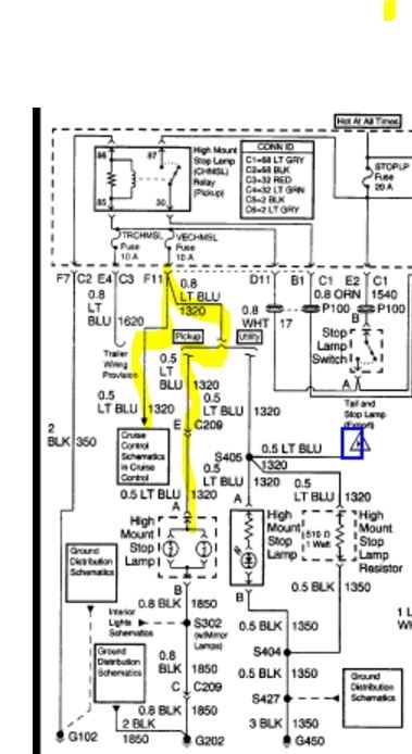

IBHOMELESS
  • 5 POSTS

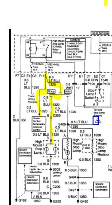

Update:
I removed the hi mount light and tested the voltage to the brake light. The blue wire (which is the one that supplies twelve volts when the brake is pressed) has a constant four volts DC on it when the key is on. I broke the connection to the light assembly to eliminate it and with no load, it still has four volts on it. When the brake is applied, it goes to twelve volts. I need to find out where this stray four volts is coming from.
I am attaching a diagram to illustrate. Since I severed the wire at the light, the only other connection is from/to the cruise control. I have that diagram but they are from different sites and I am not sure where the blue wire comes in yet.
By the way, the cruise worked this afternoon.
More as I find it :)
+1
Wednesday, May 5th, 2021 AT 1:39 PM (Merged)
IBHOMELESS
  • 5 POSTS
Update #2:
I started looking for the four volt bleed and started with the VECHMSL fuse and the TRCHMSL fuse. Here is what I found with my testing.
With the key off, there is no voltage across either fuse, normal.
With the key on there is the four volts I also found at the high mount light.
I then activated the brake pedal with a bar and then re checked the fuses mentioned above. They now have twelve volts on them and the brake lights are on full bright.
I unplugged the new brake light switch but it did not change anything.
Looking at the diagram, it appears my next step would be the hi mount relay (CHMSL). It was getting dark and I was not able to locate it yet.
Got to be there or possibly the multi-function switch?
Anyway, I think I am getting close, hopefully.

CARADIODOC
  • 34,468 POSTS
Without contacting a GM trainer, I think I know what's going on, and I have a solution. If you had the original assembly in there, with its incandescent bulbs, you would not see a problem. I am pretty sure the four volts is normal, thanks to the addition of all kinds of computer circuitry. (This goes back to when I used to install aftermarket cruise control systems in the 1980s). Four volts is being applied to the circuit, then the current flow is monitored to test the bulbs. Actually, the computer is using the bulb circuit as a ground circuit. Applying 12 volts to it removes the ground and is the first backup strategy in cancelling the cruise control operation.
At the same time, the cruise control system gets at least part of its power source from the same circuit that feeds the brake light switch. That is done because it needs to cut the cruise control operation when the brake pedal is tapped. If the brake light fuse is blown, there would never be 12 volts on that line, and no "cancel" signal for the cruise control. You'd keep flying down the highway. When that fuse is blown, the cruise control won't work, so there's no danger from not getting the cancel signal.
If I'm right, the four volts will be gone when the ignition switch is off. The way I would solve this is to take that light blue wire with the four volts, cut it, and connect the two ends to the contacts of a relay. Also attach the end with the four volts to one of the relay's coil terminals. Ground the other coil terminal. Four volts is not enough to turn the relay on, so the brake light will be fully-off. The relay will turn on when it gets the full 12 volts, and that will switch on the light. I can draw a diagram if necessary.
Be aware that if you use a common relay with five terminals, (one isn't used), there is a damping diode across the coil to kill the voltage spikes it creates when it turns off. You must connect the 12 volt and ground terminals in the right order. If you use a square four-terminal GM relay, most of those use a damping resistor. Resistors don't have a polarity, so you can connect either coil terminal to ground and 12 volts.
