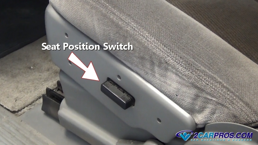

1. Start by identifying the seat switch that is not working, which should be on the outward side or front of the seat bottom. This switch may have additional controls beside the bottom cushion and seat position control.
seat position switch

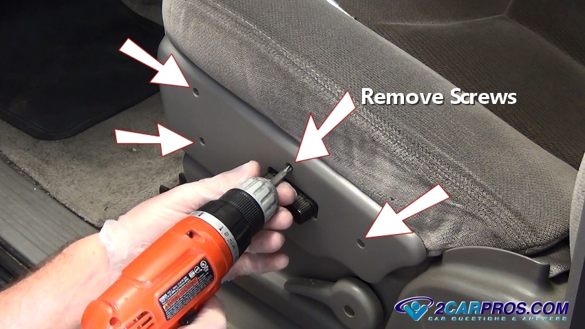

2. There will be a set of mounting screws that hold the switch in place, or to remove the plastic bezel cover that will expose the seat switch mounting screws.
remove seat switch plastic cover

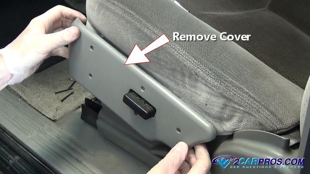

3. After removing the cover screws, grasp the cover and pull it outward from the seat, there could be plastic clips holding the cover so be careful not to break it.
remove seat side cover

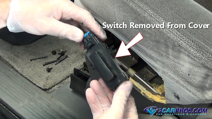

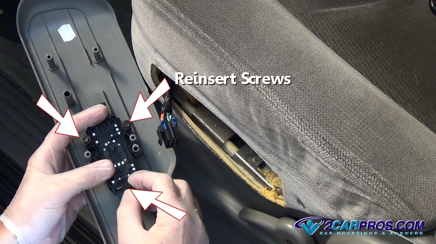

4. Next, turn the cover over to expose the switch mounting screws, use a screwdriver to remove the screws. Also, the seat control switch could be mounted to the seat frame rail which can be removed in the same manner.
remove seat control switch mounting screws

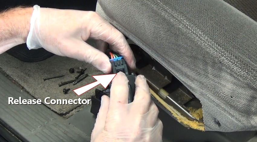

5. The switch will now be loose from its mounting, but will still be attached to the wiring harness. Some applications allow you to remove the wiring connector before this step.
seat control switch removed cover

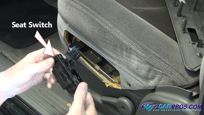

6. Release the wiring harness connector and pull upward to remove the switch from the harness.
release seat switch electrical connector
7. This is what the seat position control switch looks like when removed.
seat position switch removed

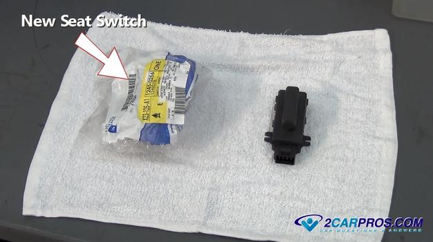

8. Match the new seat position control switch to the old unit, they should match identically for a proper installation.
9. Reinstall and tighten the switch mounting screws, do not over tighten, these threads are made of plastic and can strip out easily.

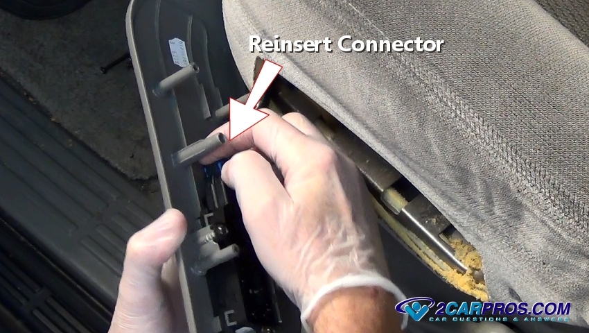

10. Reinsert and connect the wiring harness connector into the new switch, there should be an audible click when fully installed.
reconnect seat control switch wiring connector

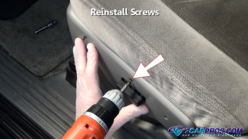

11. Once the switch is mounted and connected to the wiring harness, reposition the seat side cover.
reposition seat switch side cover
12. Then, install and tighten the seat side cover mounting screws.
reinstall tighten seat switch plastic cover

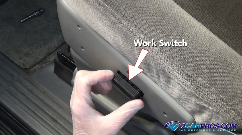

13. Once the job is complete, work the switch in each direction to check its operation and you are all set. If you have additional problems or questions with how to replace the seat control switch or if the switch is not working, our experts will help you for free.
