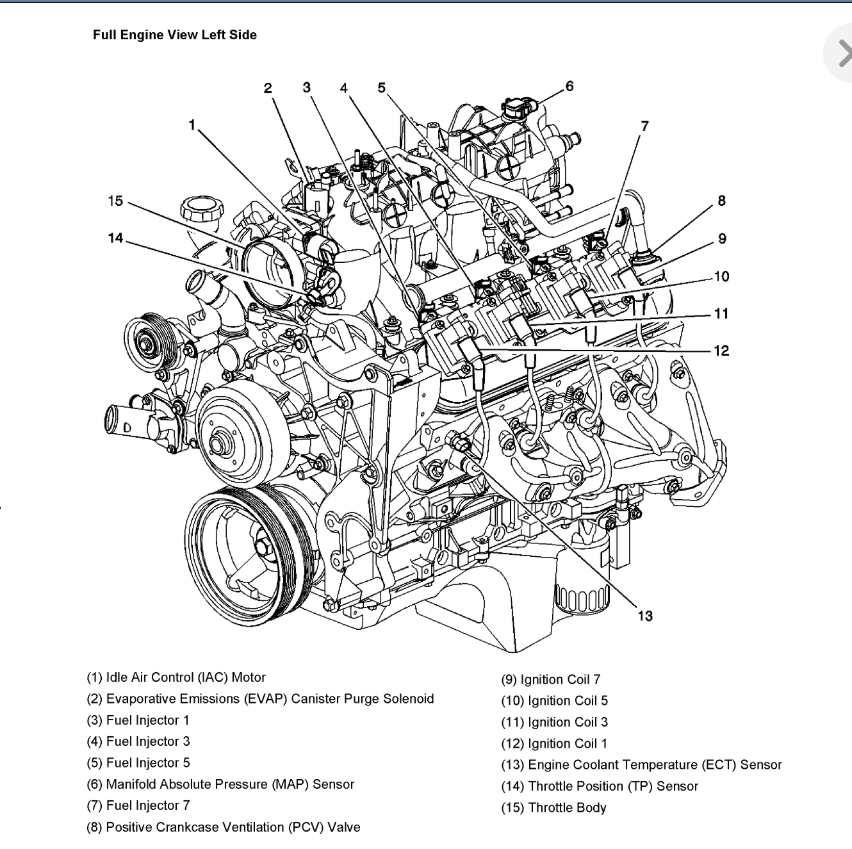

So far ive checked everything that i could, injectors are fine great spark from coils, wires, plugs. Checked the mass air flow sensor, fuel pressure is 55psi, i bought a chiltons manual to help locate and trouble shoot. Showed a picture of the egr valve wich i dont think my truck has one. Since ive replaced the intake gaskets with felpro rubber gaskets would they be ruined if the intake is warped? I plan on ordering a new intake just to see and make sure..

Thanks alot for all the info that you gave it was a real big help. I went to the parts store and bought a MAP sensor and factory hook up bosch o2 sensors. I replaced the MAP sensore took out the bosch premium o2 sensors and started the truck it seemed to run better and the throttle responce was alot better! I put the factory hook up bosch o2 sensors in and presto, the truck was and is runing great. Thank God i dont have a warped intake! I also put a can of Sea Foam in the gas tank and let it run for awhile, it also seamed to help, the truck is running really smooth. My only concern is the engine light is still on. Do i have to have the old codes cleared or will the light go off on its own?

I replaced the MAP sensor and replaced the bosch premium o2 sensors with bosch o2 sensors with a factory plug in. I installed the map sensor and then took out the o2 sensors and started the truck. It seemed to run a little better and had a better throttle responce. I then installed the factory hook up o2 sensors and started the truck again and it ran beautifully. My only concern is the eng light is still on. Do i have to have the stored codes removed before the eng light will go off or will it do it on its own? P.S. thank God i dont have a warped intake! I also put in a can of Sea Foam and let the eng run for 45 min and i think it seemed to run even better.

Your welcome glad to hear you got the truck up and running again as far as the check engine light goes if you don't live in california i would take it to a auto part's store and have them clear the code's.The light will turn off by itself over time but i would have the code's cleared.
