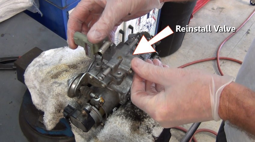

The IAC gathers air from internal ports inside the intake and throttle bore systems. These transfer ports need to be serviced as well when cleaning the IAC motor to help keep the newly cleaned valve working correctly.
clean idle air valve ports
Make sure all gaskets or seals are in good shape to avoid leakage as you reinstall the valve onto the throttle bore housing and reinsert the mounting screws to tighten evenly.
reinstall idle air valve
