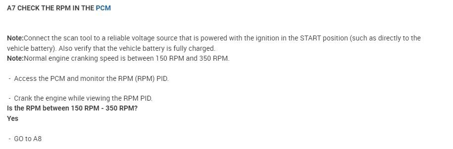

Exactly that, cranks but doesn't start.

Good afternoon,

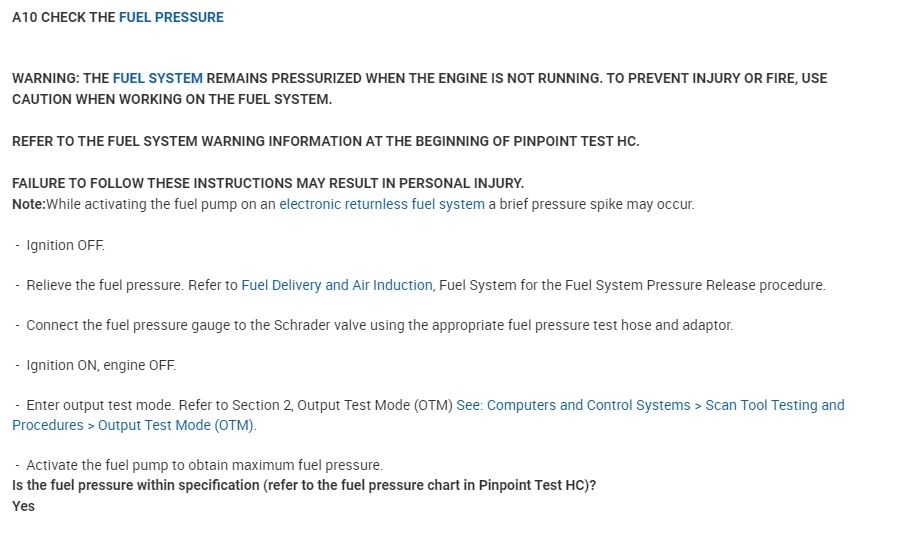

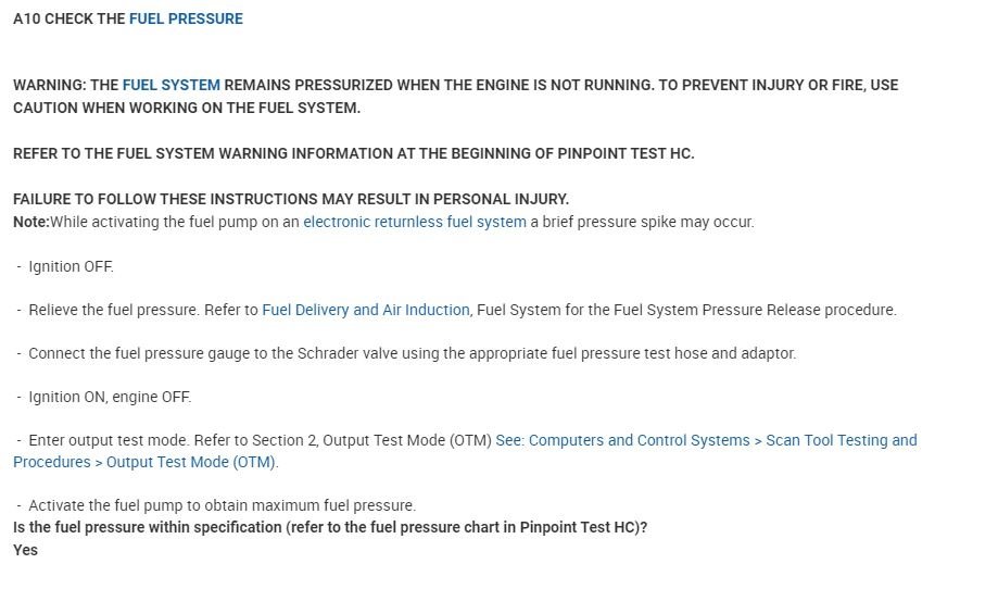

Can you hear the fuel pump run when you turn on the key?
You need spark, fuel pressure and compression for it to run.
I would check the fuel pressure and check for spark at a spark plug.
I attached some charts for you to follow.
Let me know the results. See if the tachometer moves up a little while cranking. That will tell me if the crank sensor is working.

Got it, fuel module it turns out was bad, all fixed!
