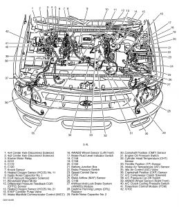

So we now know fuel pump is working .. so if there is no fuel in cylinders on cranking then we are not getting injection .. try replacing CMP ..
Camshaft Position Sensor
A 3-pin Hall Effect type sensor or a 2-pin variable reluctance Camshaft Position (CMP) sensor is used. CMP sensor is used to determine camshaft position and to identify when piston No. 1 is at Top Dead Center (TDC) of compression stroke. CMP sensor signal is used by Powertrain Control Module (PCM) for synchronizing firing of sequential fuel injectors. Applications with Coil On Plug (COP) ignition also use CMP signal to select the proper ignition coil to fire.
Camshaft Position (CMP) Sensor (5.4L)On front of engine. See Fig. 3 .
http://www.2carpros.com/forum/automotive_pictures/266999_cam_4.jpg
