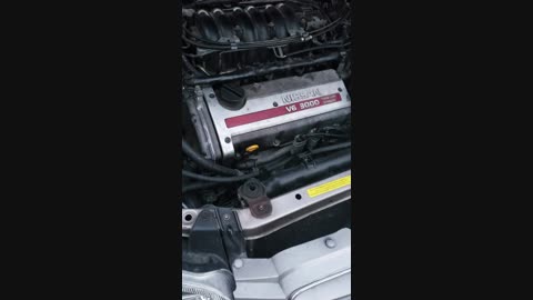

Hello, In October I had my transmission rebuilt and ever since my car wont start. Took it to a local mechanic had the fuel pump replaced as well as all the spark plugs, timing chain and fly wheel. In need of help! (If I keep trying to turn it on it will eventually turn on after a few minutes but a whole lot of smoke would come out. Once I turn it off I am stuck with the same problem). Please help.

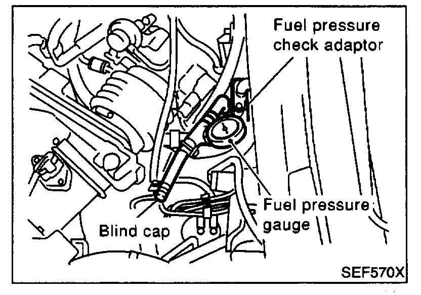

Here are the directions specific to your vehicle. The attached picture correlates with these directions. Also, the specs are included in the directions.
_____________________________________________
COMPONENT TESTS AND GENERAL DIAGNOSTICS
- When reconnecting fuel line, always use new clamps.
- Make sure that clamp screw does not contact adjacent parts.
- Use a torque driver to tighten clamps.
- Use Pressure Gauge to check fuel pressure.
- Do not perform fuel pressure check with system operating. Fuel pressure gauge may indicate false readings.
1. Release fuel pressure to zero.
2. Disconnect fuel tube joint in fuel line and set fuel pressure check adapter (J44321).
See Picture 1
3. Install pressure gauge to the fuel pressure check adapter as shown in the figure.
4. Start engine and check for fuel leakage.
5. Read the indication of fuel pressure gauge.
At idling:
With vacuum hose connected Approximately 235 kPa (2.4 kg/sq.cm, 34 psi)
With vacuum hose disconnected Approximately 294 kPa (3.0 kg/sq.cm, 43 psi)
If results are unsatisfactory, perform Fuel Pressure Regulator Check.
