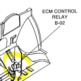

The engine was cold. I'm getting fuel. Where are the relays for the ECM?
Wednesday, May 29th, 2019 AT 5:54 AM
  • 110,194 POSTS
Welcome back:
It's to the right of the ECM. See attached picture.
Let me know if this helps.
