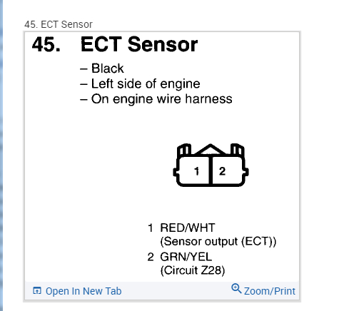

About 3 weeks ago I had the starter replaced. Everything was okay until yesterday. Now the engine cranks good but will not start, also the temperature gauge will shoot all the way up to hot as soon as a turn on the ignition.

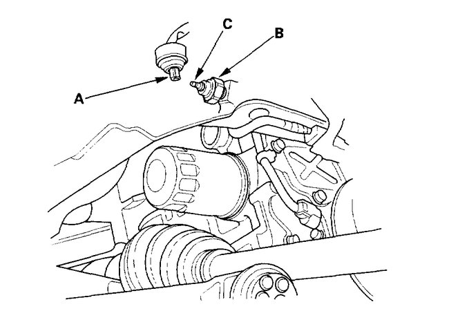

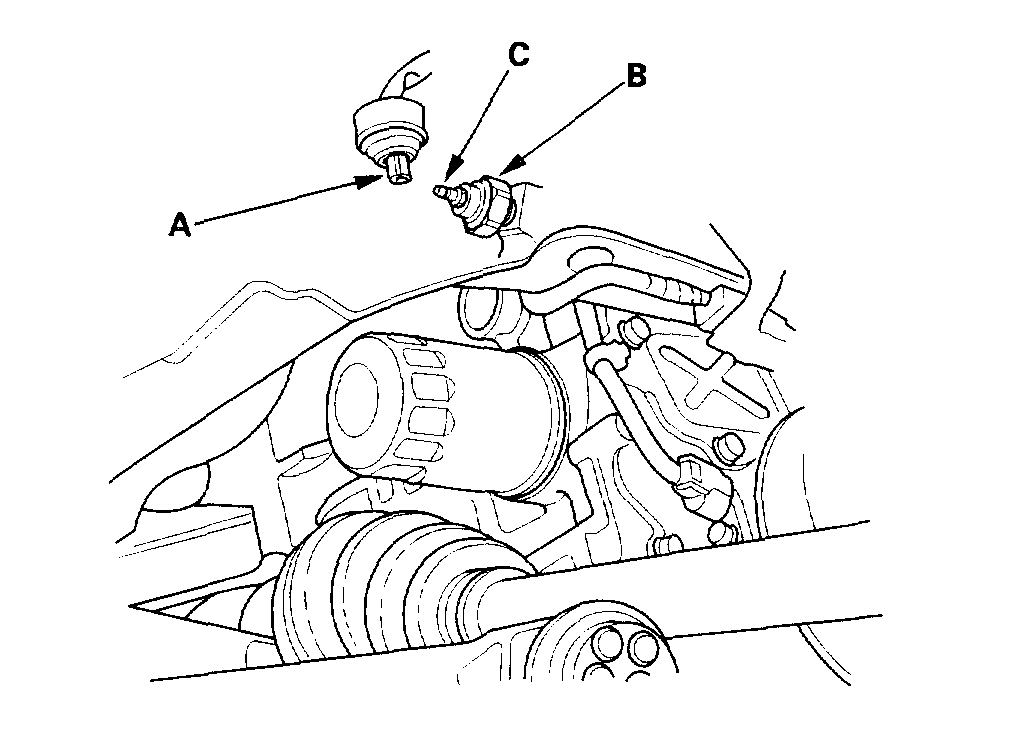

As far as the temperature gauge, it sounds like there is a short to power. Do me a favor. I need you to test the oil switch. Here are the directions and the attached pic correlates with the directions. If you need help, let me know.
_____________________________
2003 Honda Truck CR-V 4WD L4-2.4L
Component Tests and General Diagnostics
Vehicle Powertrain Management Sensors and Switches - Powertrain Management Sensors and Switches - Computers and Control Systems Oil Pressure Sensor Testing and Inspection Component Tests and General Diagnostics
COMPONENT TESTS AND GENERAL DIAGNOSTICS
Oil Pressure Switch Test
pic 1
1. Remove the YEL/RED wire (A) from the engine oil pressure switch (B).
2. Check for continuity between the positive terminal (c) and the engine (ground). There should be continuity with the engine stopped. There should be no continuity with the engine running.
3. If the switch fails to operate, check the engine oil level. If the engine oil level is OK, check the engine oil pressure. If the oil pressure is OK, replace the oil pressure switch.

Let's do two things. First we need to check for codes. I suspect we have an issue when the coolant temperature sensor is faulty telling the PCM that the engine is hot and it is not dumping the correct amount of fuel so the engine will start. If we have codes then we can track down that issue and is not, we can just go after the coolant sensor on our own and then once that is fixed we can retest the starting issue.

The way I understood this was the temperature gauge issue happened at the same time as it started to not start. If this is the case then I would think the PCM is cutting the injectors due to it thinking the engine is overheating. If these issues are related, then doing as Joe stated of replacing the sensor would fix both issues.

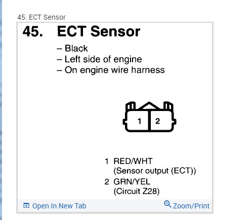

While the sensor is the most likely cause of this, it could be a shorted wire. If it were me, I would replace the sensor and go from there. They are pretty cheap which makes it worth while to just swap it out.
Here is the info on the sensor. Let us know what happens. Thanks

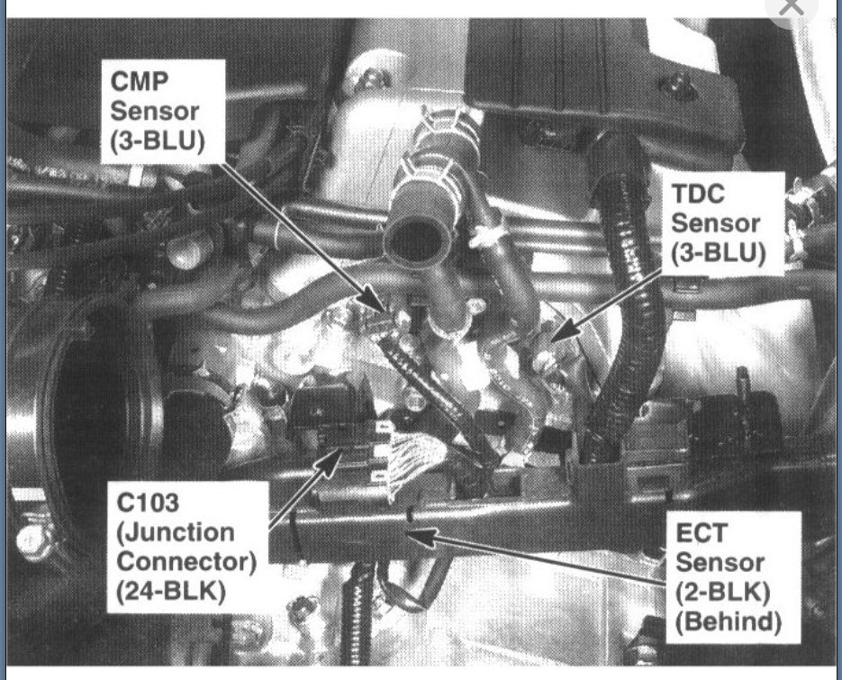

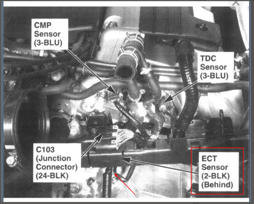

In the diagram where is the coolant temperature sensor?
Thursday, March 11th, 2021 AT 6:23 PM
Sorry. It is circled in this attachment. Called the ECT for engine coolant temperature sensor.
It is actually behind the black electrical connector. I pointed in red to the wiring for the sensor.
Let us know if you still can't find it and we will see if we can get more detail.
RON CONDELUCI
Is it on top of the engine and is this diagram showing the front or side of the engine? I found it, but I can't reach it without removing the black electrical connector. It looks like a black rail about 12 inches long. Do I remove that?

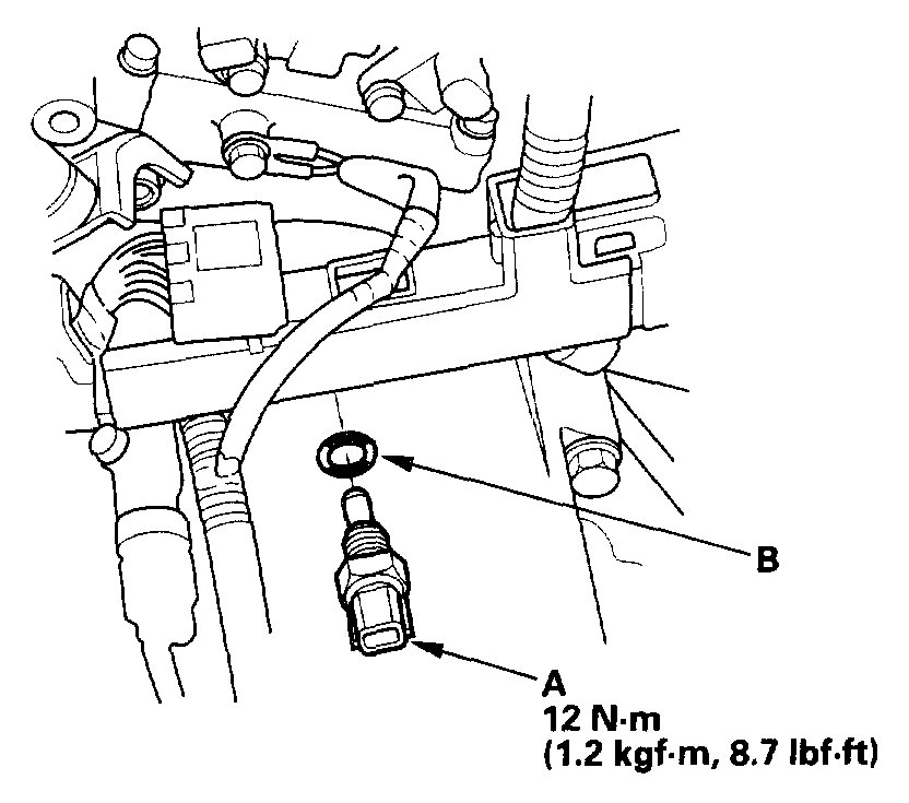

Here are the directions for replacing the sensor. The attached pic correlates with the directions.
___________________________________
Procedures
Vehicle Sensors and Switches Sensors and Switches - Cooling System Engine - Coolant Temperature Sensor/Switch Service and Repair Procedures
PROCEDURES
ECT Sensor Replacement
1. Remove the air cleaner.
2. Disconnect the ECT sensor 2P connector.
Pic 1
3. Remove the ECT sensor (A).
4. Install the sensor in the reverse order of removal with a new O-ring (B).
_______________
Let me know if this helps. Also, the sensor is below the component you mentioned. You shouldn't need to remove it.

Hi guys,
I was able to get to and replace the sensor and it fixed the problem. Thank you very much for the excellent guidance through the process. Job well done.
