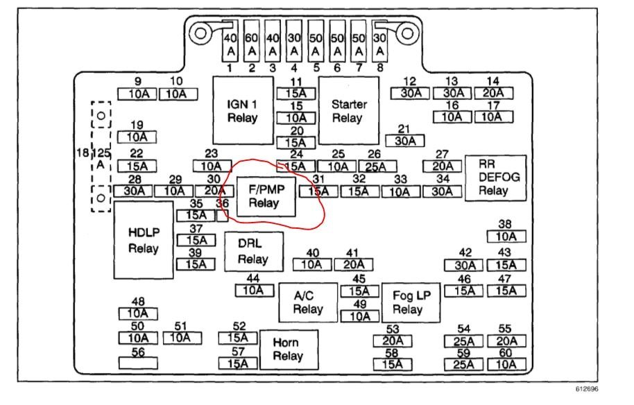

My truck cranks normally but won't start. It will on ether but shuts off. I've replaced fuel pump and filter, plugs wires, cam shaft sensor, and crank sensor. Good fuel pressure to fuel rails. Coils and injectors are good. It's got spark. Fuses and relays are all good. Also replaced battery. Alternator and starter are good. Nobody can seem to figure it out. Please help.

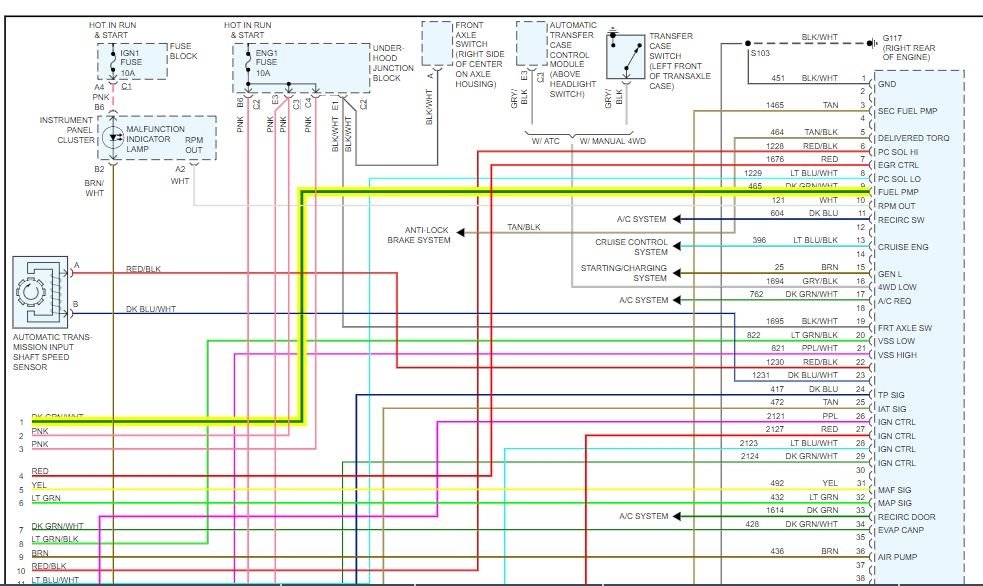

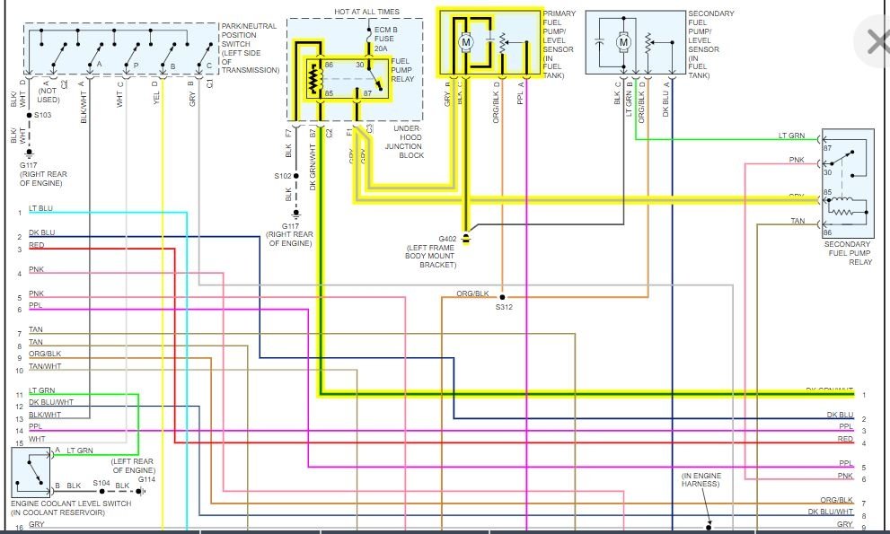

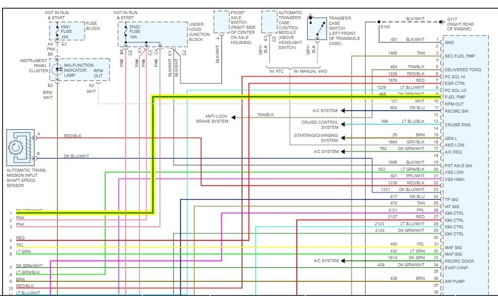

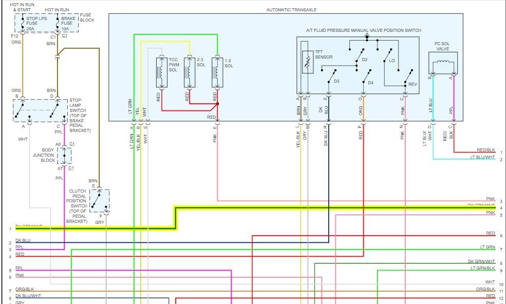

Did you verify power to the fuel pump while cranking and when you first turn the key to on?
I attached a diagram of the relay and the pump for you. You need to verify power to the relay first on pin 30.
Then 85 gets power directly from the ECM.
The grey wire at the pump is what needs power.

Hi Roy, I had my neighbor check it out and the pump and relay are indeed getting power.

If the pump is getting power and not running, then you either have a bad pump or ground.
Did you verify no fuel pressure?
