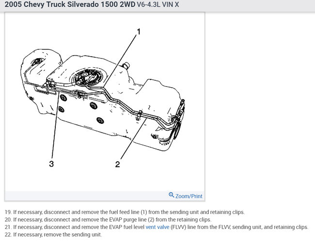

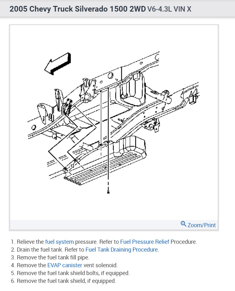

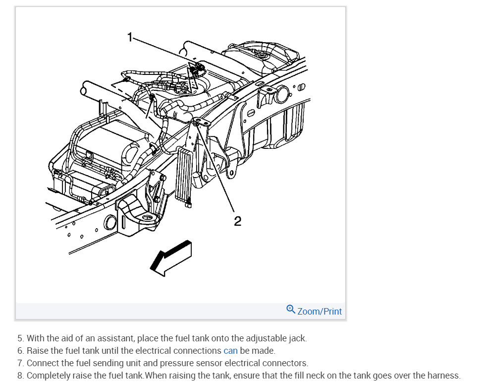

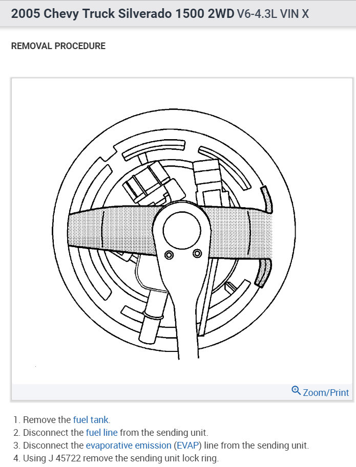

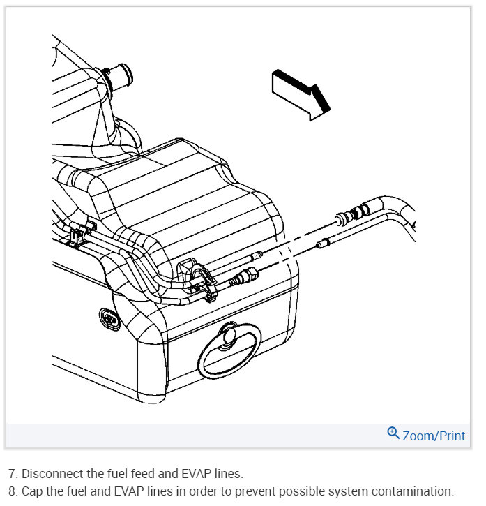

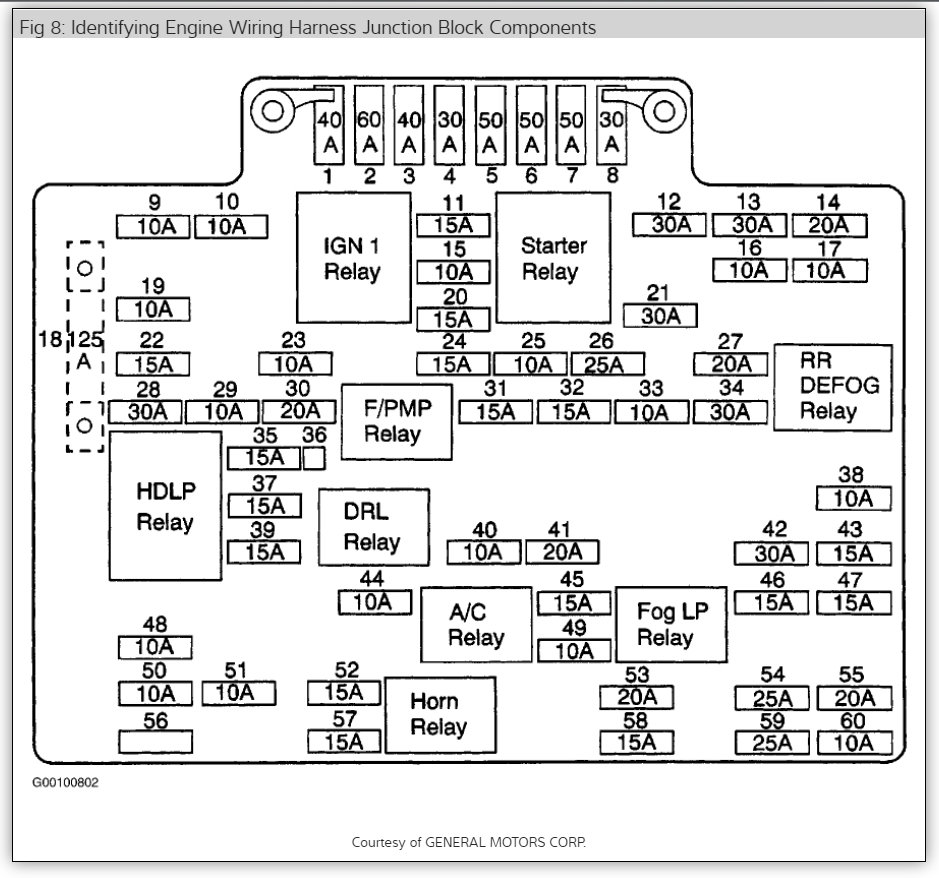

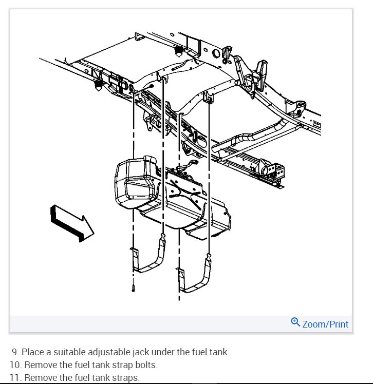

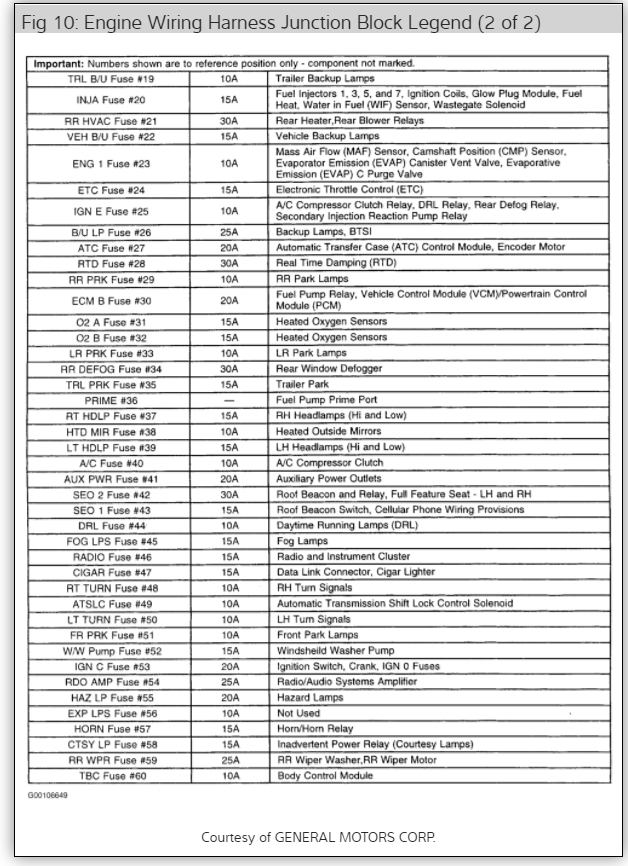

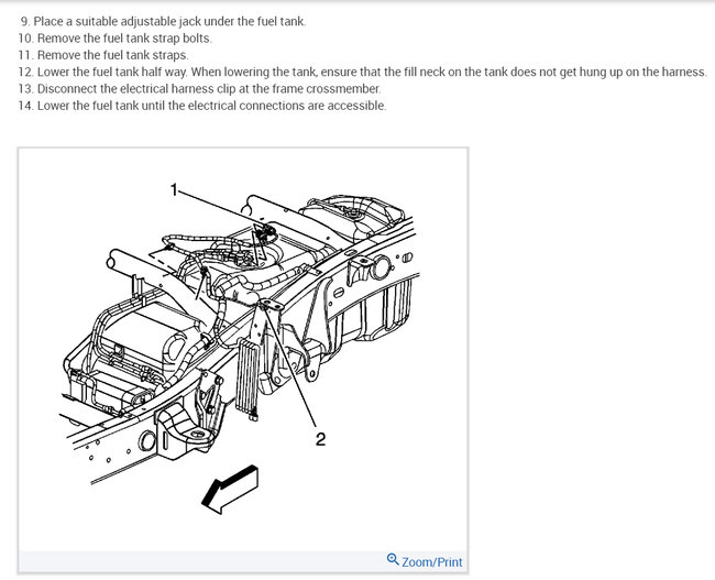

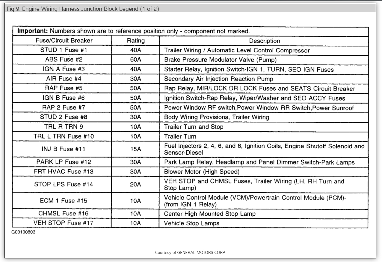

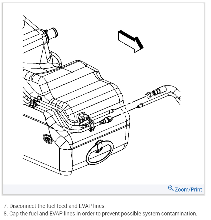

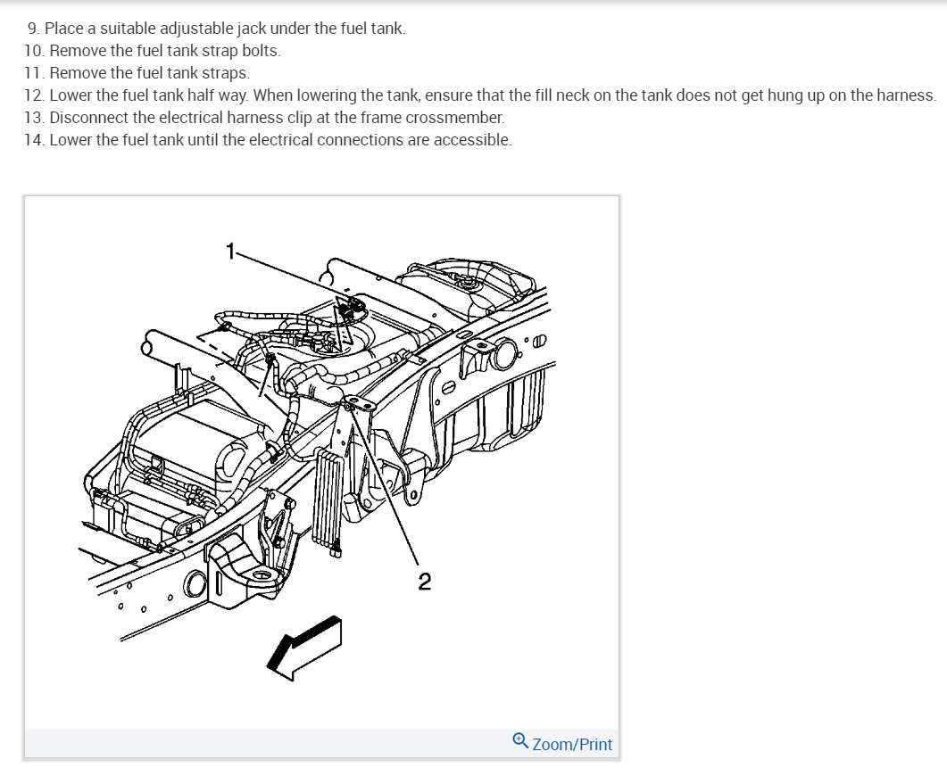

This sounds like a classic fuel pump failure, do you hear the pump run when you turn the key on without cranking the engine over? If not let's check the pump fuse and relay to confirm the pump failure. Here are guides to help you test the fuse and relay.
If okay here are diagrams to help you change the pump out with a guide to help walk you through the steps.
https://www.2carpros.com/articles/how-to-replace-an-electric-fuel-pump
Check out the diagrams (Below). Please let us know what you find. We are interested to see what it is.
