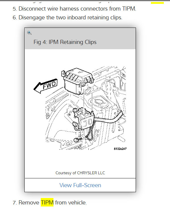

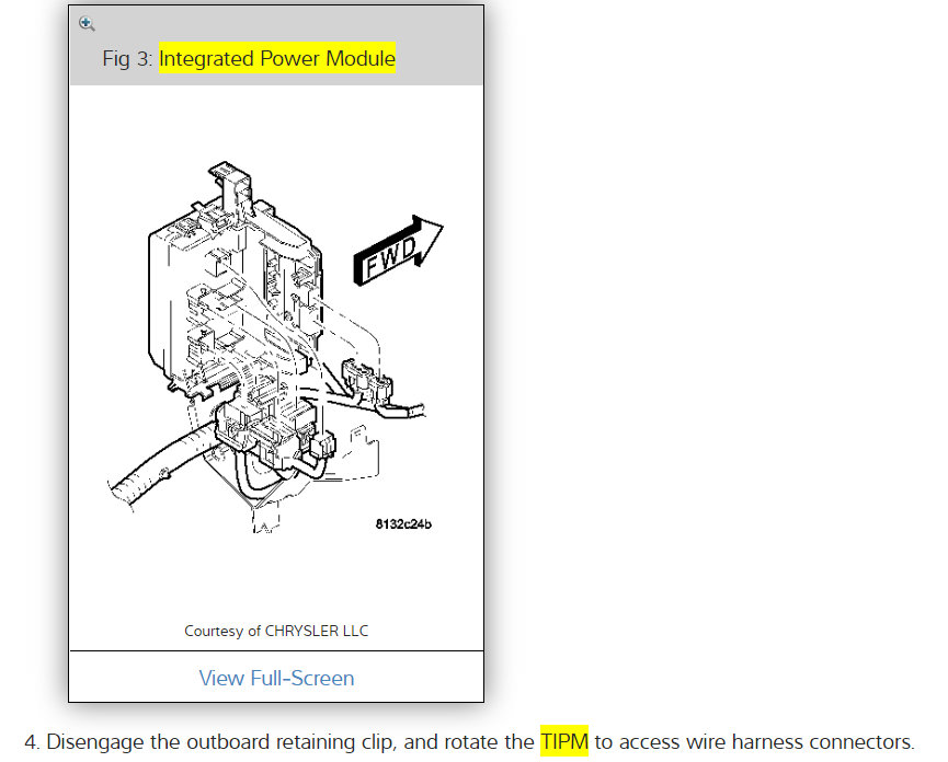

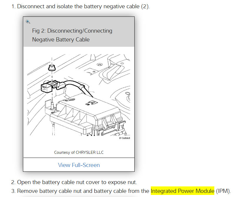

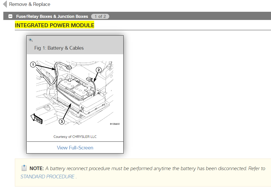

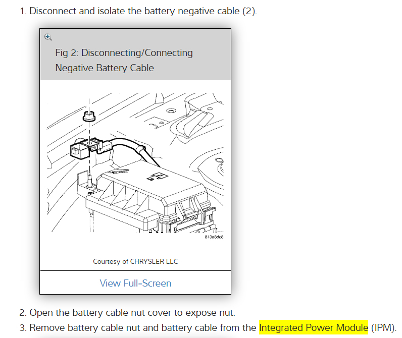

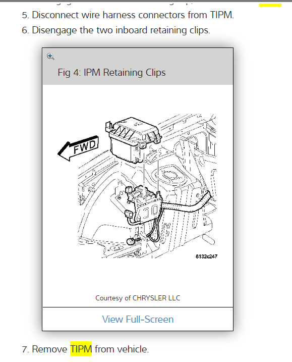

  • 75,992 POSTS
It sounds like the TIPM is bad. When you turn the key to the on position without cranking the engine over can you hear the fuel pump run in the tank for 5 seconds? Here is how to change out the TIPM it is easy because it self initializes.
