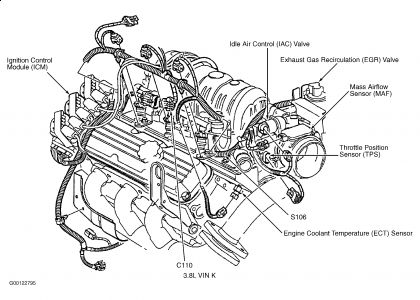

NATESSBCS10
Hasnt been long maybe 5 months replaced the relays for the fans and 1 of the fans also. Are you talking about the sending unit on the radiator or the temp gauge?Or is that the same one?
Wednesday, August 1st, 2018 AT 7:51 PM (Merged)
DOCFIXIT
  • 18,828 POSTS
ECT located near coolant outlet left rear engine
Do fans come on with engine temp?
https://www.2carpros.com/forum/automotive_pictures/198357_Graphic_107.jpg
NATESSBCS10
Yes the fans come on however they go alot faster with the ac on. Also I didnt bleed the air out of the lines looking to that now. My heat inside the car doesnt seem to be as hot as it should either.
