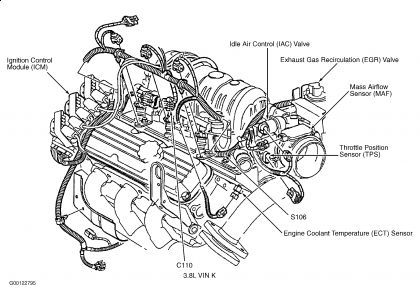

ECT located near coolant outlet left rear engine
Do fans come on with engine temp?

Hi grey-hair. Welcome to the forum. Sounds like a problem with the coolant temperature sensor if the radiator fan doesn't turn on without having to turn the AC on. To verify the lack of a fan is causing the overheating, next time it runs too hot, turn the heater on maximum hot and fan on high. That will act like a small radiator.
Also check for multiple fan relays in the fuse box under the hood. Some cars have a low and a high speed relay and some have one for just the radiator fan and another that runs both the radiator and the AC fans. A fast test for relays is to switch two indentical ones around to see if a different circuit stops working.
Some vehicles, minivans in particular, use an electronic fan relay module with multiple inputs. That would also be a likely suspect.

Sorry, the temp sensor is good I had the meter set wrong. It was 1400 ohms at around 100 degrees.

Sorry I missed your replies. I was out of town at the nation's second largest old car show swap meet.
1400 ohms is acceptable for the coolant temperature sensor but the 5.0 volts is not unless you measured that while it was unplugged. If you back probe the connector while it's plugged in, you should find between 0.5 and 4.5 volts. The higher the temperature, the lower the voltage. By the way, are you on a two-wire sensor? If it only has one wire, you're looking at the sensor for the dash gauge.
The fan should not be needed at highway speeds. If turning on the heater fan helps, check the radiator for corroded and crumbling cooling fins.
