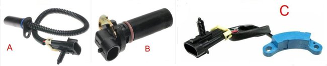

I am going to chance it and buy a sensor first and have mechanic put it in, but which one?
Can you tell me? Engine M 3.1L. A, B or C in image. Thank you.
Thursday, July 19th, 2018 AT 10:41 PM
STEVE W.
  • 15,300 POSTS

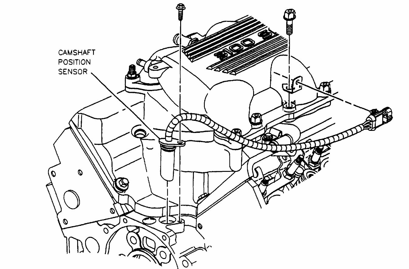

A is the camshaft position sensor.
B is the 3X crankshaft position sensor
C is the 24X crankshaft position sensor.
To answer the question, B&C are the common culprits. To narrow it down. Go get a can of "canned air", "computer duster" or whatever the name you use for the stuff in the pictures.
Part A is mounted in the engine just to the side of the intake manifold. As shown in the third image

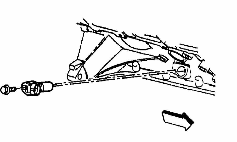

Part B is mounted into the side of the engine facing the firewall as shown in image 4.

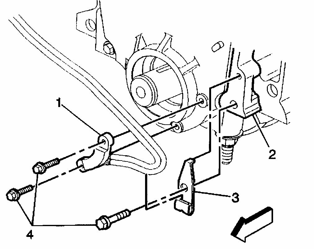

Part C is mounted at the front of the engine behind the crankshaft pulley as shown in the last image.
My first suspect would be Part C followed by Part B as both of those control the ignition.
