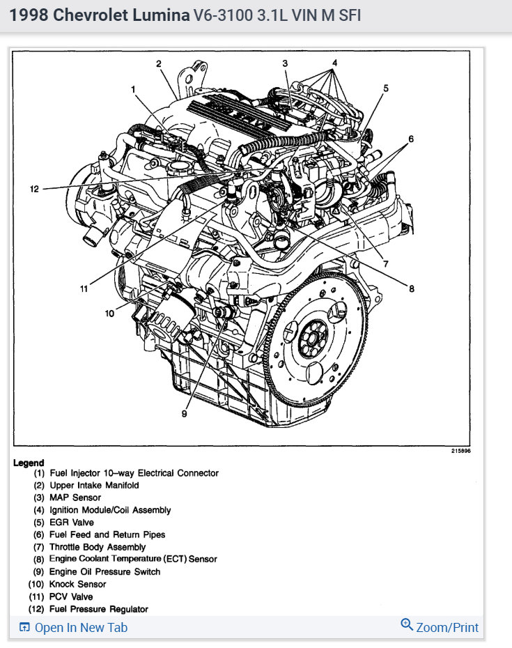

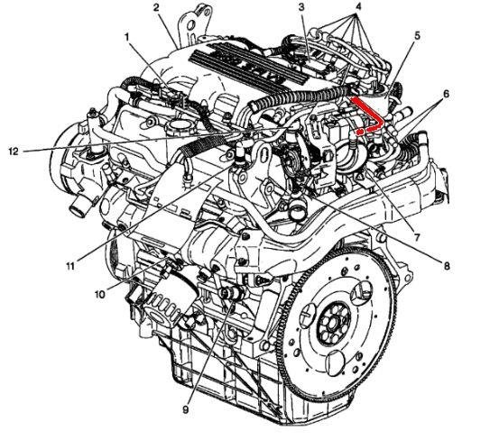

In the image does that red colored tube go anywhere? At the other end. Mine is just hanging there

That looks like the PCV line. If the other end goes into the valve cover then that is it. The end near the throttle body goes into a hole on the boot from the airbox to the throttle body.

I found what makes it stall. While engine running I shook that tube and it stalled.
Now the PCV valve tube is taped to that red tube both are hanging loose on the other end of from where they come from the engine. Do they belong somewhere?

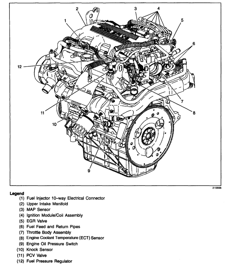

Here are two diagrams that show the PCV system. Check out the diagrams (Below). Please let us know if you need anything else to get the problem fixed.

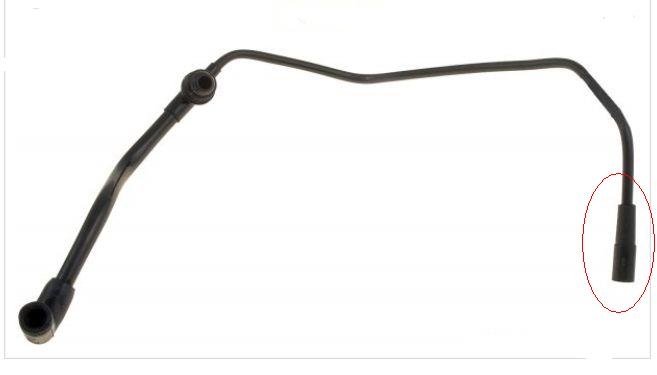

I didn't get any gain in RPM from leak. In the picture where you see red circle was bad.
Replaced PCV hose. No longer stalls. Runs good Got it up to normal temp(195) made U-turn no stall went over speed bump. No stall.I don't know what to tell you but putting
new PCV hose on did the trick. Thanks for all your Help.

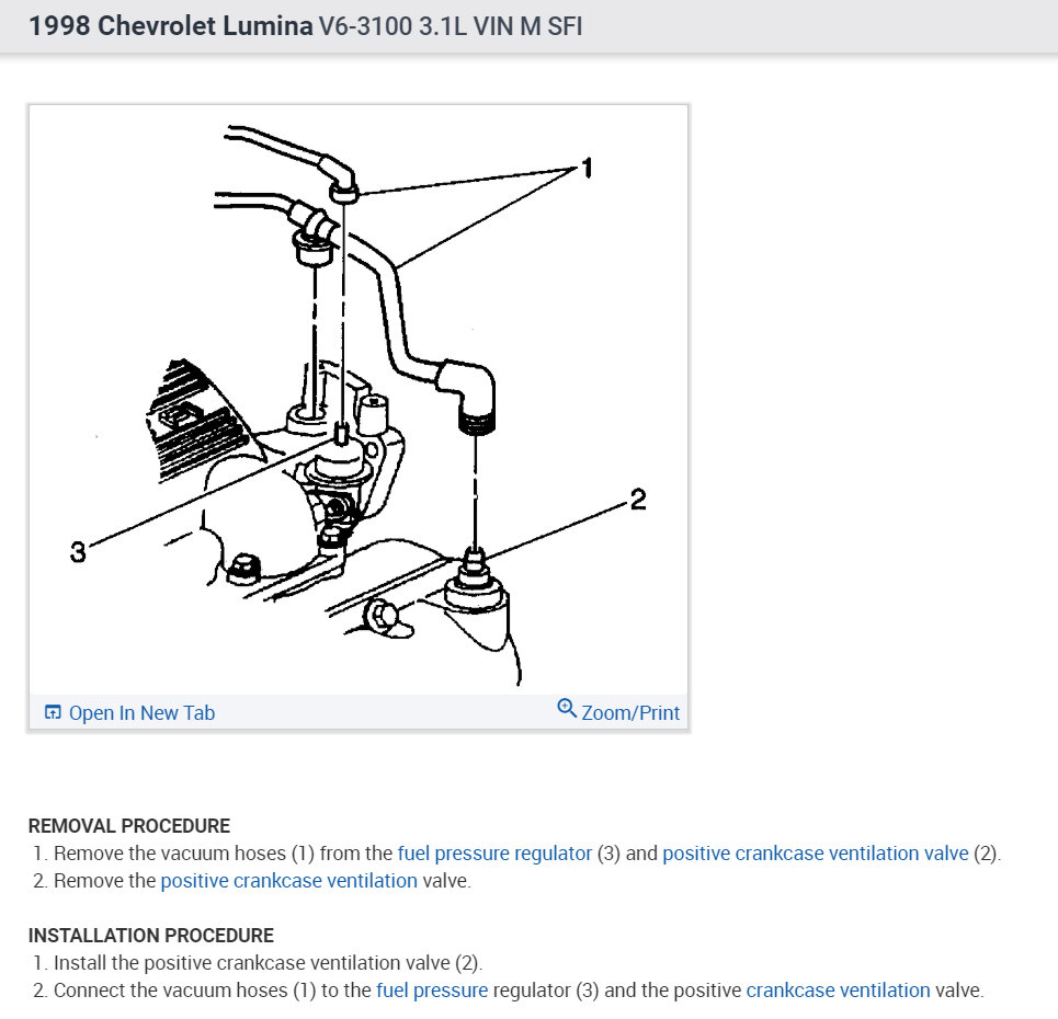

Hello again. The PCV hose the end I have in the circle does that go on the top port or bottom. There are two hoses there.

It is all one hose.
Thursday, February 21st, 2019 AT 10:22 AM
STEVE W.
  • 15,300 POSTS
The end with the elbow goes to the port on top of the valve cover (2). The T fitting goes into the top of the throttle body, the straight end of that line goes back to the lower fitting on the valve on the other valve cover.
