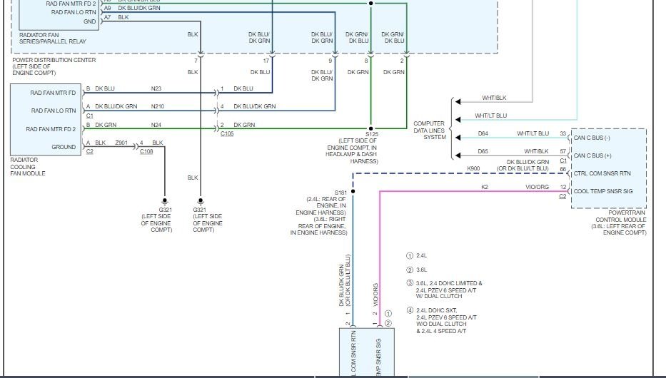

Whenever the car is in park or still for too long the temperature gauge starts moving up and the A/C no longer feels cool but starts blowing out warm air. Now that it’s getting hotter out the car is overheating when in park. what should I do?

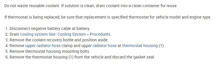

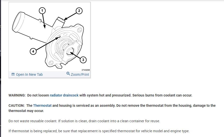

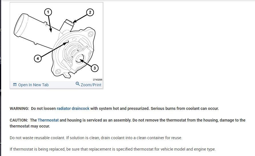

If that is good, I would suggest a thermostat as it may be stuck closed or partially closed.
https://www.2carpros.com/articles/coolant-flush-and-refill-all-cars

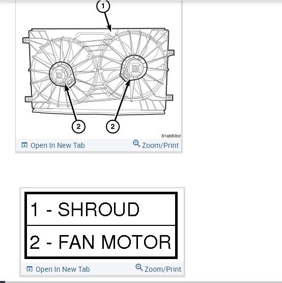

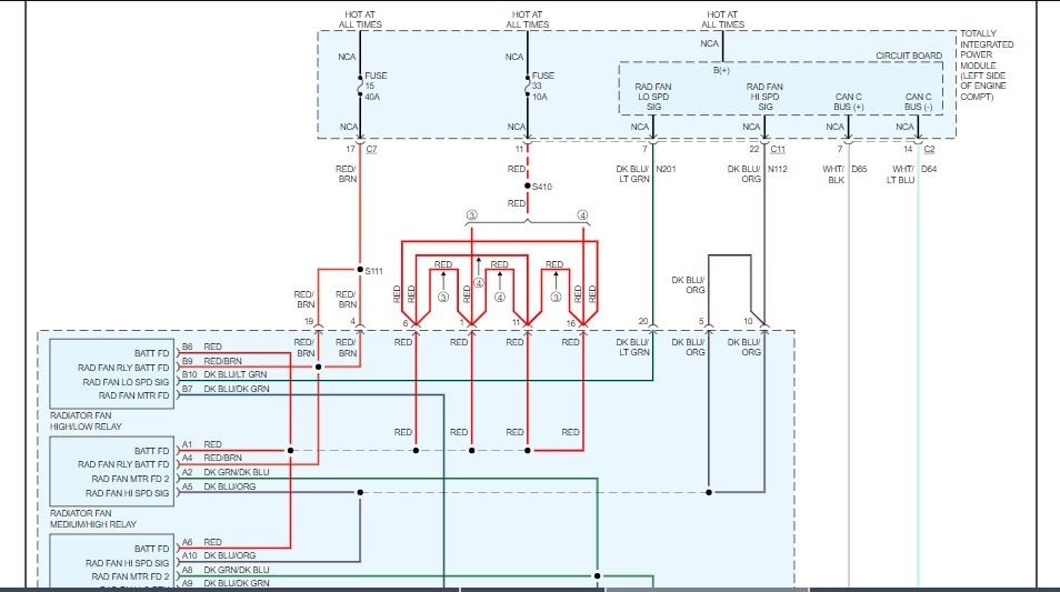

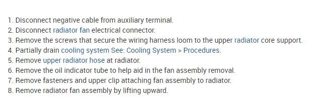

Are the cooling fans working when it heats up? If they are not, then that is the reason it is heating up at idle.I attached a wiring diagram of the fans for you. I would check the fuses to be sure there is power on both sides of the fuse.
https://www.2carpros.com/articles/how-an-electric-cooling-fan-works
