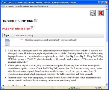

ALJNWALDEN
  • 1997 BUICK LESABRE
1997 Buick Lesabre 6 cyl Front Wheel Drive Automatic
I have a 1997 Buick Lesabre, 3.8, 6cyl. After driving the car to a few places and stopping, shutting off engine, when I try to restart the car it will turn over but wont start. If I let it set for a little while, with positive battery cable OFF, it will start again. I need to know what is causing this, or what part I need to fix it.
Tuesday, August 4th, 2020 AT 3:55 PM (Merged)
SATURNTECH9
  • 30,870 POSTS
When it turn's over and won't start is the security light on or flashing?Also do you have spark when it crank's and doesn't start?Also do you have any code's?
Tuesday, August 4th, 2020 AT 3:56 PM (Merged)
ALJNWALDEN
Yes, Security Light is on. We do have a spark, just doesnt start. We got codes, but I can't remember the codes thereself, but I know they were for a crank sensor, map sensor, or mass airflow sensor. Which of these would come closer to being my problem?
SATURNTECH9
  • 30,870 POSTS
https://www.2carpros.com/forum/automotive_pictures/416332_1997_buick_lesabre_pass_lock_1.jpg
If the security light is on when it doesn't start then that is reason it's not starting is because the security light is on.Follow the what i posted i also emailed it to you so you can see it better.
