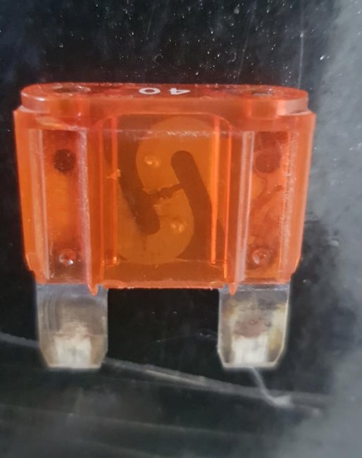

One note: When I started putting the engine back together, I was really tired and put the positive cable on the negative terminal, and when I went to put the negative cable on, sparks flew. I did this twice before I figured out my mistake.
Any ideas what is going on? Could my mixing up the battery cables have caused an additional problem?

after hooking up the cables in reverse, try to read the PCM with a scantool...if you are successful, you may overcome your mistake, If the PCM fried, it won't comunnicate.

I have tried to scan the PCM, but the scanner would not register, indicating a fried PCM. I picked up another PCM from a junkyard from a 97 Park Avenue (tested it at the junkyard, and the scanner read it just fine).
I installed this PCM in the LeSabre, and the scanner will not register this one either. To me, this indicates a short, blown fuse, or fried wiring somewhere.

The problem with reading the PCM was a blown fuse. I replaced the fuse, and am now able to readthe PCM, though it shows "no codes". The car still will not start, with the above mentioned symptoms. I am down to only a few possibilities: 1. Bad crank or cam sensor(s). 2. Fuel pump pressure low. 3. Fuel pressure regulator bad.

Check main maxi fuses in the power distribution center. Follow the heavy cables from The a UKlternator to the pdc. Install your original pcm.

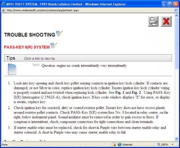

When it turn's over and won't start is the security light on or flashing?Also do you have spark when it crank's and doesn't start?Also do you have any code's?

Yes, Security Light is on ... we do have a spark, just doesnt start. We got codes, but I can't remember the codes thereself, but I know they were for a crank sensor, map sensor, or mass airflow sensor. Which of these would come closer to being my problem?

https://images.2carpros.com/forum/automotive_pictures/416332_1997_buick_lesabre_pass_lock_1.jpg
If the security light is on when it doesn't start then that is reason it's not starting is because the security light is on.Follow the what i posted i also emailed it to you so you can see it better.
