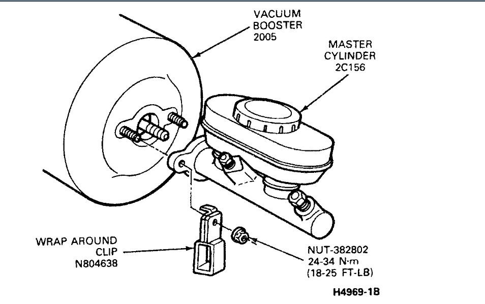

Basically just got the truck, had a leaking rear wheel cylinder. So I replaced both rear wheel cylinders, brake lines, brake shoes, then replaced both front axle bearings, front pads, and both calipers. I have bled the system several times, because I kept thinking I did not get all the air out. When I have pumped the brakes and bled them it would get to be a nice firm brake pedal. Now here`s the problem, when I start the truck and apply not much pressure the brake goes to the floor and won`t come back until I pull it up. So at a loss, don`t want to keep replacing things, like booster, or master cylinder, and even found out that the truck has RABS (rear ABS).
Wednesday, March 10th, 2021 AT 11:30 AM (Merged)
This could be a number of things but it sounds like you replaced the common ones. Here is a guide that goes through this issue:
https://www.2carpros.com/articles/brake-pedal-goes-to-the-floor
This is one of two things. First you either still have air in the lines or there is a leak. If you have no leak outside the system then we can still have an internal leak allowing the pressure to bleed off rather then being applied to the brakes.
If you have not replaced the master cylinder then this would be the most likely cause. I would take the lines off the master cylinder and cap the outlets and then press the brake pedal. If the pedal still goes to the floor then the master cylinder has a leak internally. If not, then the master cylinder is fine and we have an issue is further down in the system.
Let me know if you have questions about this and we can go from there. Thanks

Thanks, I need to get to the parts store and pick up some bolts to plug the master cylinder and test it, but might get the master cylinder anyway. Just trying to figure it out, because we got it for a second vehicle and haven`t even got to put it on the road. Plus, on a fixed income at my age. So really want to thank you, and Ill let you know. Oh, being I do this by myself, been using the jar method for bleeding, should I just try the gravity method.
Sounds good. If you get bolts just make sure they are not too long or you will crack the master cylinder. Just use a whole bunch of washers if needed. You can compare the depth to the depth of the lock nut on the actual line. It should be no longer then the threads of the nut on the line.

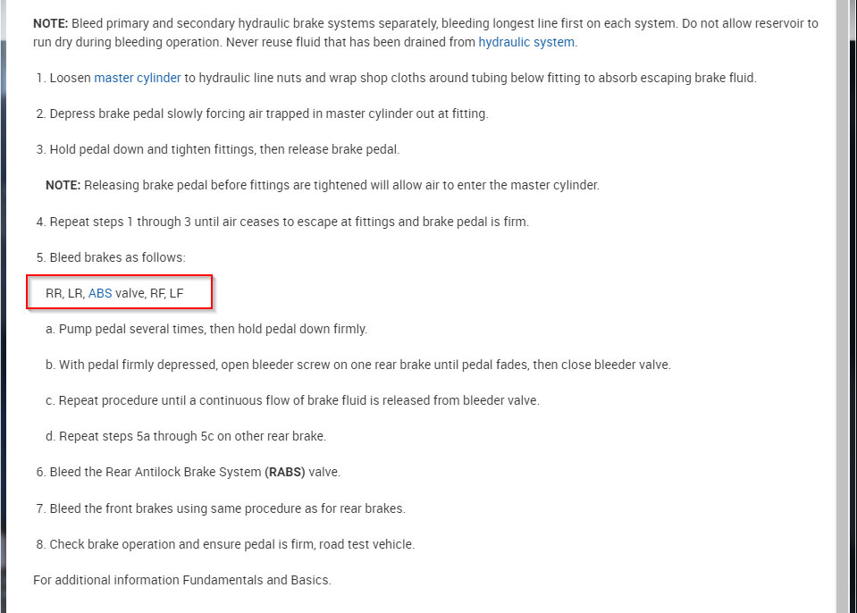

It`s on YouTube, (how to bleed brakes with RABS ( Ford ABS ). When I was checking to see if there was another way to bleed brakes. Now when I bleed the brakes, start passenger rear, driver rear, passenger front then do I bleed ABS valve? Then driver front?
Okay. I will check that out but I think I misunderstood with what you were saying earlier.
You are correct with needing to do the ABS valve but not in the process you stated. I attached the process from the manual.
+1
F1501988
  • 16 POSTS
Hi Kenny, well put the new master cylinder in and bench bled it. Then I was going by the process sheet you sent, but not really getting any fluid out of the ABS valve. Is there a certain way? I even left it open and pumped the brakes and got very little fluid. I would say it has to have fluid somehow going through it because I bled the rear brakes okay. Could there be that much air in it? Thinking of trying to gravity bleed it and just hook a tube to it and crack it open, not sure what to try next.
