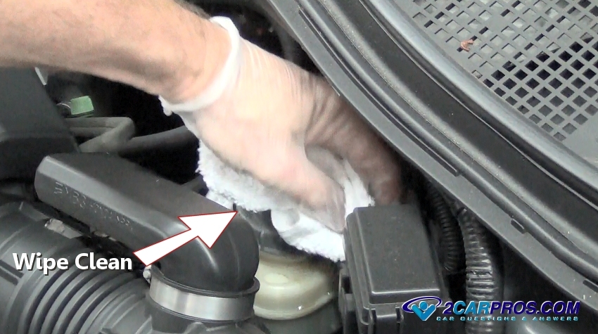

Before opening the master cylinder use a shop towel to wipe it clean. This will
help keep dirt out of the reservoir which can cause seal failure by contaminating
the fluid.

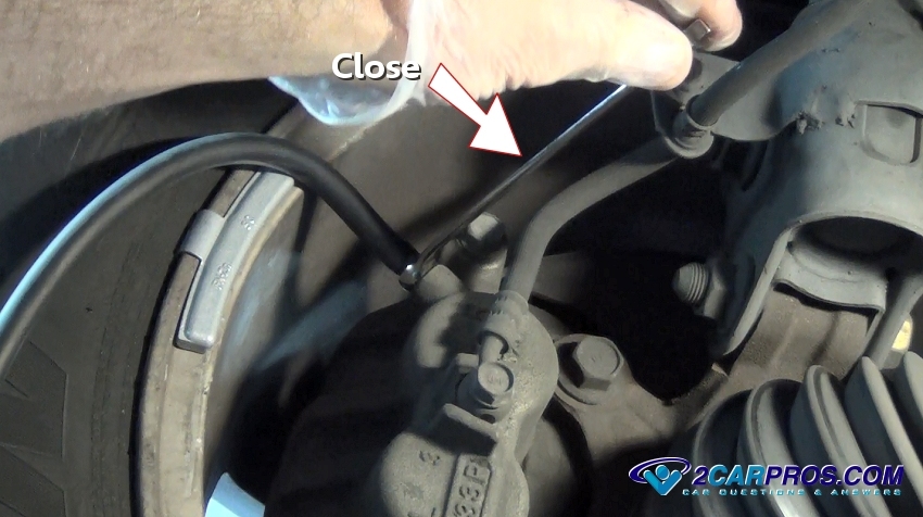

Bleeder screws can be fairly tight, apply WD40 or equivalent to aid in rust removal
if needed and use a 6 point socket which is best to avoid stripping. Once broken
loose, place a boxed end wrench over the bleeder and connect a rubber hose onto
the bleeder and over the wrench. This hose is helpful to avoid fluid from getting
onto the pads etc, access fluid should be hosed off with water once the job is completed.

Start with the left front and open the bleeder valve while the opposite end of
the rubber tube is in a fluid catch container.
Fluid will start to flow out of the bleeder and tube, bubbles will stream out
with the fluid if air is present in the system.
The brake pedal may travel downward, if the pedal goes to the floor initially
this means there is a bunch of air in the system, (the pedal will return to normal
height once the bleeding process is complete). Hold pressure on the pedal, as the
flow starts to slow down tighten the bleeder valve, (Do not let up on the brake
pedal while the valve is open or it will such air back into the system and you will
need to start over).
Once the bleeder valve is closed, lift up on the brake pedal (slowly) until your
foot comes off of the brake pedal pad. Continue this process at each wheel until
fluid is present with no air bubbles being expelled from the bleeder valve or hose,
this can take two or three times. Now one corner of the system is bled, continue
this operation on the right front, left rear, then and then finish with the right
rear.
