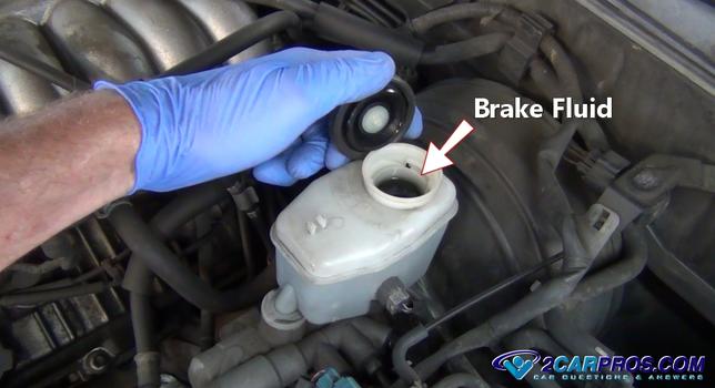

Check the Brake Fluid Level: Anytime you have a brake pedal that goes to the floor raise the hood and locate the brake master cylinder's reservoir. Using a flashlight check the level of the fluid or just remove the lid of the reservoir and look inside. If the fluid is full then continue onto "Brake Fluid is Full" down further in this guide. If the reservoir is empty then either the front or rear brake pads need to be replaced or their is a leak somewhere in the brake system.

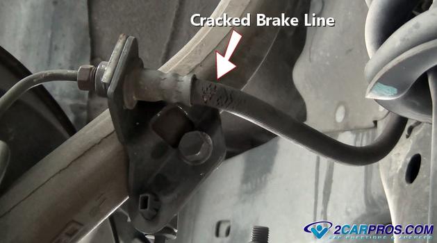

Next, use a flashlight check the backside of each tire and look for leakage which will be obvious. Also check the brake line flex hoses. Here is what a brake line will looks like before it starts leaking. If the hose is wet fluid is leaking and the hose must be replaced.
If the backside of the tire is wet with fluid either you have a brake caliper that is leaking and must be replaced or a wheel cylinder that has gone bad and needs replacing. Both of these problems allow a fluid leak through their brake fluid seals. The lack of brake fluid in the system causes the brakes to be on the floor.

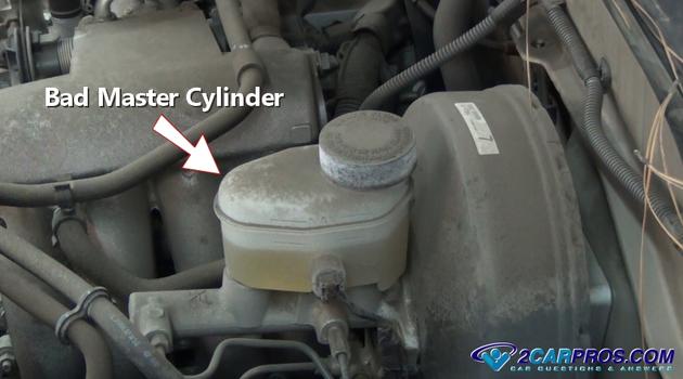

A Bad Brake Master Cylinder: A master cylinder had two sets of internal seals which naturally wear from usage and when they fail cause the fluid which is normally pressurized inside the master to bypass backward into the brake master cylinder fluid reservoir or leak out from the rear of the unit. This failure can create an intermittent brake pedal fade. Pumping the brakes can cause these seals to expand and may help the brake master start working again. When this failure occurs, the brake master cylinder must be replaced with a new unit.
