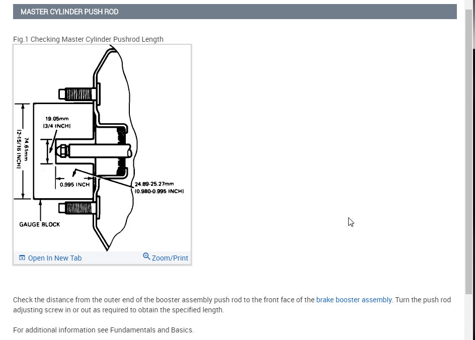

Okay. Today friend stopped by and finished adjusting the rear brakes. Have a little pedal, he mentioned to adjust the brake rod that goes into the master cylinder to get more pedal. What is your thought on that? Before I do it.
Wednesday, March 10th, 2021 AT 11:30 AM (Merged)
This is possible but I have never had to do that. I attached the process and is worth a try.

Well Kenny, I tried adjusting it out a little and basically it may have made the brake pedal a little harder while it's off. But when you start it still goes to the floor. Just trying to figure out what needs the truck to run, to work? Don`t know if there is anything electronic? Or if the booster not working? I guess I`ll need to get to the hardware store for those bolts and basically start from there.
Yeah. Unfortunately that is the next step. The fact that the pedal is hard with the truck off and goes to the floor shows the booster is working. Basically the booster is just there to assist you in pushing the pedal. It makes it easier.
