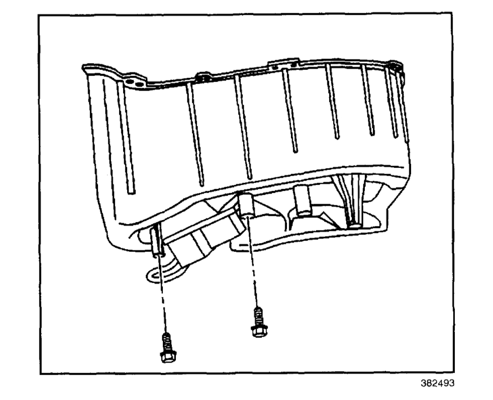

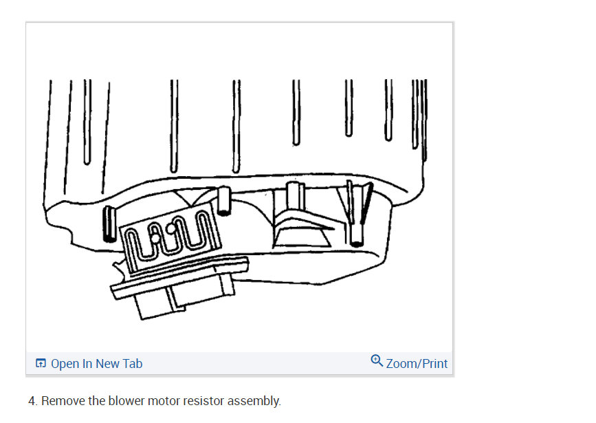

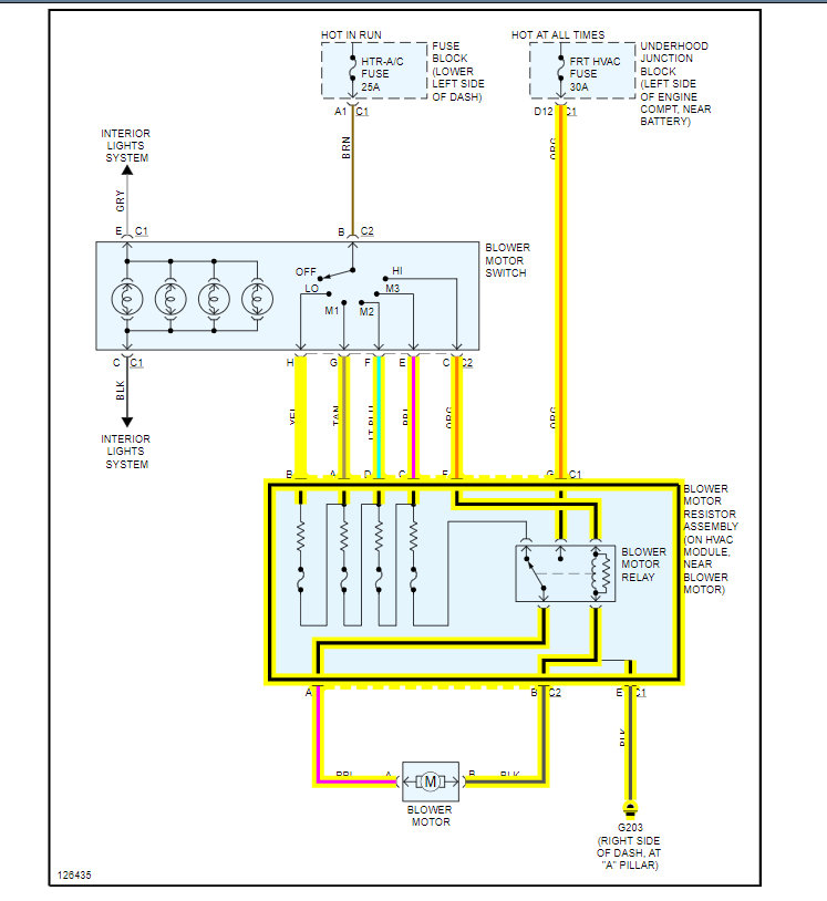

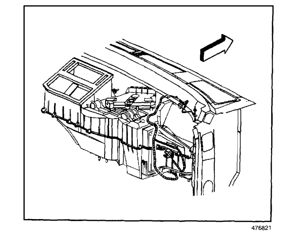

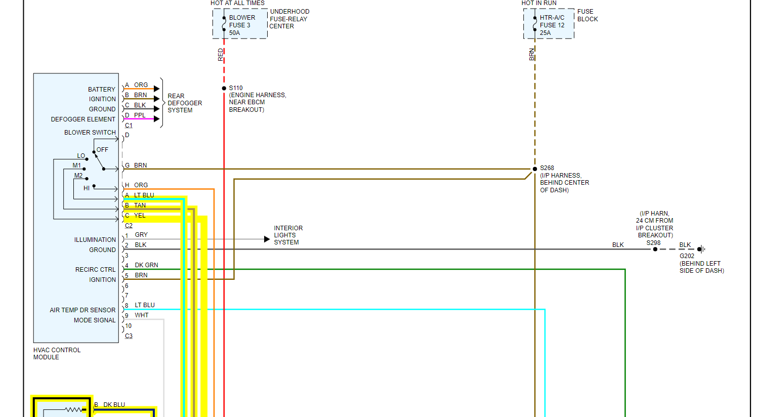

My truck's A/C system has a 5 point switch from 1-5 on blower speed. Blower speeds 1 and 5 stopped functioning but 2-4 worked. I dealt with it. Now 2, 3 and 4 are not working. I hear the compressor kicking in and I believe the trouble is the blower motor or a relay or maybe even the switch in the dash. I do not know where the relay is or how to get to the blower. I have restored and repaired A/C in trucks up to 1987 but after 1987 I am not familiar with these systems. Any information about this problem would be helpful.
Friday, April 30th, 2021 AT 2:23 PM (Merged)

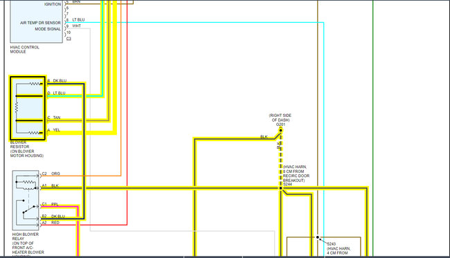

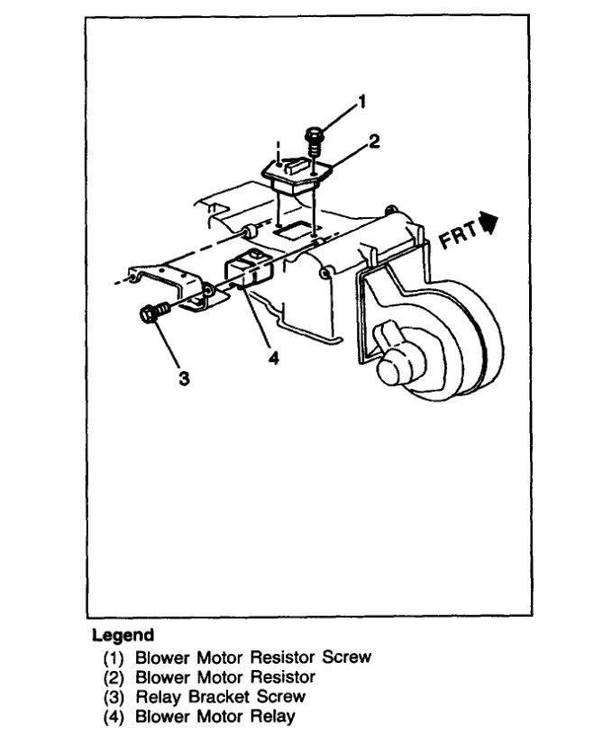

Good morning,

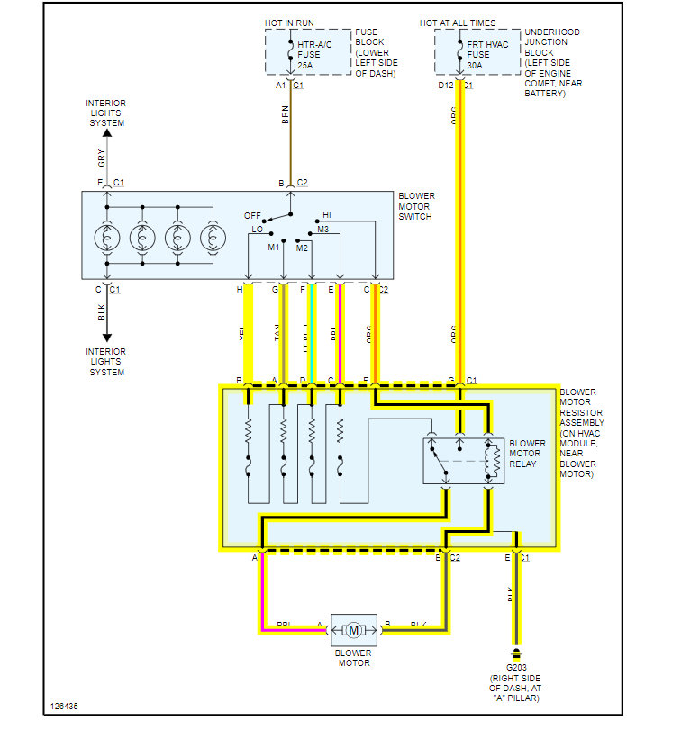

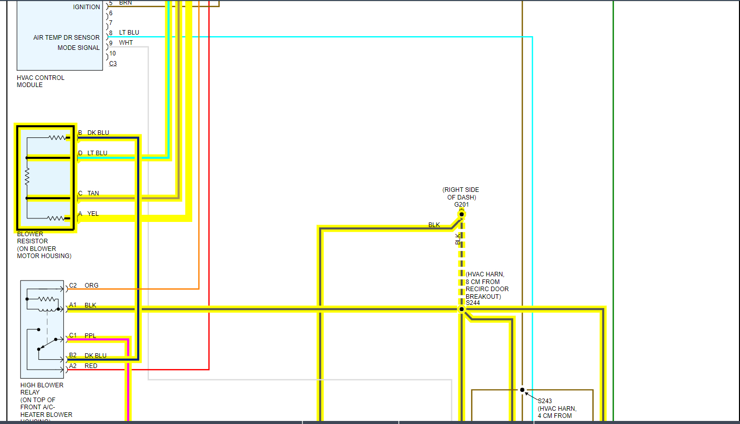

The blower resistor is the most common reason for this.

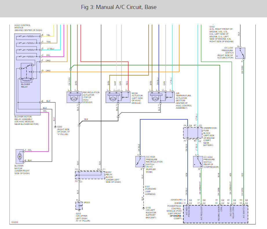

I attached the location and procedure for you to view of the repair.
I also attached a wiring diagram of the system for you to view. Verify power to the resistor.

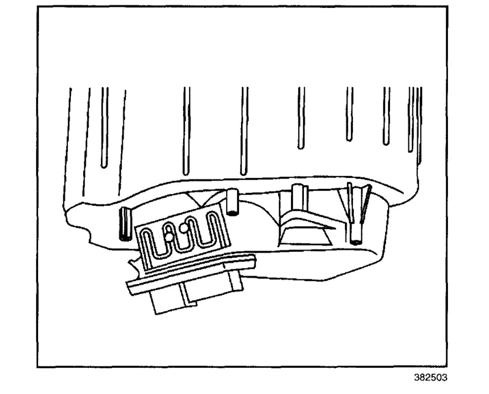

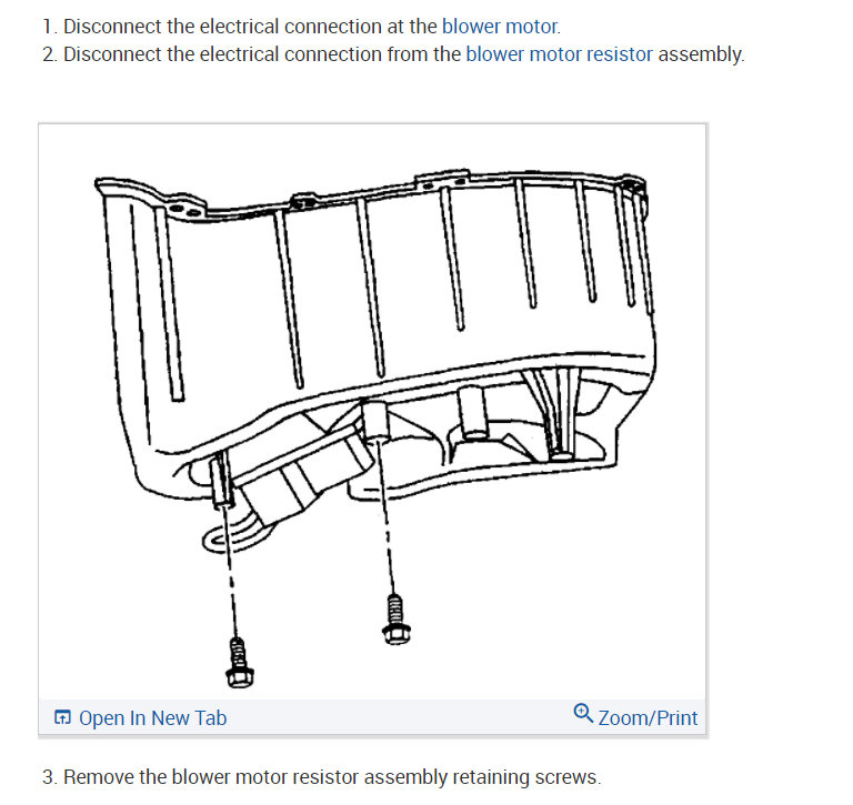

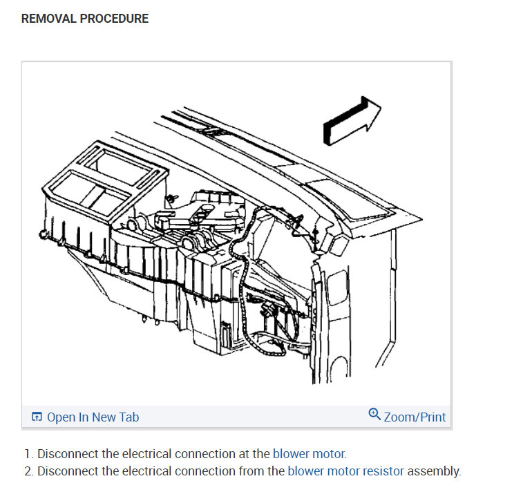

REMOVAL PROCEDURE
1. Disconnect the electrical connection at the blower motor.
2. Disconnect the electrical connection from the blower motor resistor.
3. Remove the blower motor resistor retaining screws.
4. Remove the blower motor resistor.

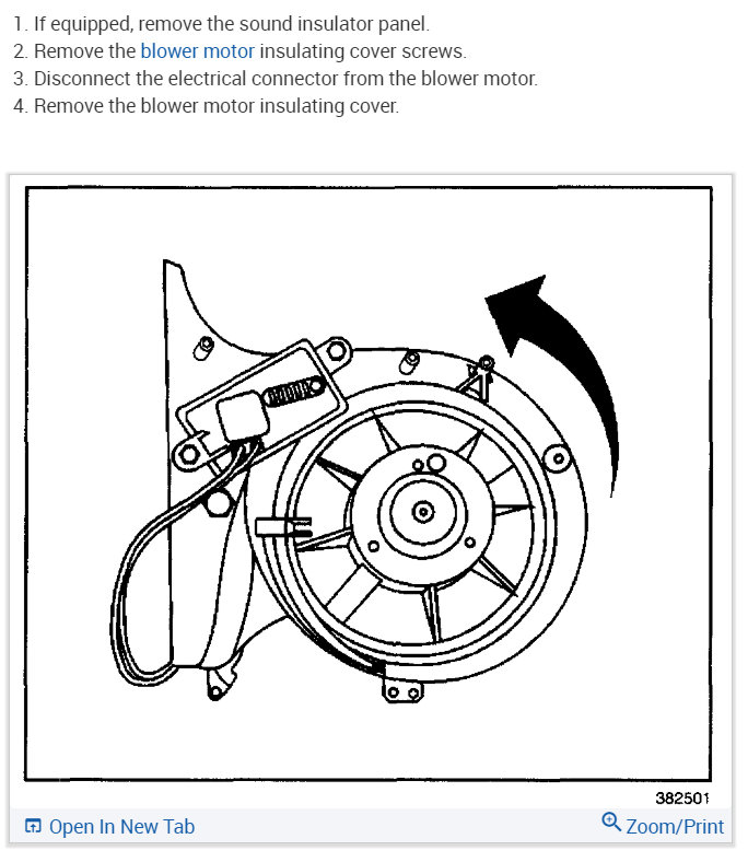

Fan motor started intermittently going on and off but only for a second but then stopped working all together. Checked 25amp fuse by drivers door=Good Larger block fuse under the hood, I did nothing with as I was told if it was bad nothing would have worked at all. Changed resistor on passenger side. Changed Relay on passenger side. Hooked wired from the battery. Changed the heater blower switch and fan blew on all four speeds for the first half of the day but then started working on just low and high and then stopped working all together? What is next?
Friday, April 30th, 2021 AT 2:24 PM (Merged)

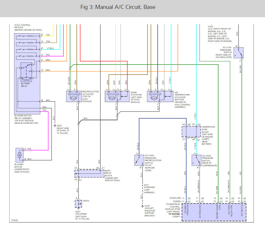

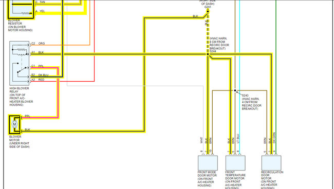

I attached a diagram of the system for you below. Check for voltage to the blower motor when it does not work to see if the blower motor is the issue.
https://www.2carpros.com/articles/low-or-no-air-flow-from-vents

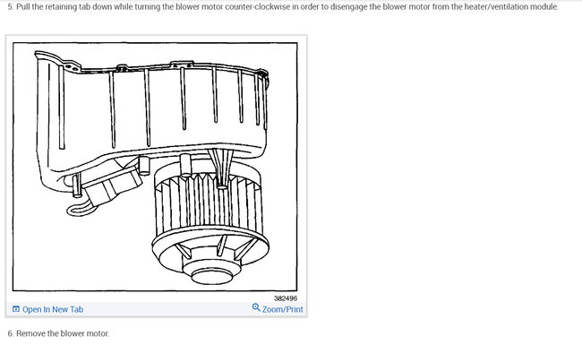

Here is a link to an article form this site that features written instructions, pictures and a video explaining how to check the blower yourself.
https://www.2carpros.com/articles/blower-fan-motor-works-on-high-speed-only
Friday, April 30th, 2021 AT 2:25 PM (Merged)

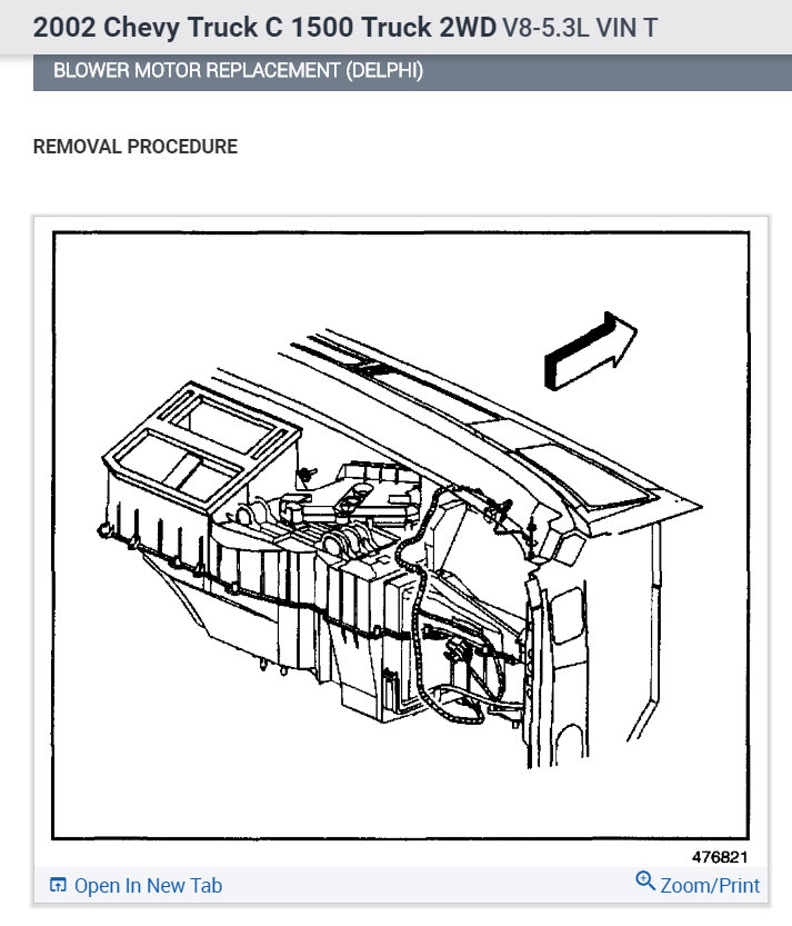

The heater would sound like it was blowing good but not much air came out. It was better in vent than on defrost. Now it won't blow air at all.
Friday, April 30th, 2021 AT 4:18 PM (Merged)
KEN L
  • MASTER CERTIFIED MECHANIC
  • 55,141 POSTS
It sounds like you have a blower motor that is out. but to confirm the issue lets use a test light to see if the blower motor is getting power. Here are two guides to help us see what's going on with the blower motor wiring diagrams so you can see how the system works:
and

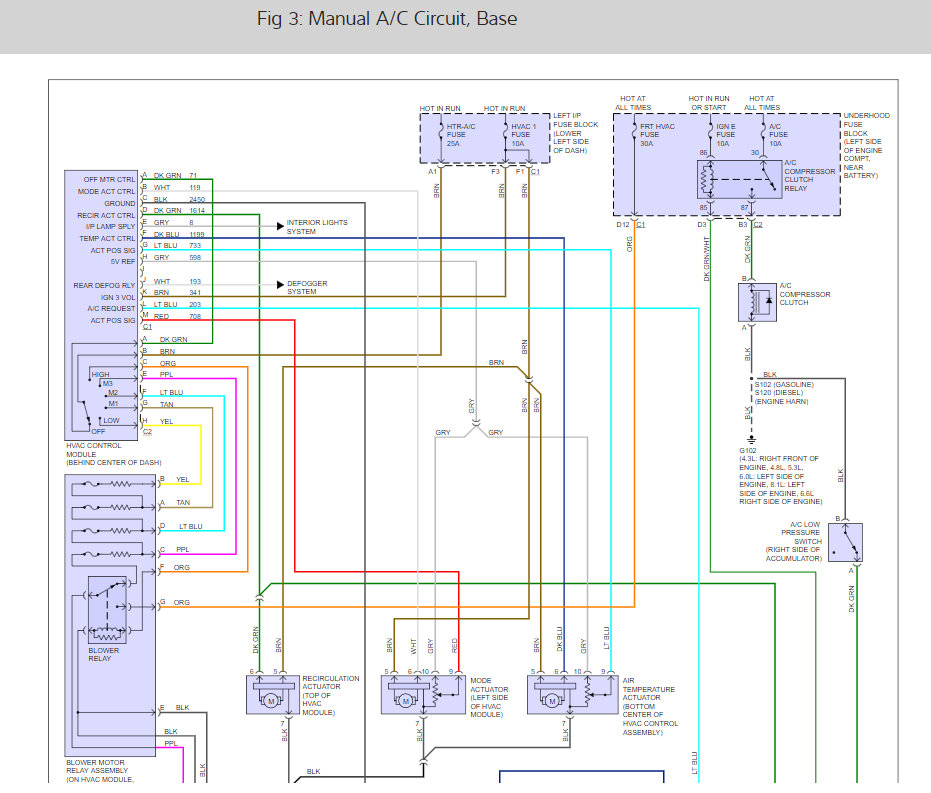

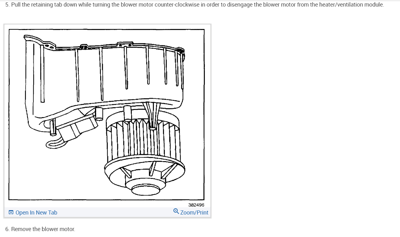

I have a part truck so I took it out of it to replace. It still didn’t work. I took my controls my relay an my blower to part truck an hooked it all up everything works fine. I rehooked everything back up in my truck still doesn’t work. I put a meter on it in my truck an I am getting power all the way to blower but it want kick on for whatever reason. Any ideas?
Tuesday, May 25th, 2021 AT 11:46 AM (Merged)
Good afternoon,
This sounds like the blower motor resistor that is the issue.
I attached the procedure for you of replacing the resistor.
