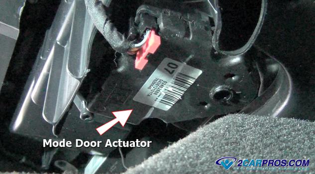

If you can hear the blower fan working but still feel nothing from the vents, or the vents are in the incorrect position this means the mode blend door actuator is not working correctly. This can sometimes be accompanied by a ticking noise which is telling you the gears inside the actuator have failed. The actuator can be found by flowing the noise, if no noise is heard the location is needed, again you can ask one of our experts for help.
mode door actuator

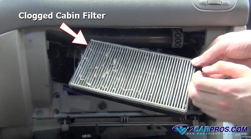

Some vehicles are equipped with a cabin air filter or Hepa filter which is designed to clean the air in the HVAC system prior to exiting the vents. When this filter clogs it hinders or stops the air flow supplied to the vents, to check the cabin filter's condition locate the HVAC housing which can be either beneath the dash or under the hood near the base of the windshield on the passenger side, remove the cabin air filter to inspect and replace as needed. To find out if your vehicle has one of these filters consult your owners manual or ask one of our experts to help.
clogged cabin filter
